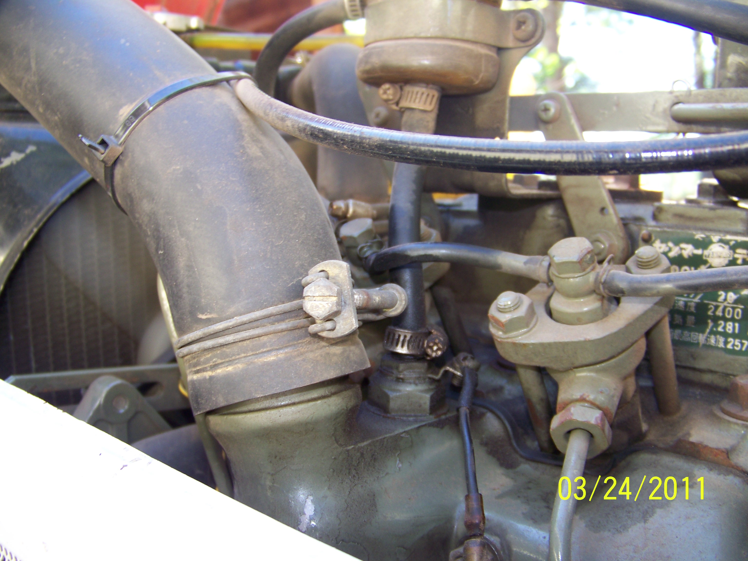

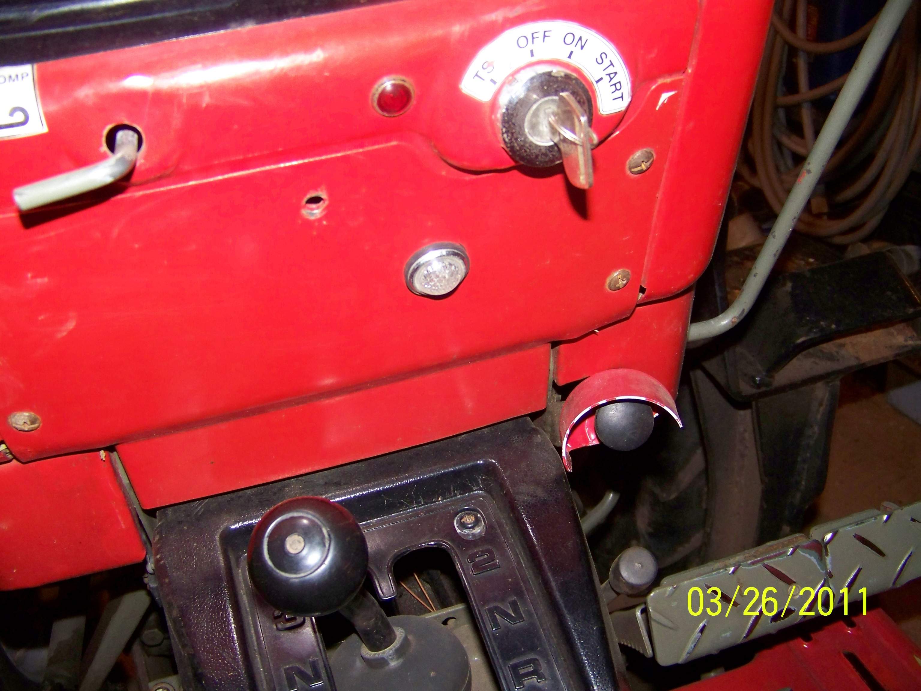

Storm probably has a better picture but here is one on my 2002. The ts on the ignition switch stands for thermal start. The red light to the left of the switch lights up when the thermo start is active. Yours may or may not have this.

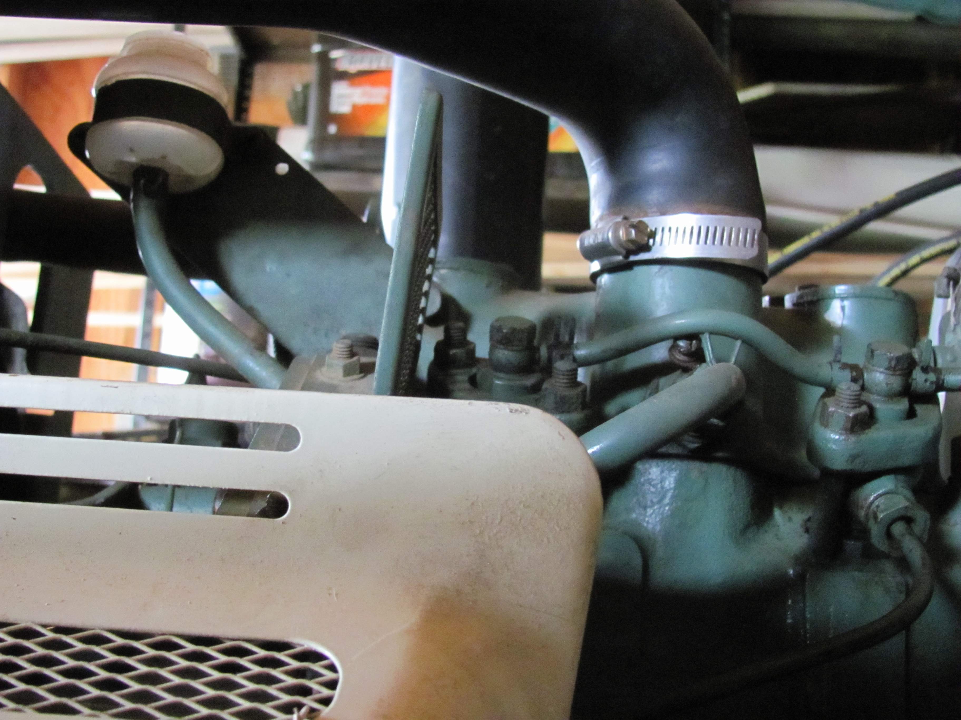

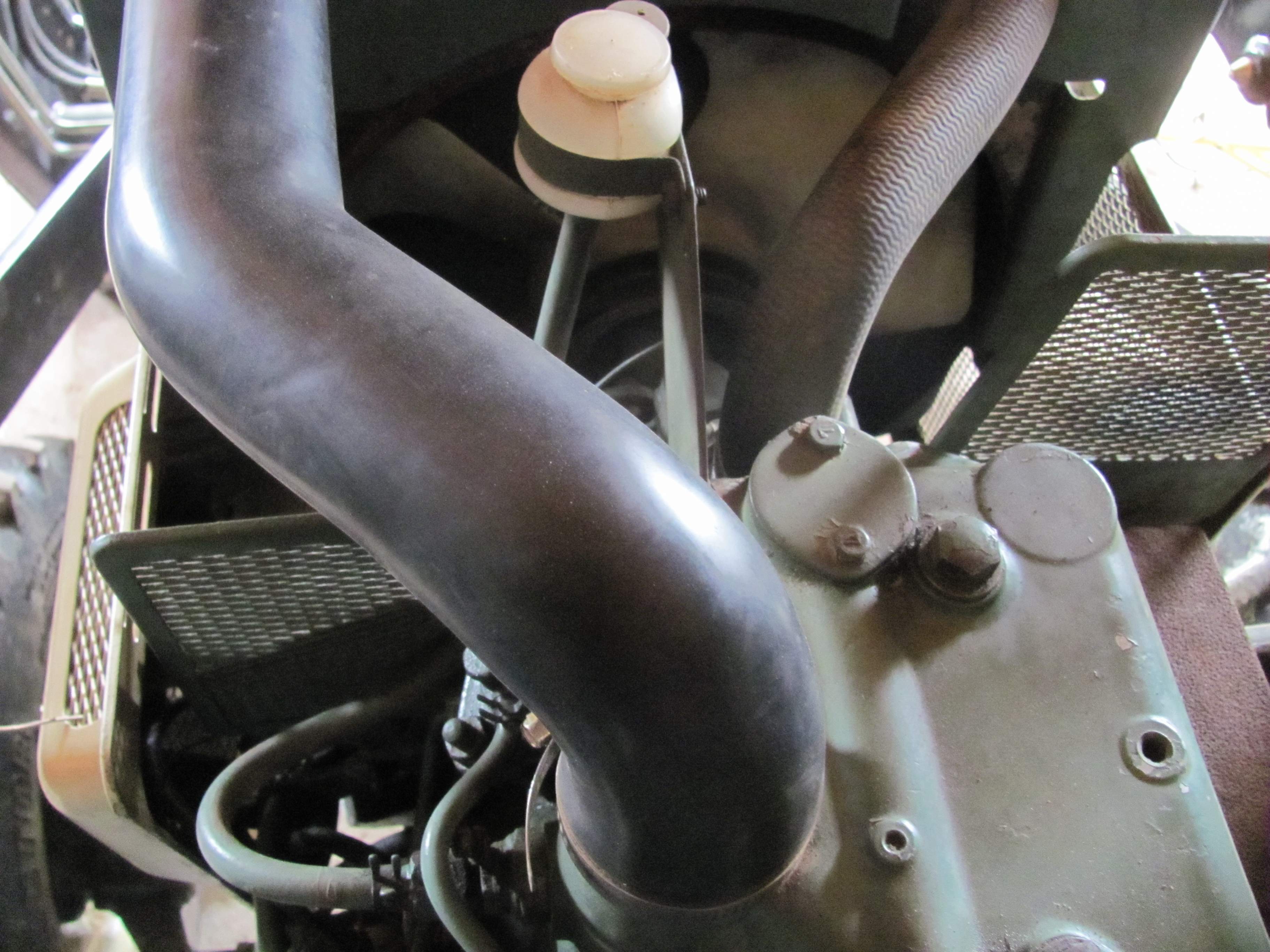

Storm -- if you could post a picture, that would be great.
This is my first diesal engine; do I need to consider a block heater for starting her up in the winter? It gets pretty chilly here in Ohio in January.
Here's how it looks on the 2210. Hope it helps.....

Yes, very helpful, thanks! BTW, I don't have one...
