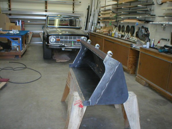

To Start, I hate a bent bucket. With that said, my 2816 has 18hrs and I have already managed to bend it. It was a rare incident,I was pushing up an old fence and wedged a wooden fence post just perfect enough to bow out my upper lip about 1 inch. My question is, do I need to reenforce my outter edges with some flat bar or angle iron. Or is the bucket strong enough, and I need to be more careful. Just wanted to hear some of your experiences.

In my opinion, yes they need reinforcement. That is if you are doing anything other than moving piled up loose material. I put 3/8" 2x2 angle on the top lip and 3/8" flat bar stock on the sides. Have not had any problems with the 3215 bucket or the 7520 bucket.

Excellent job on the bucket! I was thinking about reinforcing the top of my bucket similar to that to weld some hooks on.

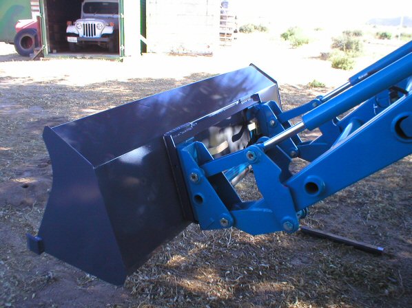

Nice!! I'm going to look into doing the same. Who made your toothbar. I called Markham and they said $350 including shipping. That sounds about right according to other prices I've seen.
Thanks for the pics.

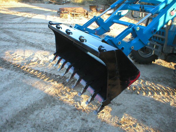

No toothbar, I welded on those teeth to the cutting edge. that is my 78" digging bucket. I also have an 84" materials bucket.
