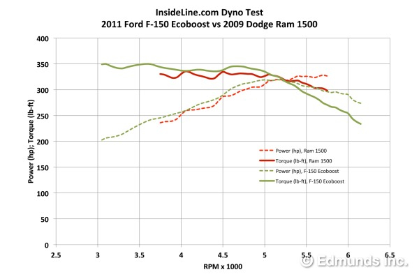

Yes Ford engineers designed the torque converter and computer to act this way on purpose to enhance performance. That is a bad thing?
Yes, it's a bad thing!
It's another computer controlled mechanical object subject to wear and made to slip EVERY time you accelerate since it needs those high rpms to spin the turbos and make power. You may think it locks early and stays locked but it doesn't. There's a reason why they had to put this type of live torque converter in the Ecoboost and not in the other trucks with the 5.0l or 6.2l. Because the Ecoboost doesn't make the low end power Ford wants you to think it does. Small displacement engines need large volumes of compressed air and fuel to make power, turbos need high pressure exhaust to create large volumes of compressed air, engines need high rpms to create that high pressure spinning the turbos enough to make the proper boost. It's just not possible to make that low end power without those turbos creating a decent amount of boost.
From your link
The second complication is its transmission's torque converter, which actively manipulates its lockup characteristics. When you whack the throttle to the floor when holding a fixed gear, it slips to let the revs soar so that the turbos can come on song.
It's more stuff to break that most don't need considering the minimal gains this whole package returns. Sure you get better fuel mileage empty, well if you buy a truck just to drive empty then the Ecoboost is a fine choice. If your towing/hauling on a regular basis like most truck buyers then that expensive drivetrain with more stuff to break gives little to no gains and less fuel mileage while towing.
Convienent how they compare a non-current 2009 model to the all new 2011 Ford. Either way, that dyno shows both engines nearly equal yet one is a 7 year old simple design that's been used for decades (traditional N/A pushrod V8, simple 5 speed auto, standard locking torque converter, etc...). Secondly they say
torque curve breadth is a specialty of turbo gas engines.
which is true AFTER the turbo has made boost which is not typical below 3000 rpms.
So what does all that extra technology and greater chance of catastrophic failure gain you? A couple extra mpg's empty but less mpg's towing and similar overall performance...
And since you love asking questions to try and prove a point, here's one for you.
If the Ecoboost is such a diesel like low rpm powerhouse, then why does it go to almost 6k rpms before shifting at WOT?
Any racer and builder will tell you to shift at peak torque for best acceleration. My truck shifts at 5,500 at WOT with an old 5 speed yet Ford engineers have to rev the Ecoboost to 6k, or is that just the torque converter slipping?
The 8 speed auto will make all that tech an even harder sell.

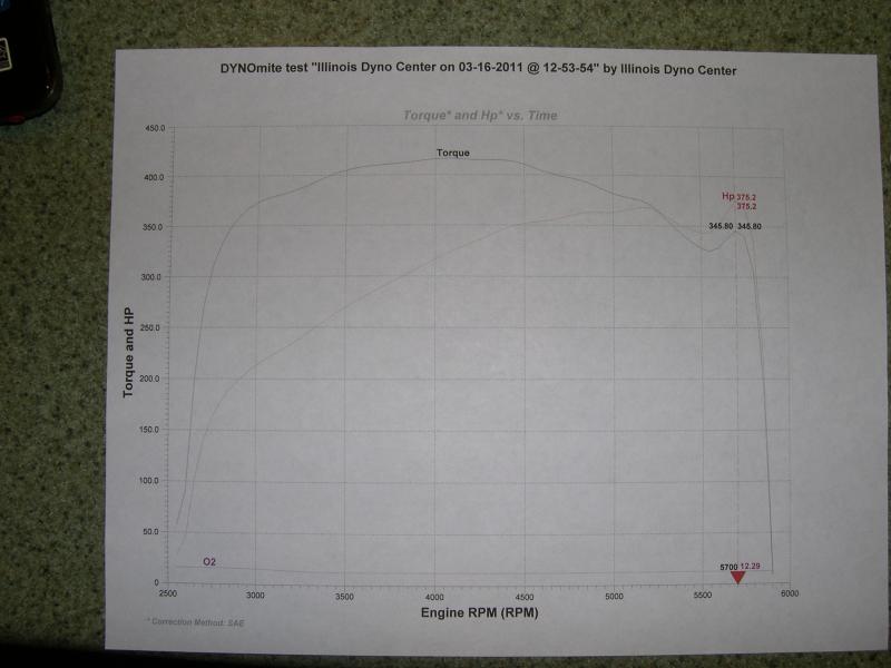

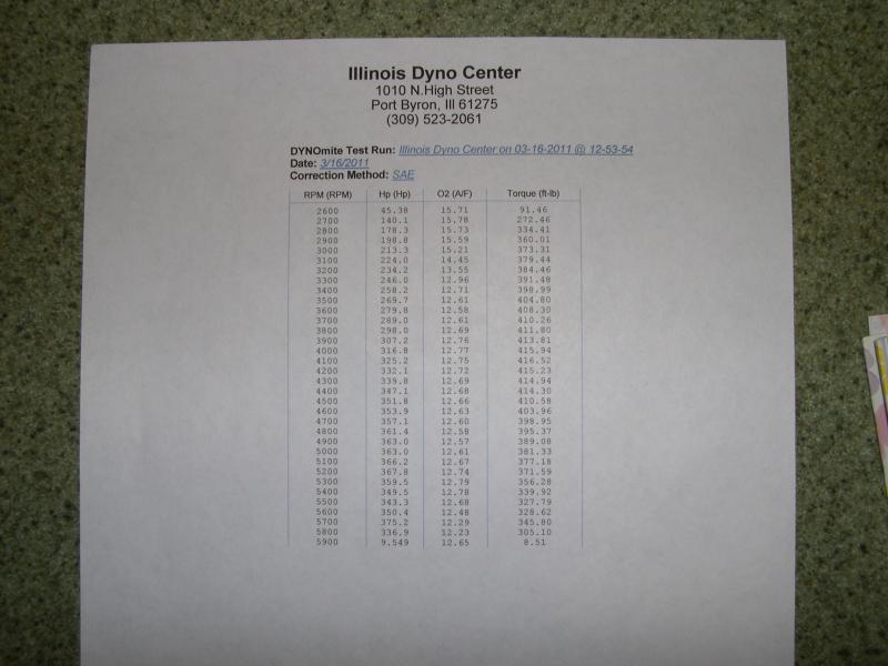

If we are going to through some dyno sheets around, here are some from my Challenger. 5.7 hemi, auto, not stock. It has exhaust, a CAI, and a tuner. This is probably about 10% higher than stock. Notice the torque curve, its pretty strong around 3500 to 4000 rpm, not a screaming 5200 rpms. One problem with these curves, my car is an auto and the pulls were all done in 4th gear (a 5 speed auto). You can't really do a pull and get the lower rpm's, the car will just down shift. So the lower RPM numbers don't mean anything as that was the point he was rolling into the throttle slowly to keep it from down shifting.
The hemi in the truck is different than in the cars, it has a better intake, and these numbers for a truck would probably be as good or better.

Sorry guys but I cannot allow someone to state false information without having to correct it. It is ok for someone to have an opinion but not to make false claims to which they have no experience.
It is a desirable design characteristic that is engineered to improve performance for the rare occasion of someone going from idle to WOT. I am willing to bet that this drivetrain spends more time with the torque converter locked than most, if not all, gas engine powertrains offered today. You think Ford made up the low end power claim? That is rediculous! What is your personal experience that has brought you to this conclusion? Real world experiences have backed up the claim. Again, have you towed with this engine yet?
Most HALF ton truck buyers are what I would call weekend warriors who tow maybe 10% of the miles they drive. During this 10%, the low end torque is a pleasure. During the 90%, the low end torque is still and pleasure and much better fuel efficiency and initial cost than the 6.2 liter it is a substitute for.
Convienent how they compare a non-current 2009 model to the all new 2011 Ford. Either way, that dyno shows both engines nearly equal yet one is a 7 year old simple design that's been used for decades (traditional N/A pushrod V8, simple 5 speed auto, standard locking torque converter, etc...). Secondly they say which is true AFTER the turbo has made boost which is not typical below 3000 rpms.
How is the 2009 model different from the 2011 Ram? They both require 89 octane fuel and have the same HP and Torque values. You were the one who wanted to compare your 2003 Ram to my 2011 ecoboost in some towing challenge. Remember the quote for the article "Ram's downshift-happy transmission means no data below ~3700 rpm, there's little chance it can touch the Ecoboost at revs below this point -- torque curve breadth is a specialty of turbo gas engines".
Below 3700 rpm is where all of the advantages of the ecoboost shine. I will repost the published torque curves again for you.
Do you really believe your 2003 will out perform the ecoboost? Your truck is stock is it not? If so, what form of brainwash have you subscribed to?
Post that dyno sheet all you want, all it proves is the Ecoboost can match V8 power OVER 3,000 RPMs. It DOES NOT PROVE ANYTHING UNDER 3,000! Again, I have yet to see any real proof of low end power from this engine because I know it's not there. Small displacement turbocharged engines just don't do it. They can not possibly make that power without boost which does not come on that early.
Funny how you found a different dyno that shows stock ENGINE numbers and not Rear Wheel HP. Try using the real one you posted earlier which shows nothing under 3k rpms for either and shows them nearly equal.
