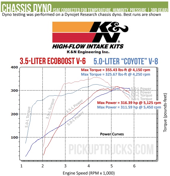

Look at the original dyno produced by pickuptrucks.com that shows the 5.0l making that low end power much sooner. Obviously this proved Ford's marketing scam and Ford jumped in quickly to do it again but while making changes to the dyno and truck to make it "look" better.
What We're Testing This Week: 2011 Ford F-150 EcoBoost 3.5-liter V-6 - PickupTrucks.com News
6a00d83451b3c669e2014e605f01cf970c-800wi
Throughout the tests, the 5.0 demonstrated a healthy torque curve that looks broader and less peaky than the EcoBoost, though at a lower level of power. It also shows off the engine's ability to steadily wind up power all the way up to redline.
Look at the Torque curve of the 5.0l, now make that a 5.7l and that whole line would jump by 50+ hp and tq above that Ecoboost torque curve.

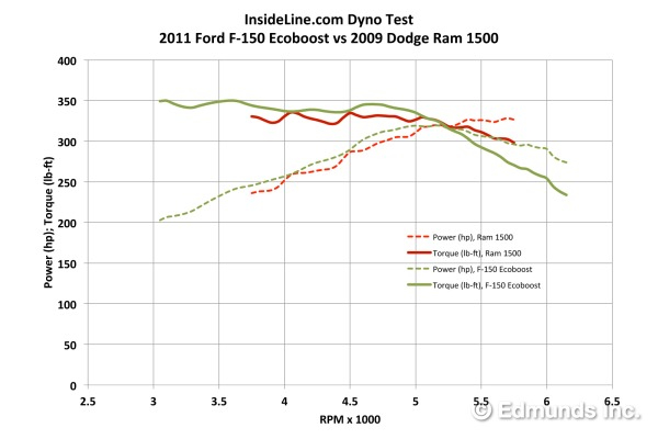

This is a much better dyno showing the real output of the Ecoboost without as much drivetrain interference.
There are two interesting items to note about our EcoBoost's dyno results. First, peak torque occured further up the power band (4,150 rpm) than what Ford claims at the crankshaft (2,500 rpm).

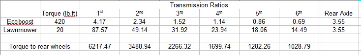

Once again, it's all about gearing. Assuming you don't know how to calculate Torque to the wheels of an auto, we'll stick to a simple formula not adjusting for transmission or parasitic loses. So Engine Torque x Trans Gear Ratio x Rear Axle Ratio = Wheel Torque (add in RPM's and you have BHP).
So using that formula, I have calculated the rear wheel torque of your Ecoboost using the given gear ratios and rear axle ratio. I have also calculated what gearing would be needed to return the same wheel torque from my 20lb.ft lawnmower. It can be done! It won't be fast (high rpms, low HP) but with that ridiculously low gearing, both engines would produce the same Torque at the wheels.
Still not getting it?
