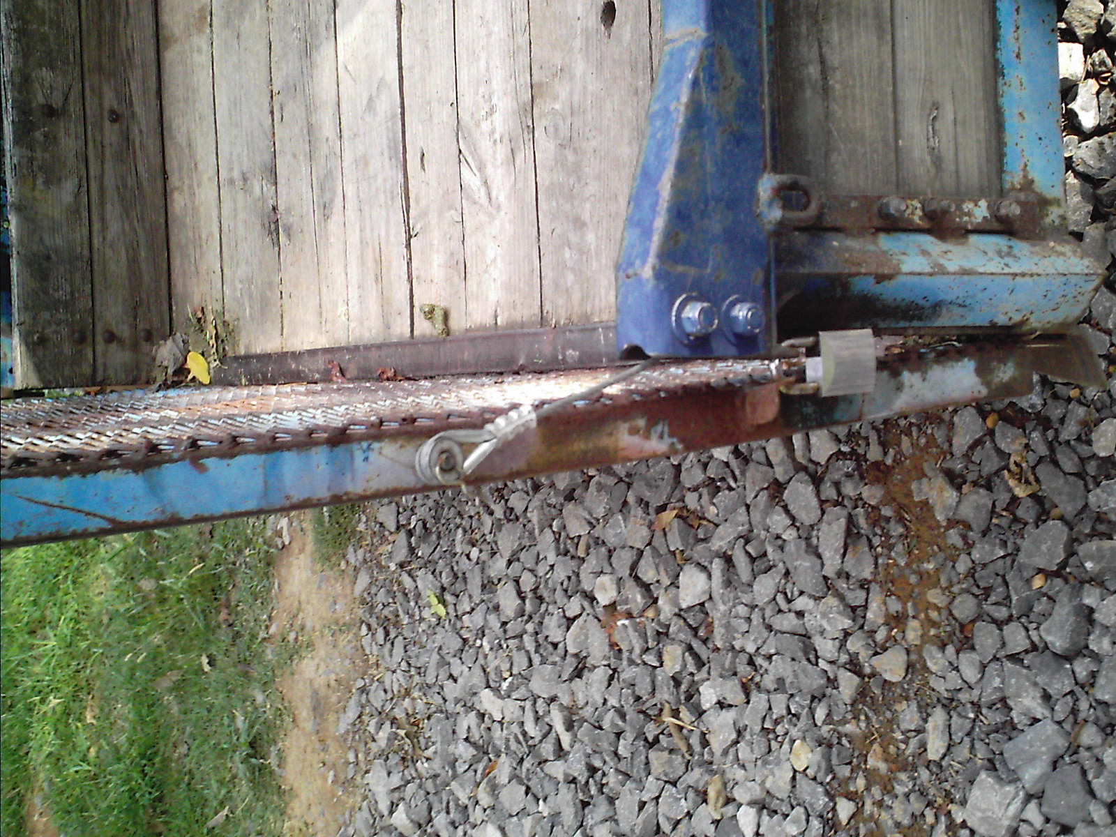

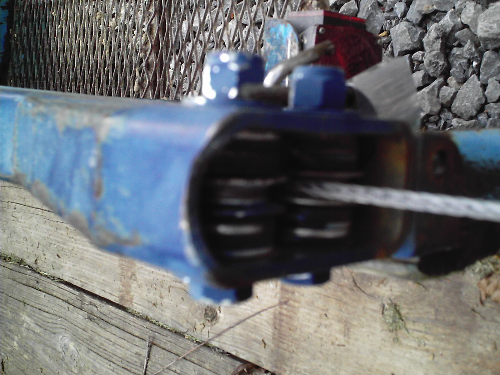

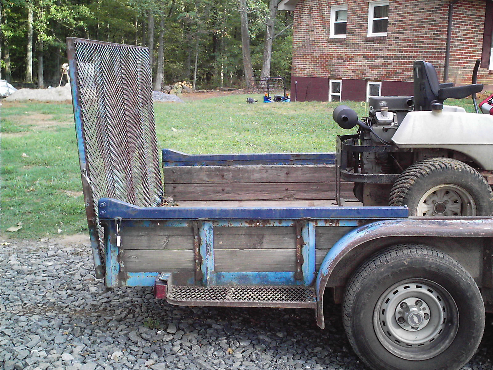

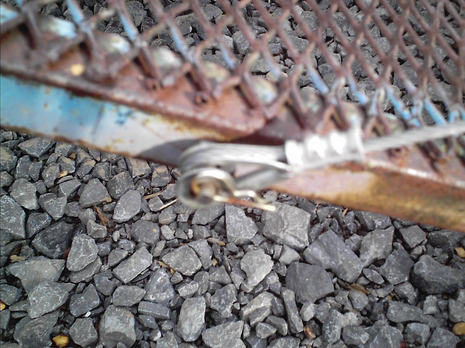

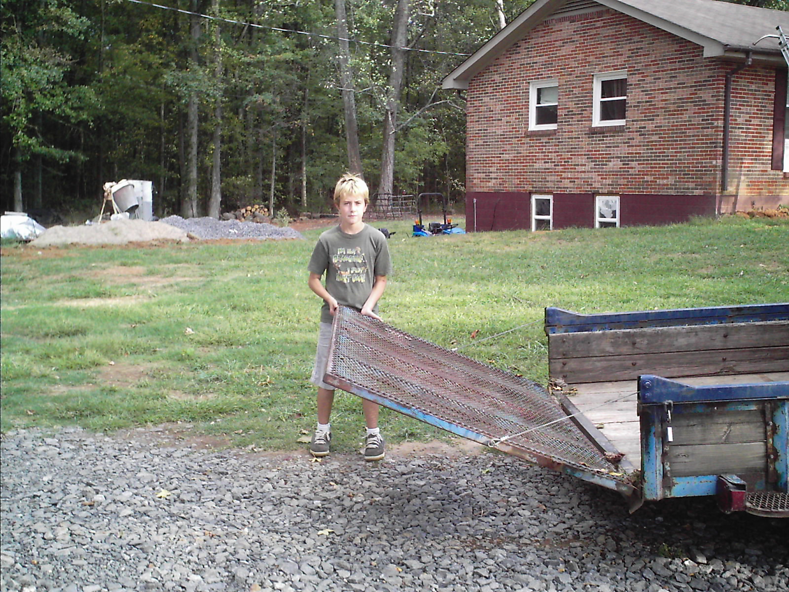

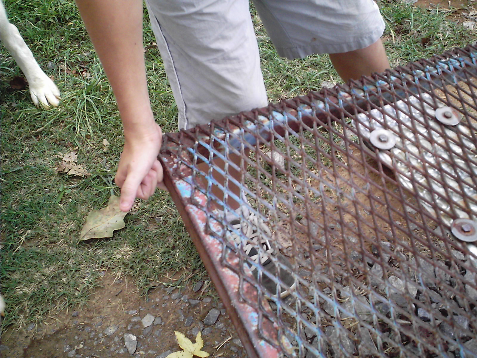

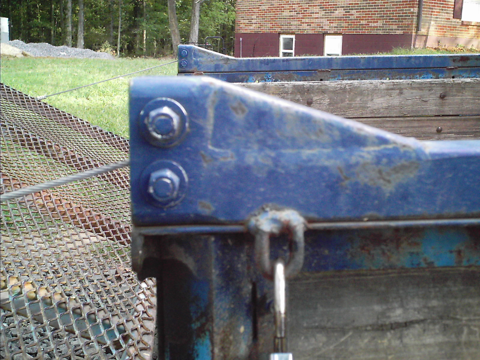

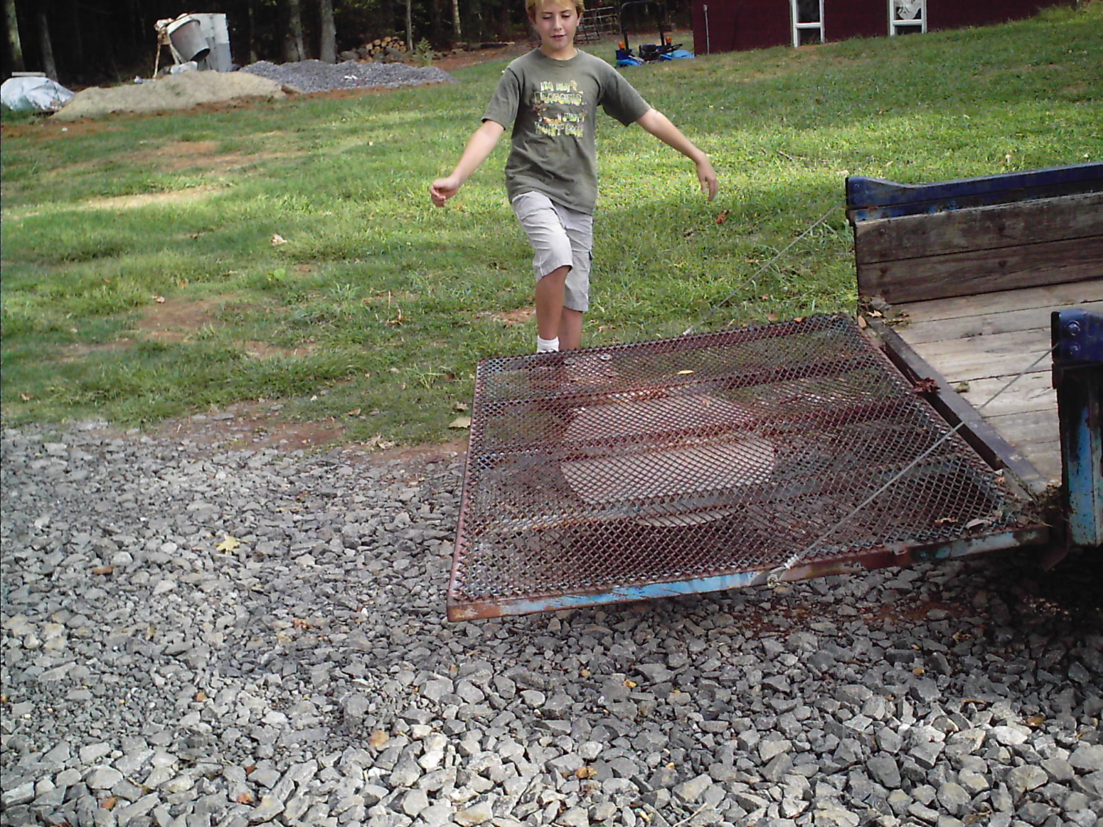

I think that is what makes threads like this great. Other peoples ideas that I can blatantly steal :D
One of the ones on lawnsite or lawncafe had a pivot point that stuck up in the air, that changed the leverages (gave it more) You may need to do something like that with a flat deck trailer.
Here are mine.
Pics are of my 11 year old son, he is holding the gate with his pinky, and lifting with his toe.
Could you do it with a gate opener like a "mule"? Same motion, just sideways
