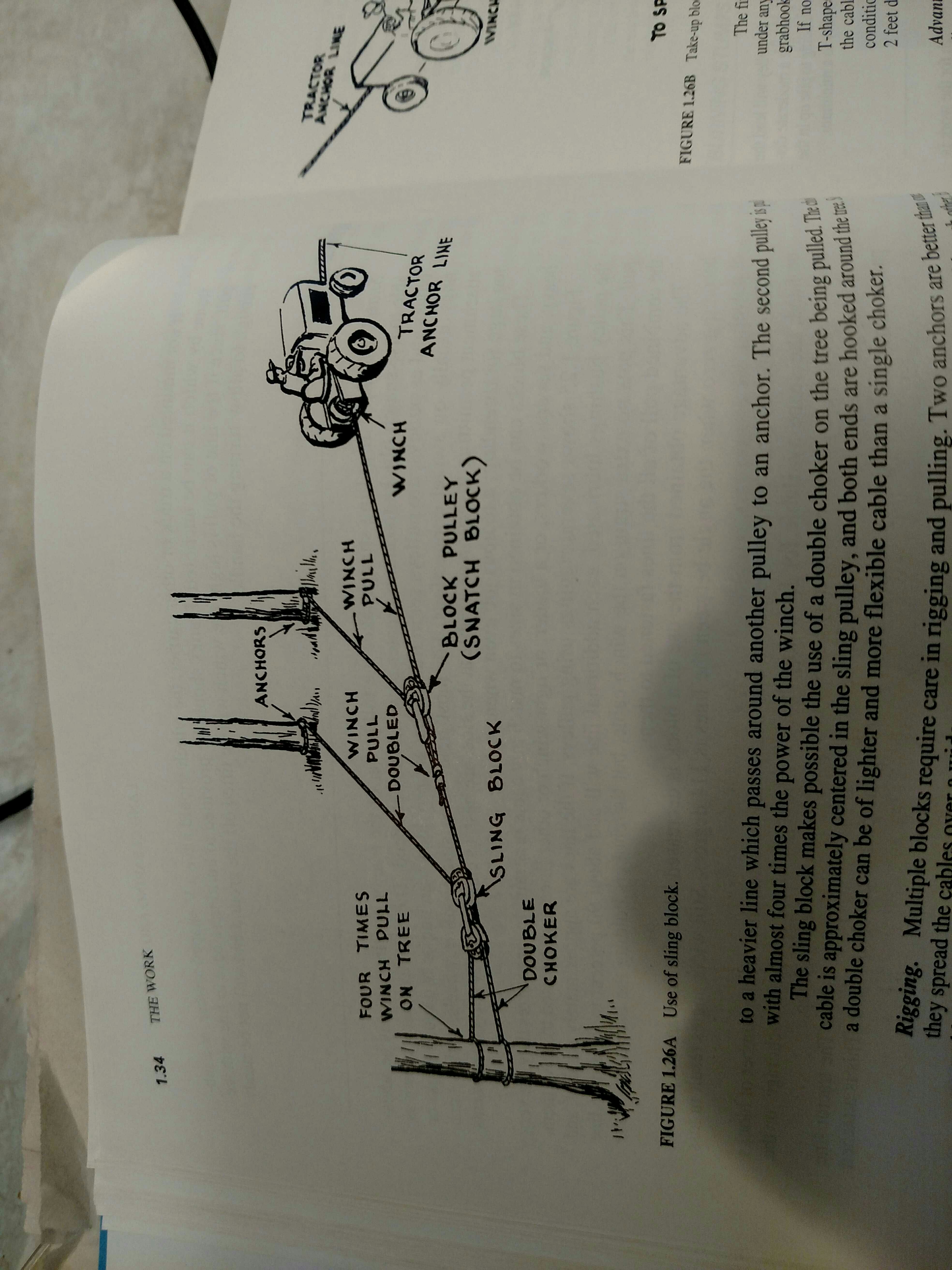

Hopefully Howtoclearland.com is still on the internet.
The winch is a viable option. Please look at "Moving the Earth" the workbook of excavation by Herbert Nichols Jr
There is an entire chapter on stumps. Also everything you need to know about road building (your eventual goal). View attachment 1518870477608.jpeg

There is an entire chapter on stumps. Also everything you need to know about road building (your eventual goal). View attachment 540342
You better be careful with that anchor line unless you run the chain under the tractor and hook directly to the winch. Otherwise you might end up with a 1/2 tractor.

There is an entire section devoted to safe use of a winch. The logging winch anchor itself with the rear blade making the anchor line unnecessary.
It sure is.
Just downloaded the pdf.
Thanks for mentioning it.
