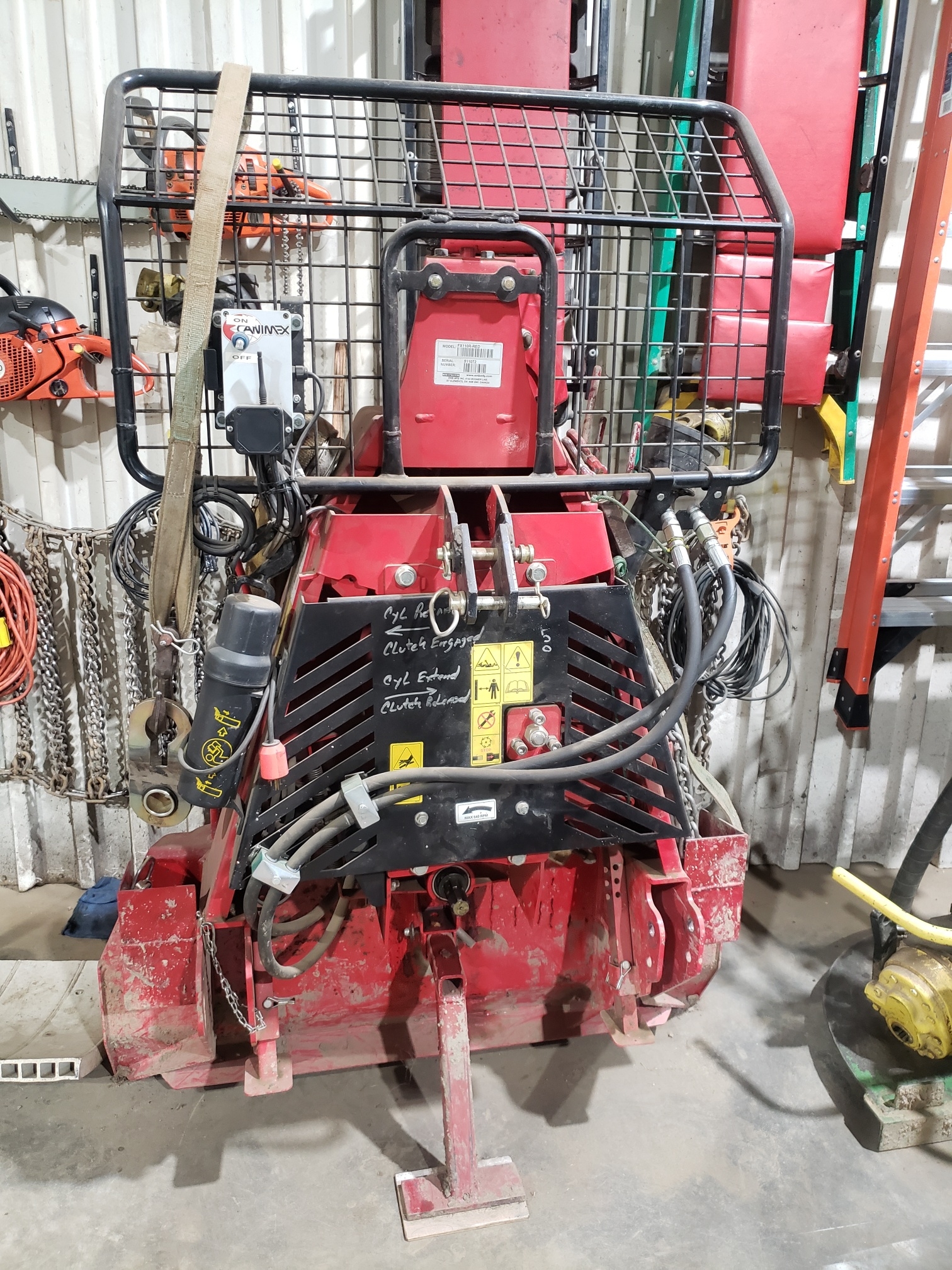

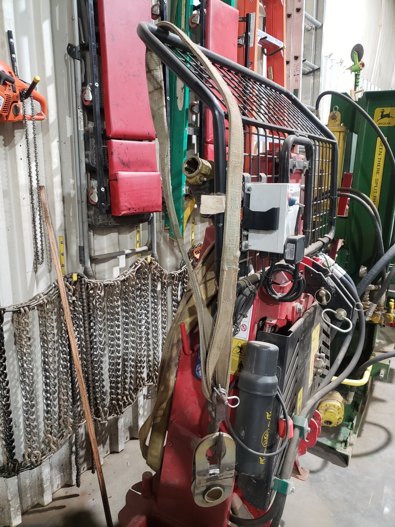

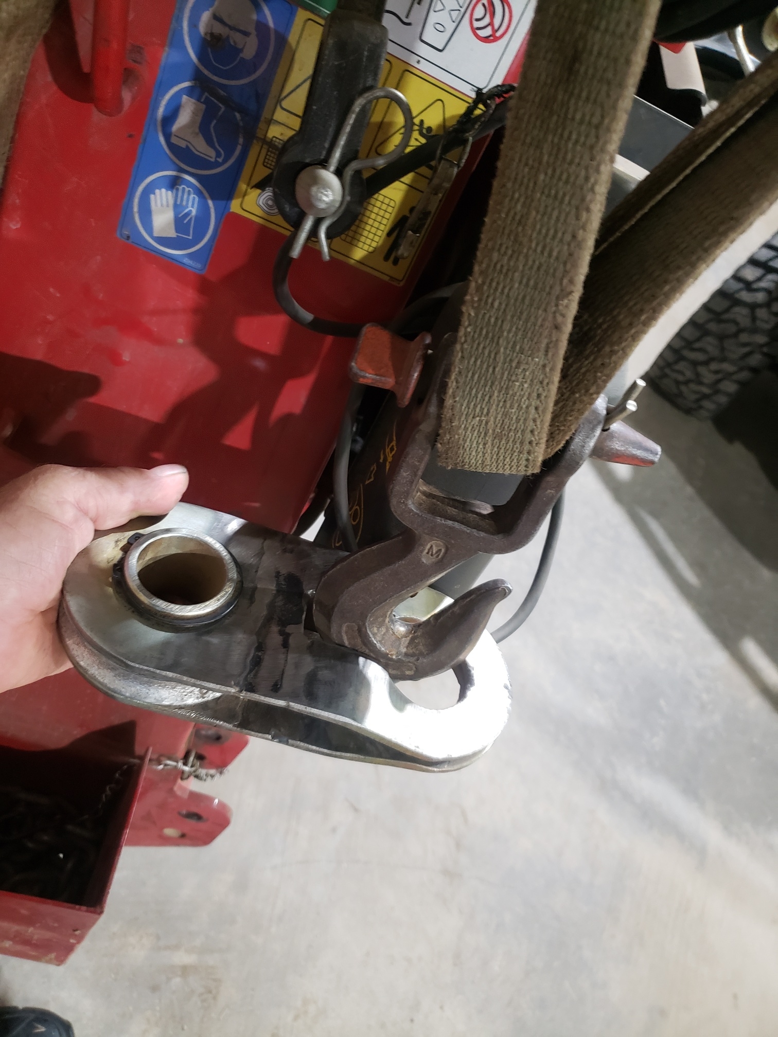

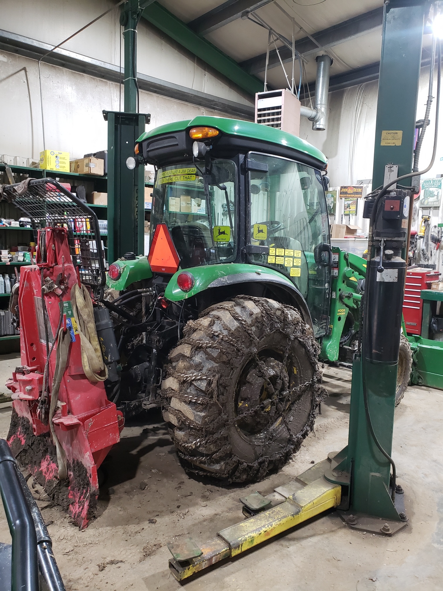

I have almost the same setup. I have the Wallenstein FX110 with remote and a John Deere compact 4320 with cab. I know I have some pictures. The cab caused a problem mounting the winch. I had to modify the top link on the winch and the cut down the safety screen so I wouldn't break the back window and hit the roof of the cab. The remote caused problems at first because of debris in the control valve. Its a work safer though. My model had a 2 button remote which I converted to a single button. The way I understand it now the new ones are a larger single button remote. I bough one self releasing snatch block but I don't use it any more. For what ever reason it pinched the cable real bad once. I use the cheap Harbor Freight snatch blocks now. I have modified them to use a draw bar grab hook. Another thing I don't choke around the tree with the nylon strap. I use a basket hitch with the draw bar grab hooks. I have pulled really hard at times and the choker around the tree has taken the bark off all the way around the tree. I have 2 of the HF snatch blocks modified and another to modify. For me 3 snatch blocks will work perfectly. I bought the winch because my hip was starting to bother me from getting on and off the tractor when skidding the logs with the draw bar. You know how that is. Hook up to short, hook up to long etc. Only problem now is that my hip bothers me all the time. I have the loaded tires, wheel weights and chains when I am working in the woods. I modified the kick stand to a single from the doubles and I leave it on all the time. There are a couple of pictures of the snatch block modifications.

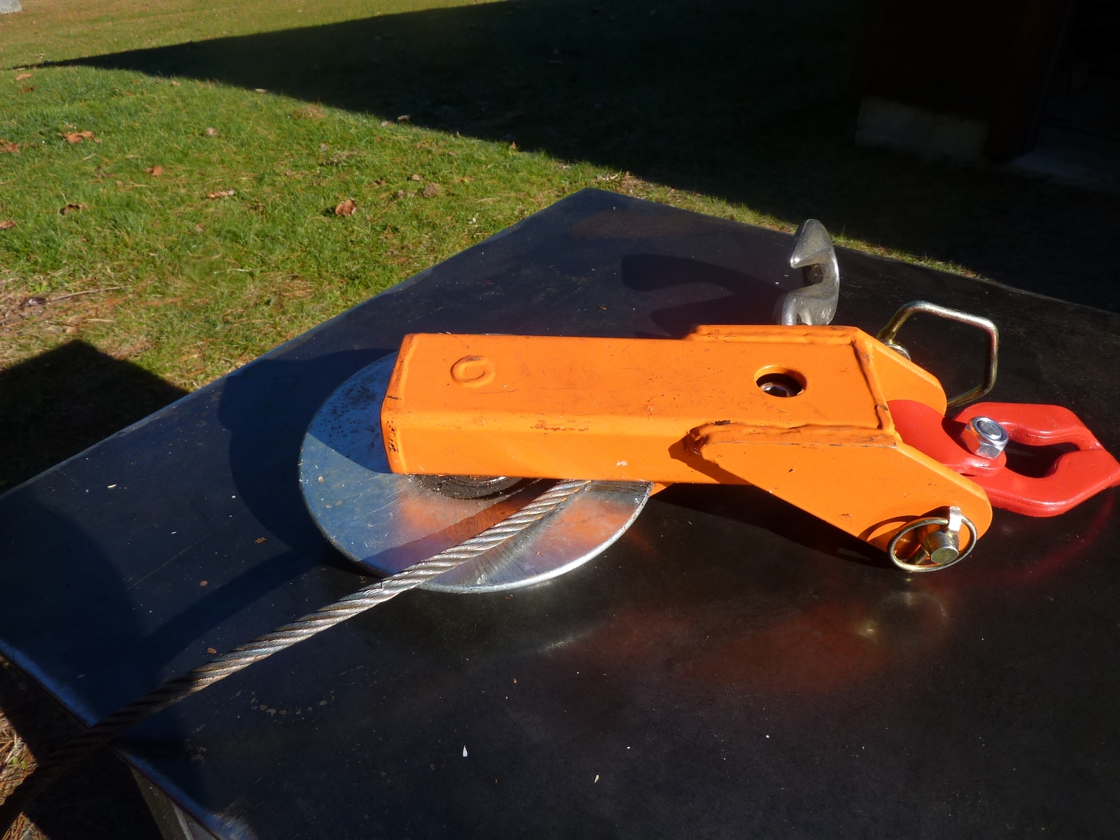

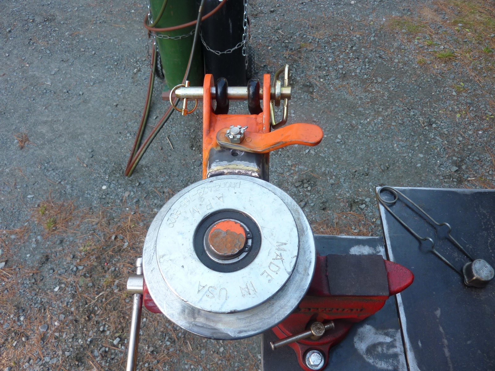

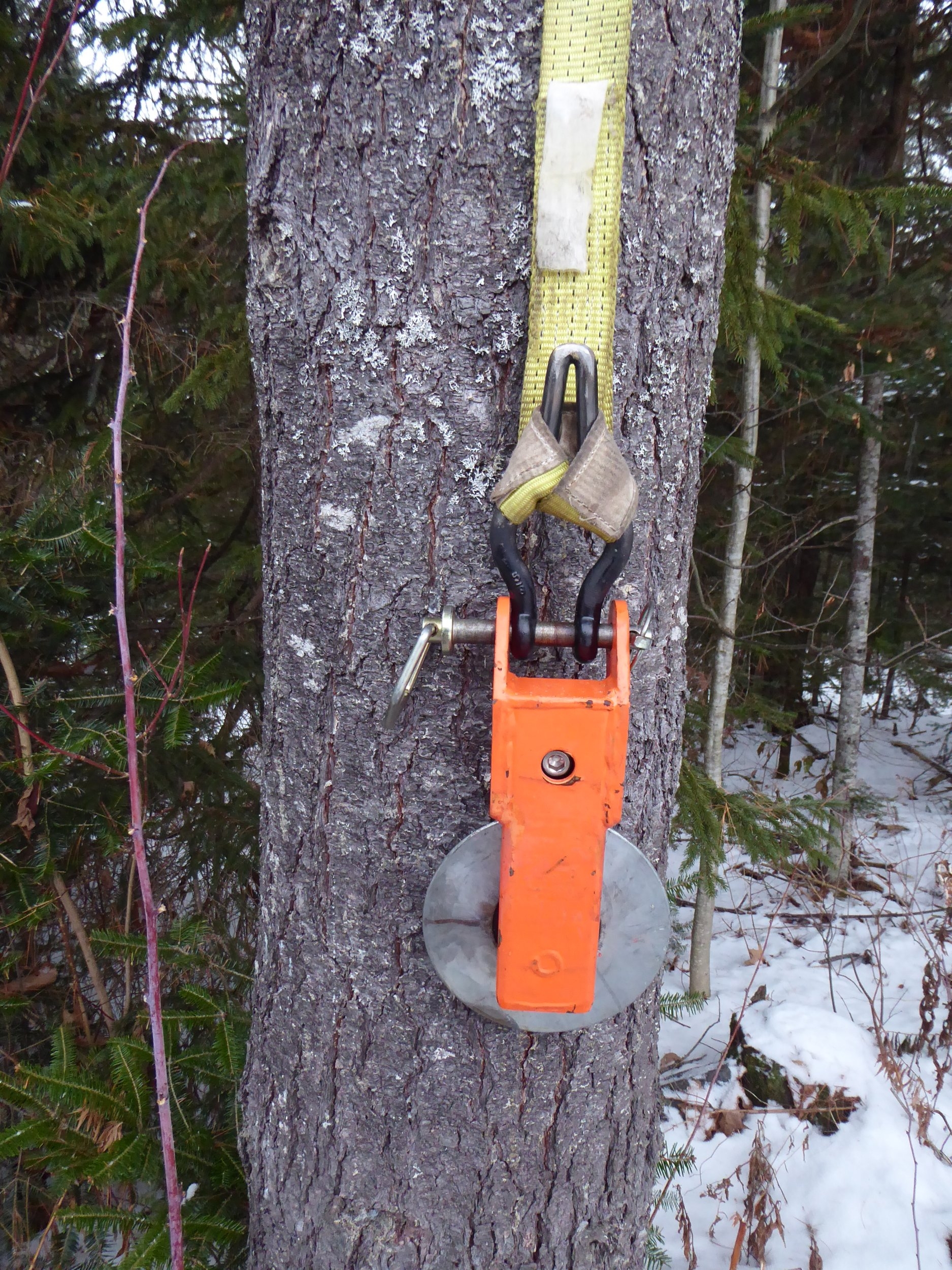

A couple mods I made on my self-release snatch block. If you are using 3/8" cable or smaller it can easily jam under the sheave like this
which causes a bad kink as oldtimer mentioned.
I brazed a section of rod on the frame to prevent this

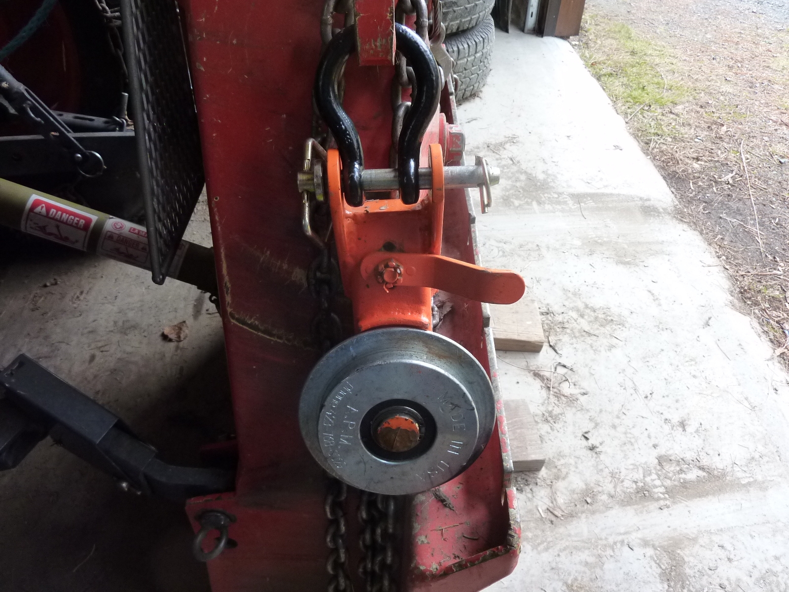

I didn't like the permanently attached sling so I made this from a shackle.
That way I can set the strap on the tree w/o dealing with the 13 lb snatch block hanging on it. Once the strap is set it is quick and easy to connect the block.

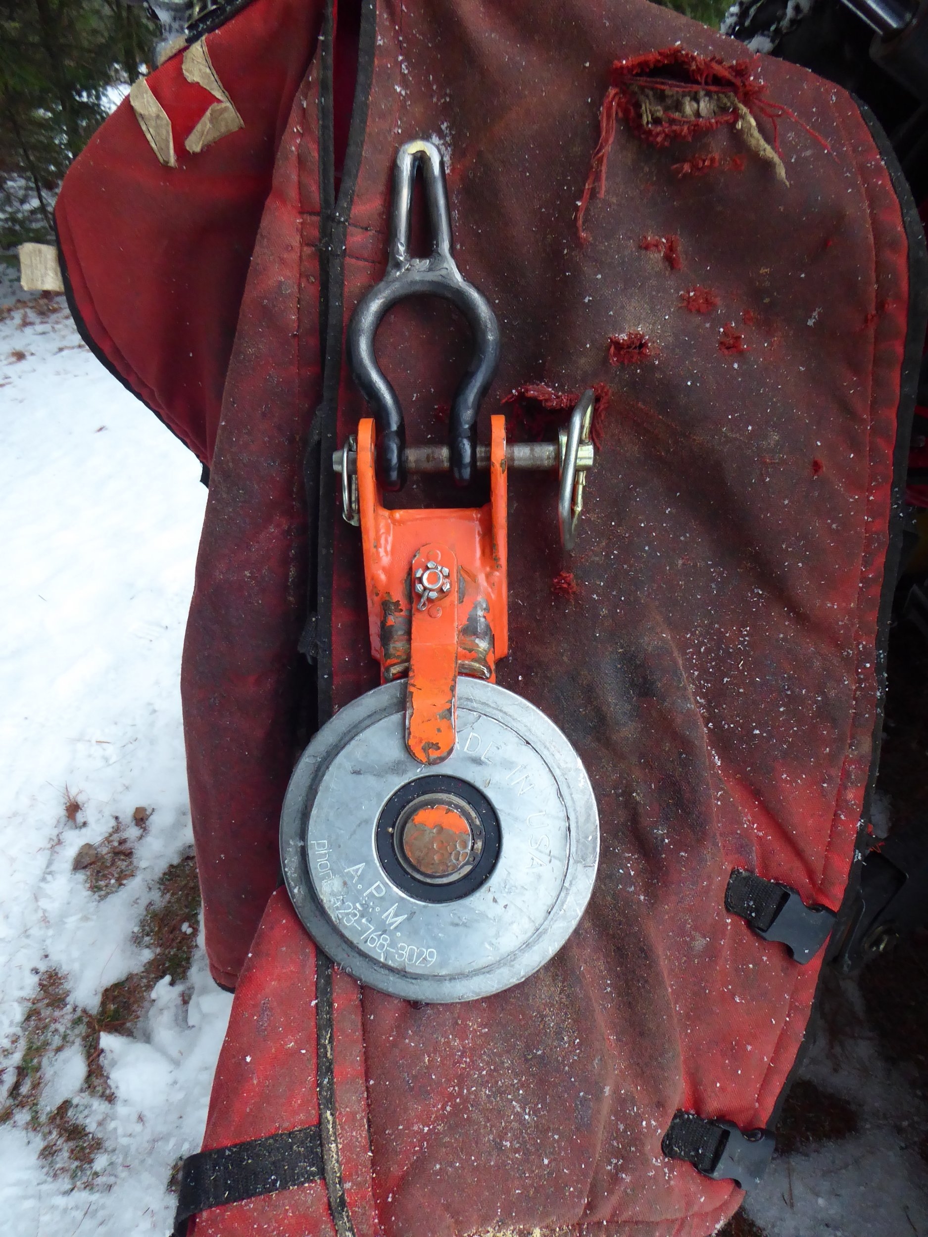

Be careful to set the strap/block so it splits the angle the cable will make. That way the strap will not spin around the tree when pressure is applied and bark the tree.
gg

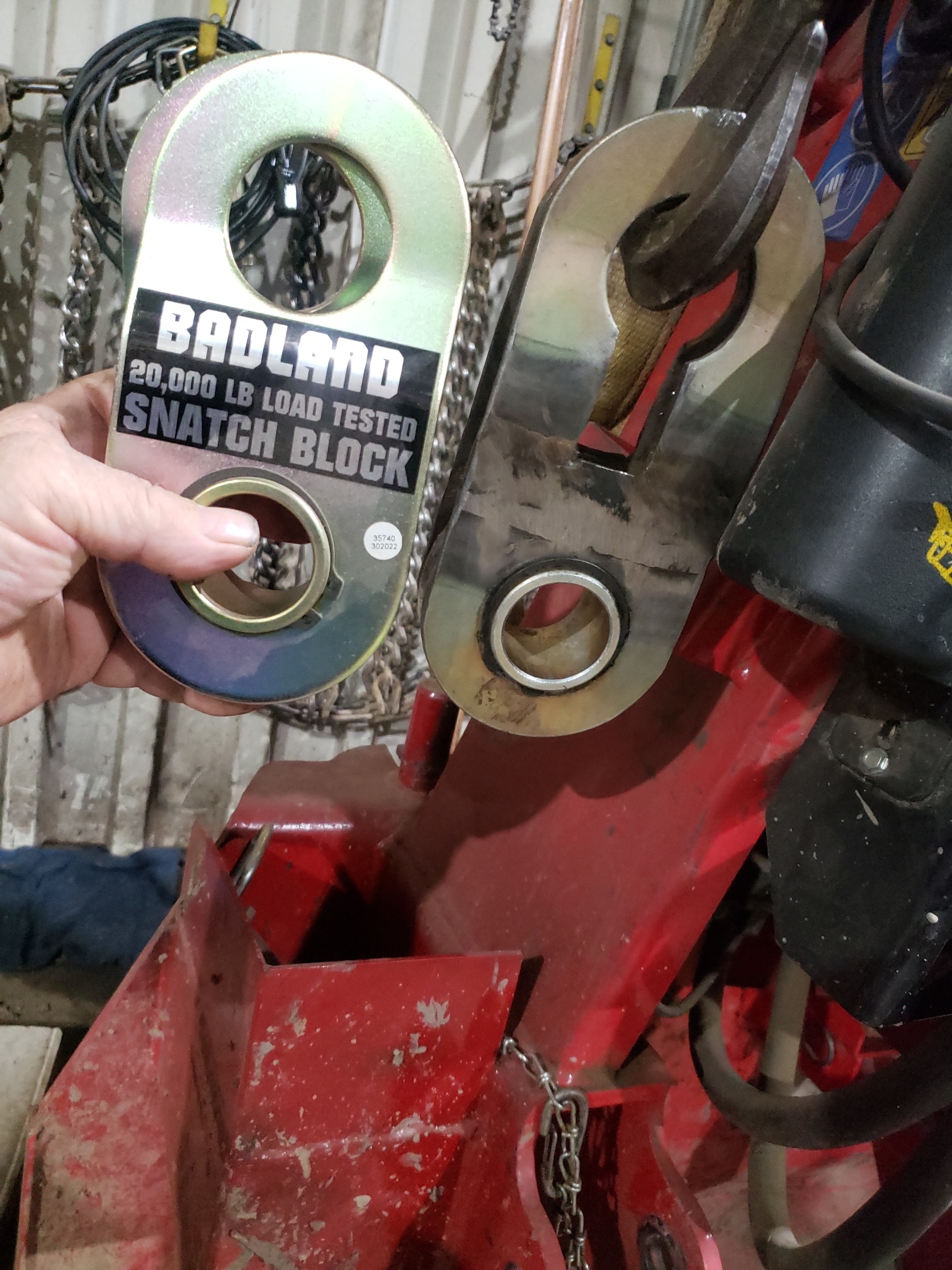

Gordon posted those snatch block mods before I bought my winch. They were part of a whole thread or sub-thread about snatch block problems. I took those problems into account when selecting a snatch block for my winch. I ended up with an Igland block which has performed well for me without jamming the cable.
my only issue is that I got straps with reinforced eyes, and that makes the strap's eye stiff so it sometimes slips off the pointy end of the block that's supposed to retain it after you put it through the hole. I need to either weld an extension on or cut off the reinforcing material. The self-releasing feature is really useful. Rigging the strap so it does not rotate about the tree prevents it from damaging the bark.

On the remote , when I bought my winch in 2015 the list was $6500 and the dealer gave it to me for $6000. I looked now and the unit is $9000 plus for the remote model. Talk about inflation. Below is one of the reasons I bought the remote plus I am working back at the tree/ stump and if there is a problem I can correct it right there without making the long walk thru brush etc.
I have probably mentioned this before, but the majority of my woods is on sidehill plus I have the cab tractor. When I can't make it up the hill I work the winch from inside the cab. I leave the log or logs unlocked drive a 100 some feet, stop and winch the logs up to the tractor, leave the logs again and drive up the hill some more, stop and winch the logs to the tractor and do this several times until I am on better ground.
On the hydraulic connection there is a single acting cylinder/ spring return/ inside the enclosure that engages the winch/ replaces the red rope? You need a set of hydraulic remotes/ open center/ and a 12 volt connection to work the 12v single acting control valve thru the hand held remote. I still have the green rope to lock the winch/ drum. Wallenstein describes this very well on the website.
