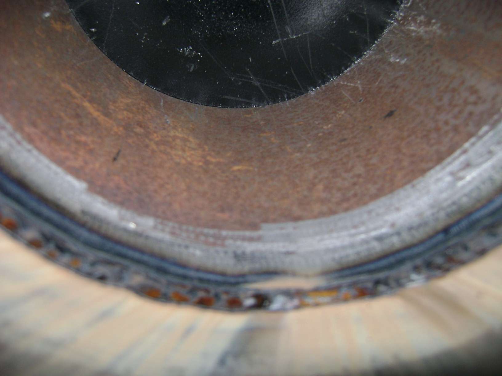

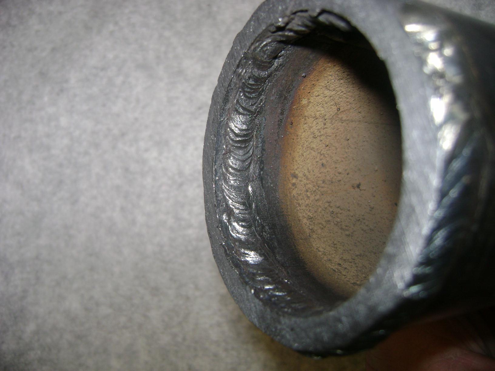

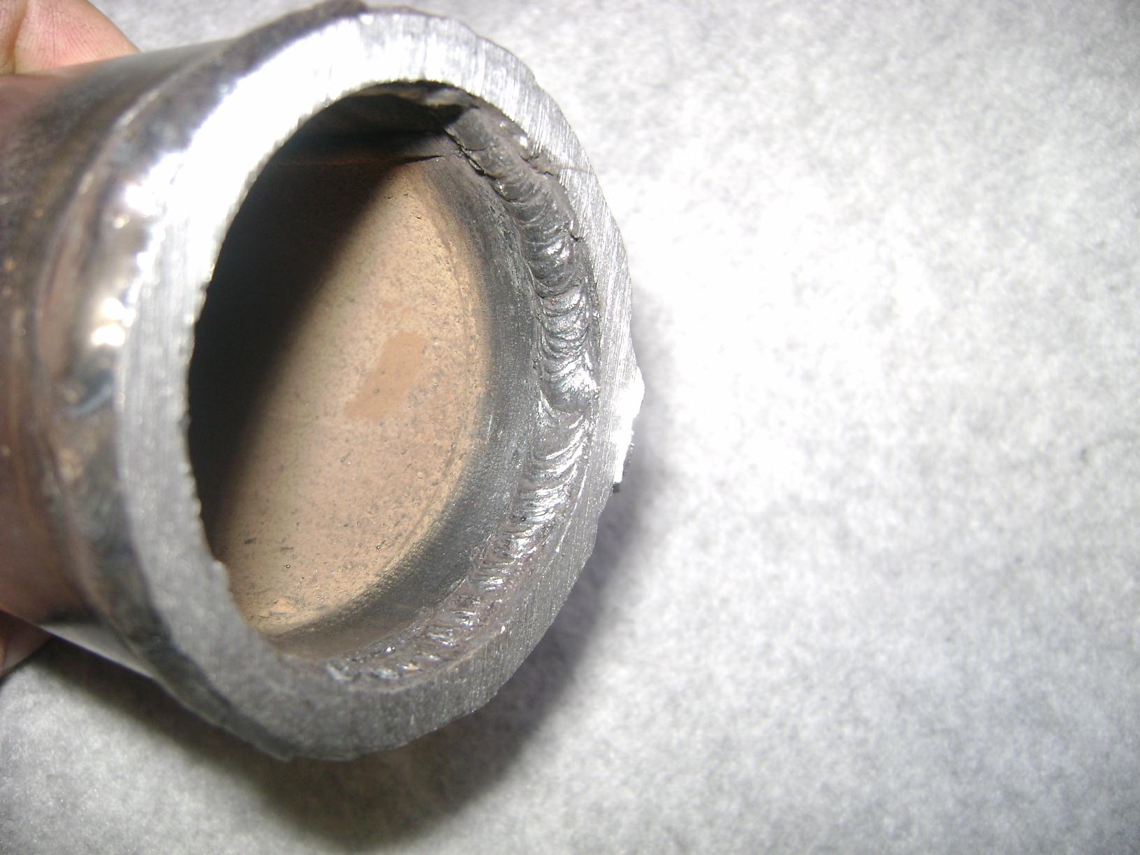

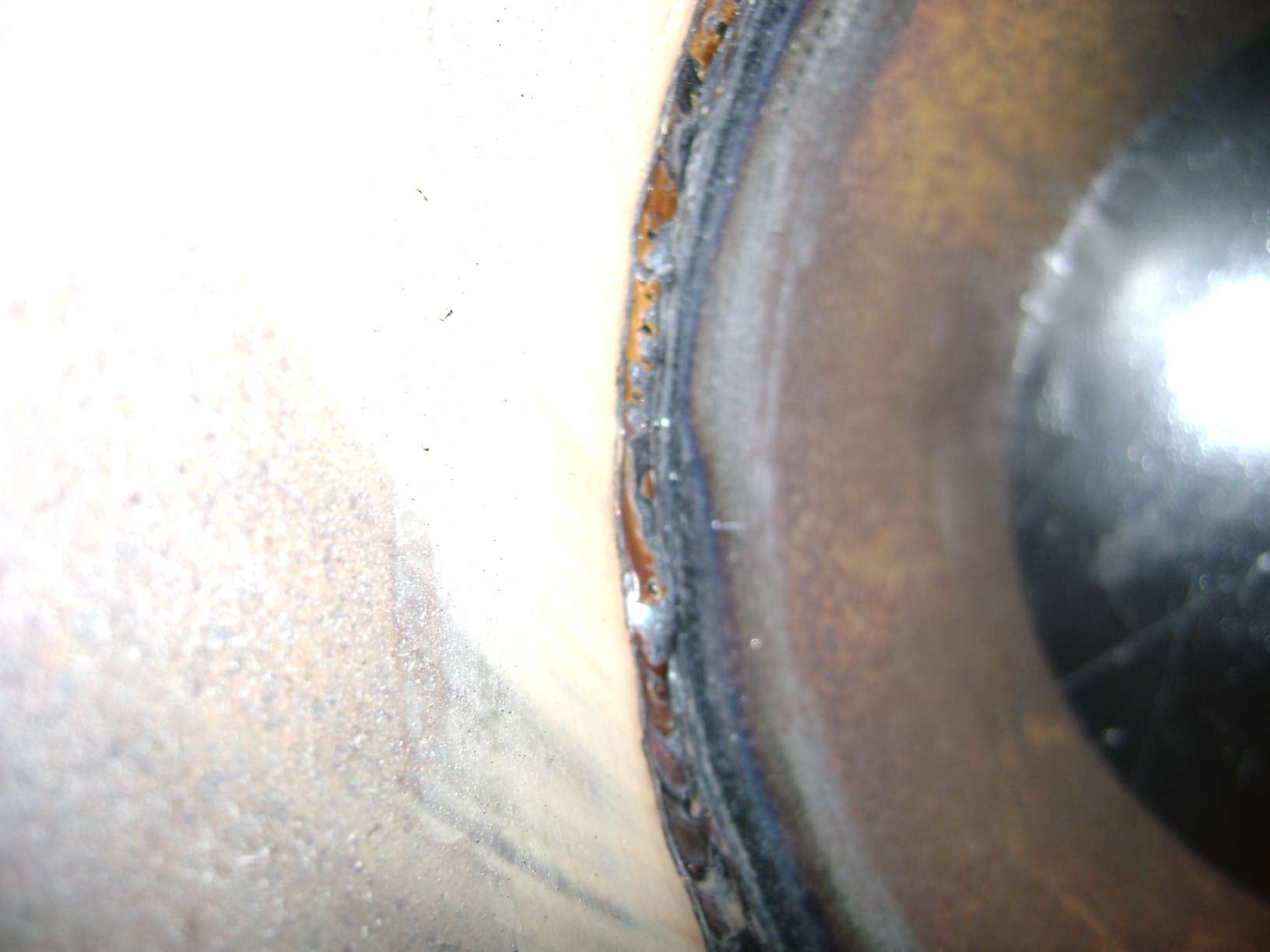

Ken I don't hardly ever weld anything 1/4 inch and above without a bevel or gap. When you use a 9-inch angle grinder it only takes a few seconds to put a bevel on something. But as lostcause says, it all depends on the application.
Here are some full penetration welds on pipe with SMAW, (stick) and Tig. If you are interested I can post some pictures of AutoCad drawings of joint designs I use.
