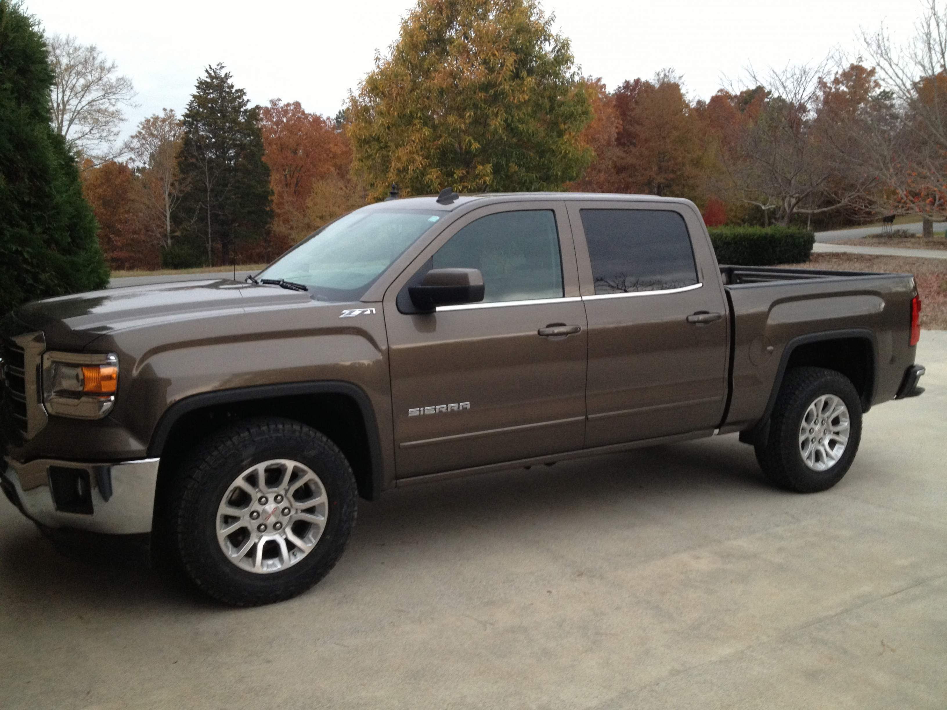

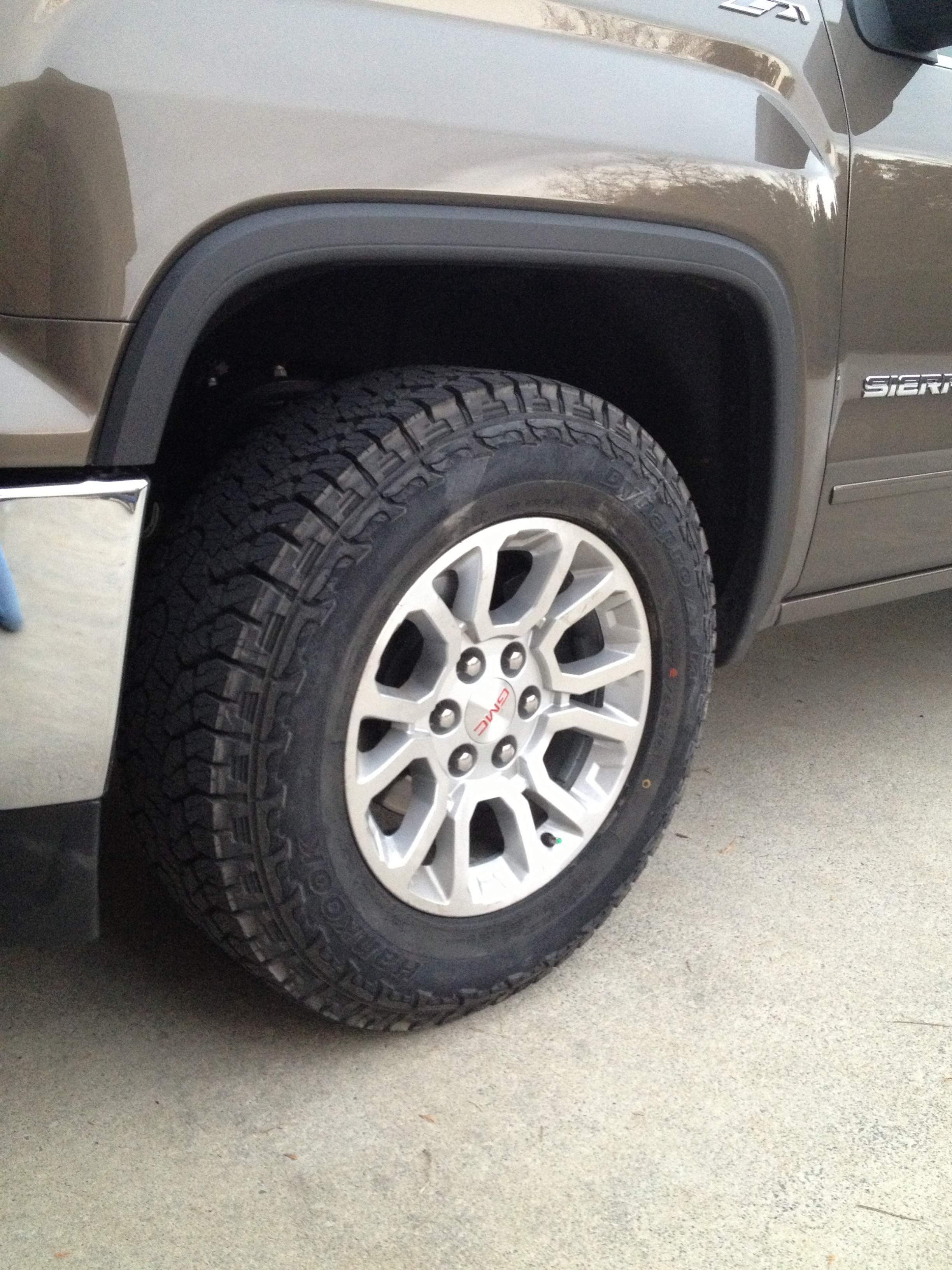

Well got the tires mounted today and so far they ride great and at least to me look pretty sharp without being overly aggressive looking.
Ride noise is a touch higher with these as compared to the SR-A's, but by halfway through the day I couldn't even tell the difference. Running them at about 65 psi from the store and they feel great. I can obviously feel the road more that the previous tires but it still is a pretty darned good ride. Actually with the short time driving thus far the truck feels like it handles better with these tires, and there was no issues with rubbing going to the LT275/65R18's. Hopefully, I'll continue to be happy with them into the future.
