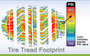

In any case it'd be kinda neat to get a hold of some pressure sensitive paper like FujiFilm makes:
But that would be more for &h!ts and giggles.

Once, I parked my front tire on a piece of graph paper and then sawed at the steering wheel gently, to mark out the tire footprint on the paper. That was the front tire on a Honda S2000. Worked very well. Makes for a good science project with kids, since you can use footprint area multiplied by tire pressure to estimate the total weight sitting on the tire (give or take sidewall stiffness effects, and it doesn't work with run flats of course). In that case, the math came out very close to the expected weight, which was cool to see.
