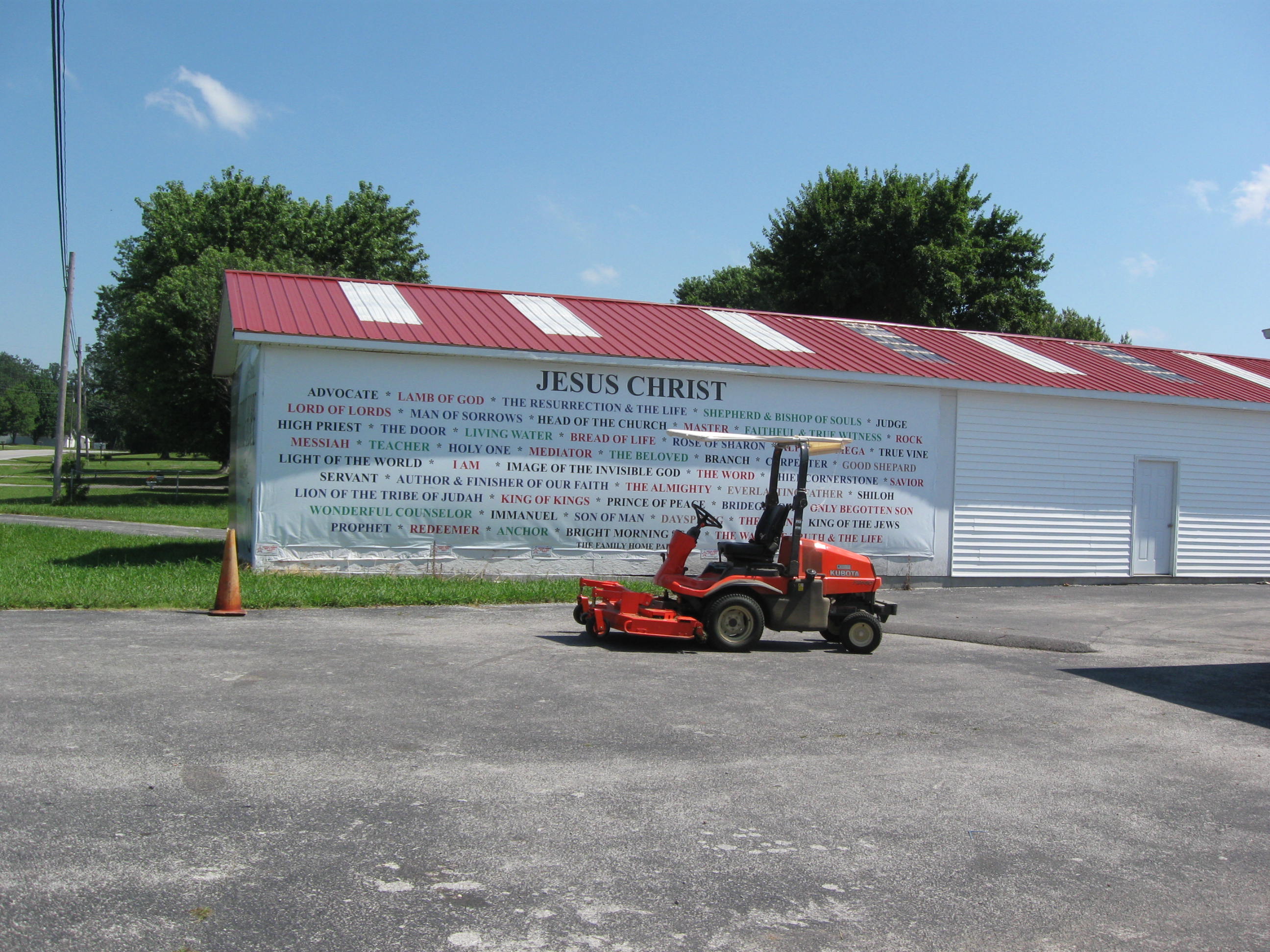

I've finally settled on the hillside/flatland mowing champion. It's a bit more expensive but divide the additional cost over the time of financing and it's not that big of a number. I have an F2680 60" 2wd (owned over 3 years)which I mow level rental property with and an F3080 4wd 72" deck (owned over a year) I mow my home hillside property with. The F3080 4wd is like a Billy Goat and the most stable Kubota I own. I mow some of my hills crossways with it. Love the F's and think "almost" everyone should have one.
They are a bit faster on pavement over a zero turn but I never drive mine out of the turtle speed while mowing and pedal to the floor even at the lowest will just about throw me out of the seat. I only use the rabbit speed when driving up a paved street and it will almost give me nosebleed from the speed.:laughing: Have to tell all that because of the people that say (falsely) that a zero turn is faster.
If mowing can be fun then it's fun with the F.
