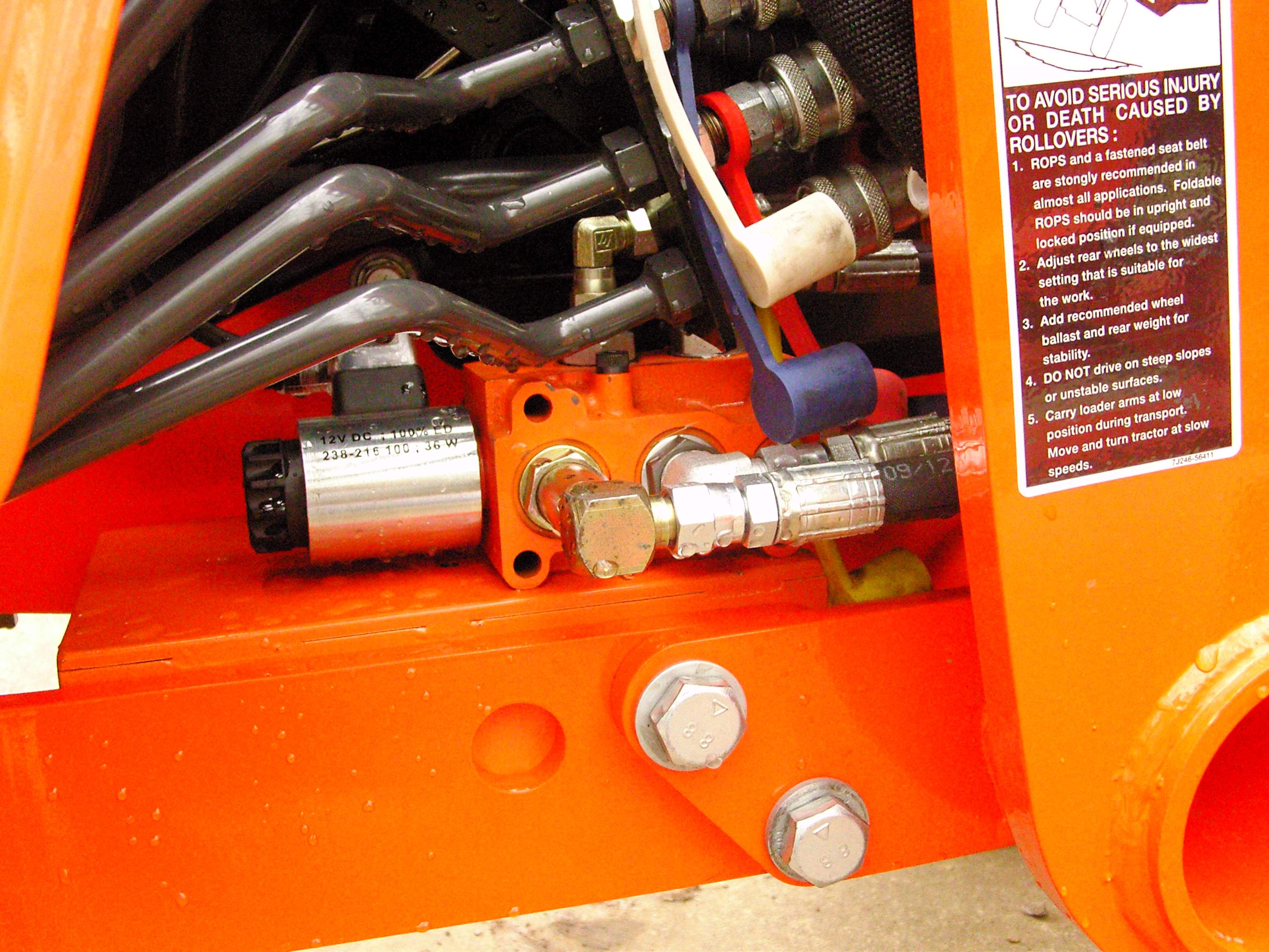

Aahhh - Ok, I think this is making sense now. I had to read it a couple of times for it to sink in though.
I believe the current setup is as so:
There is a distribution block under the seat area on the tractor. The feed from the hydraulic pump feeds that block - which then in turn feeds the loader valve - and the pipe with the quick connect on it that feeds the backhoe.
Then - there is another quick connect at the back of the tractor - that goes to a pipe that feeds directly into the side of the 3pt block(valve?). When the backhoe is disconnected - the two QD's that normally connect to the backhoe - are just jumped together so the fluid flows directly to the 3pt block. When the backhoe is connected - trying to operate the 3pt must cause some sort of backpressure in this system which can damage the valves in the backhoe - which although they may have pressure relief - have nowhere else to dump to - except for that feed into the 3pt.
So what I need to do is find a way to feed the out port back to the tank. There are some unused ports on that distribution block I mentioned - I'll have to take a closer look at that to see which ones might dump back to the tank. Once I figure that out - I can run a hose or pipe out - put a QD on it - and make it the return or out line.
Then I'd be able to hook up a joystick - or some spool valves - to the QD's on the three lines - make sure the power beyond feeds the 3pt - and the Out port goes back to the tank - and it should work - and this will avoid any damage issues because the pressure relief will dump to the "out" port.
Do I have this correct?

Sounds like it you have it.
What I would do (assuming that the backhoe is connected with a flexible line) is to take the line that currently feeds the backhoe "In" and run that to the "In" on your remote block, the run the "Out" from your remote block to the "In" on the backhoe. I would take the "Tank" port on your remote block and feed it directly into the tank (through the filler port?).
Then your new remote block is upstream of the backhoe and cannot hurt the backhoe block.

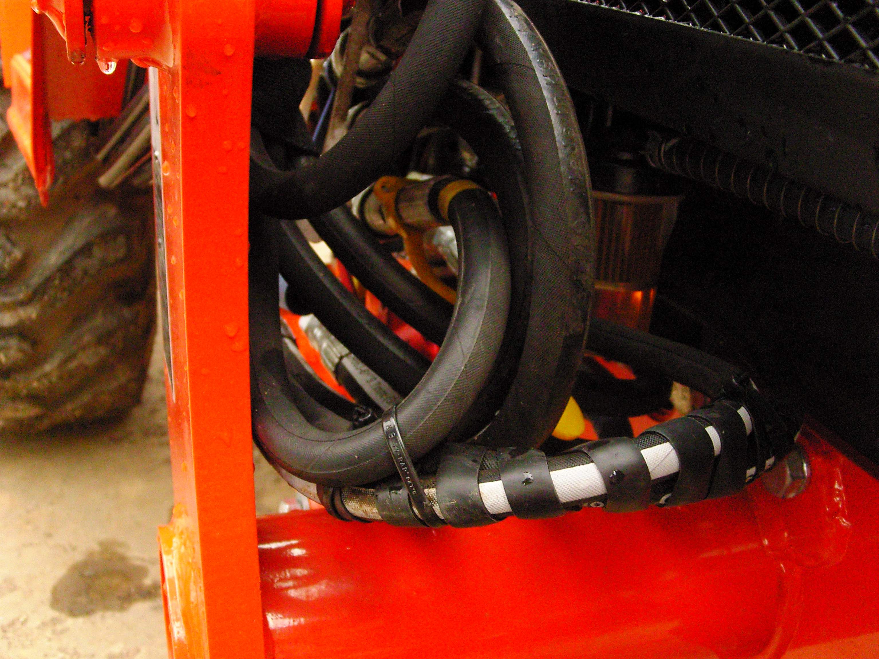

I've been going back and forth tonite reading the manual and cross referencing by running out to the barn to look at the actual tractor, and I think this has helped me to get this all (mostly) figured out - I hope.
After going back and forth and finally crawling under the tractor to take a look - I did find a port where I might be able to cut in for the tank return. The manual showed a "tank" port on the loader valve block - but I had to crawl under the tractor and really look before I could see it.
There is a what defintely appears to be a lower pressure hose (it's painted over but I can see the weave coming thru the paint) - which is attached to the loader valve block with a hose clamp - and it appears to go into the side of transmission case - which is where I assume the resevoir is.
Which leads me to another question - can I just splice into this line - or add a block or something (to accept more "tank" or "out" lines) - so all of my "outs" will feed back into this port? Do I have to worry about backpressure at all or is this low enough pressure that there should be no concern there.

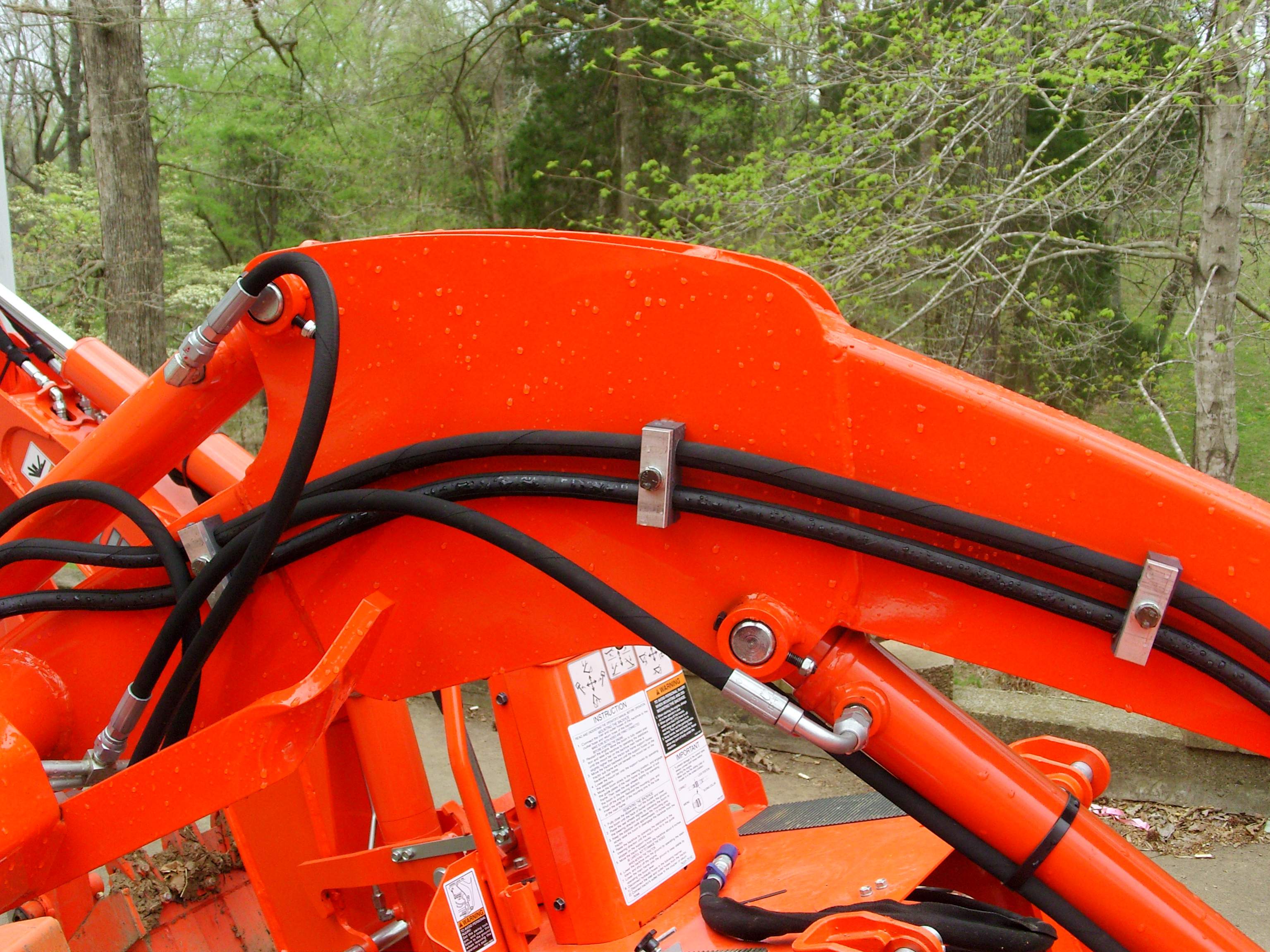

I'd like to add some more hydraulics to the front of the tractor also - and my I want them to be active at the same time the loader is active - so I was going to do something like use a Fasse valve on the backhoe line - to feed hydraulics forward for the additional valves there. Those valves will also need a return "tank" line. If I plumb all of this into a block or something - which then in turn feeds the tank - will I have any issues with backpressure affecting anything dumping into that common return block?
   / Thinking of a top and tilt setup #20
An easier way to get the 3rd function on the loader is a diverter valve on 1 of the control line sets. Much cheaper also. Also wouldn't mess with the BH at all.
