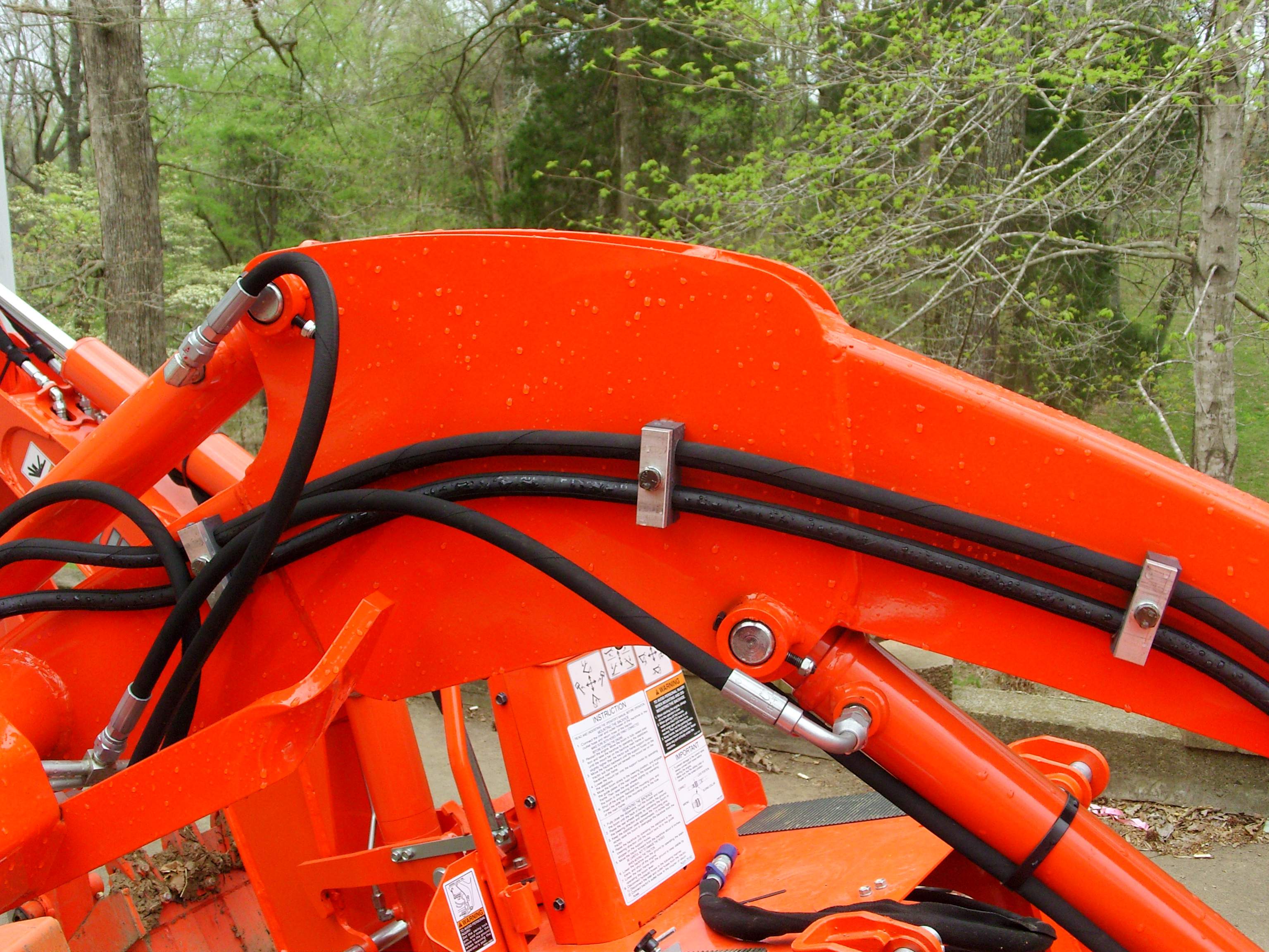

As a less expensive alternative to JJ's suggestion for a diverter valve, take a look at this one - Details Stackable Solenoid Operated Circuit Selector Valve | Type SAE 8 SELECTOR VALVE SOL OPT SAE 8 220-934
This is the one I installed on my B3300SU ($110) with a foot activated switch from Amazon for the grapple - less than $10 delivered for the switch for a combined cost of $120. I'll get some pictures of how I mounted it this weekend if you would like. I found a very secluded spot for it, but it was a pain to plumb.

Here are some pictures of where I mounted my diverter valve, it's behind the front tube of the loader mount. I made a right angle bracket and used the bolts that hold the loader mount and back brace together. It's very tight in that space, but it's pretty well protected as well. I hope the pictures make sense - it's very tight and compact in there - so hard to get a picture. I ran the supply lines for dump/curl to the diverter directly from the quick disconnects via some new 18" long hoses. The original dump/curl hoses connect to the diverter and the new hoses for the grapple are secured to the inside of the loader arm. This eliminates the ability to remove the loader assembly but I don't care because I can drop the grapple or bucket from the arms in 2 minutes using the Kubota quick attach feature.

Here are some pictures of where I mounted my diverter valve, it's behind the front tube of the loader mount. I made a right angel bracket and used the bolts that hold the loader mount and back brace together. It's very tight in that space, but it's pretty well protected as well. I hope the pictures make sense - it's very tight and compact in there - so hard to get a picture. I ran the supply lines for dump/curl to the diverter directly from the quick disconnects via some new 18" long hoses. The original dump/curl hoses connect to the diverter and the new hoses for the grapple are secured to the inside of the loader arm. This eliminates the ability to remove the loader assembly but I don't care because I can drop the grapple or bucket from the arms in 2 minutes using the Kubota quick attach feature.
https://lh5.googleusercontent.com/-...uI/AAAAAAAAAG8/GLUZKksDlCA/s1108/SNB16466.JPG
https://lh6.googleusercontent.com/-...-I/AAAAAAAAAHI/BuBXguYV5IQ/s1108/SNB16469.JPG
https://lh4.googleusercontent.com/-...BI/AAAAAAAAAHQ/rG3XutIk7Ko/s1108/SNB16472.JPG
Nice setup. Looks like it came out nice and clean. I'm still looking to see if the components are available to put together the setup I've been thinking of. The missing piece I'm looking for at the moment is a simple diverter valve that will take one output and allow me to choose between two outputs. If I can't find that - I'll likely just use some type of diverter valve that has multiple input/outputs - and just block off the ones I'm not using.
