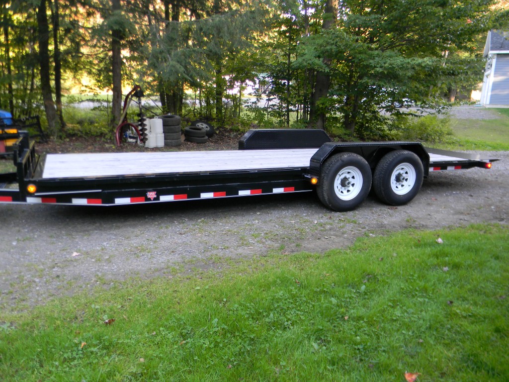

This shows the difference in rear overhang of my 22' deckover, compared to the tilt above. The 4' Dovetail is a lot shorter and the axles are back further. :thumbsup:
I'm not sure I'd want the axles that far back....almost anything you load is going to be centered quite a bit forward of that, it would seem.
   / Thinking of buying a tilt trailer, advice please #18
Guess it would depend... a larger TLB with filled rears would have a lot of weight to the rear...
   / Thinking of buying a tilt trailer, advice please #19

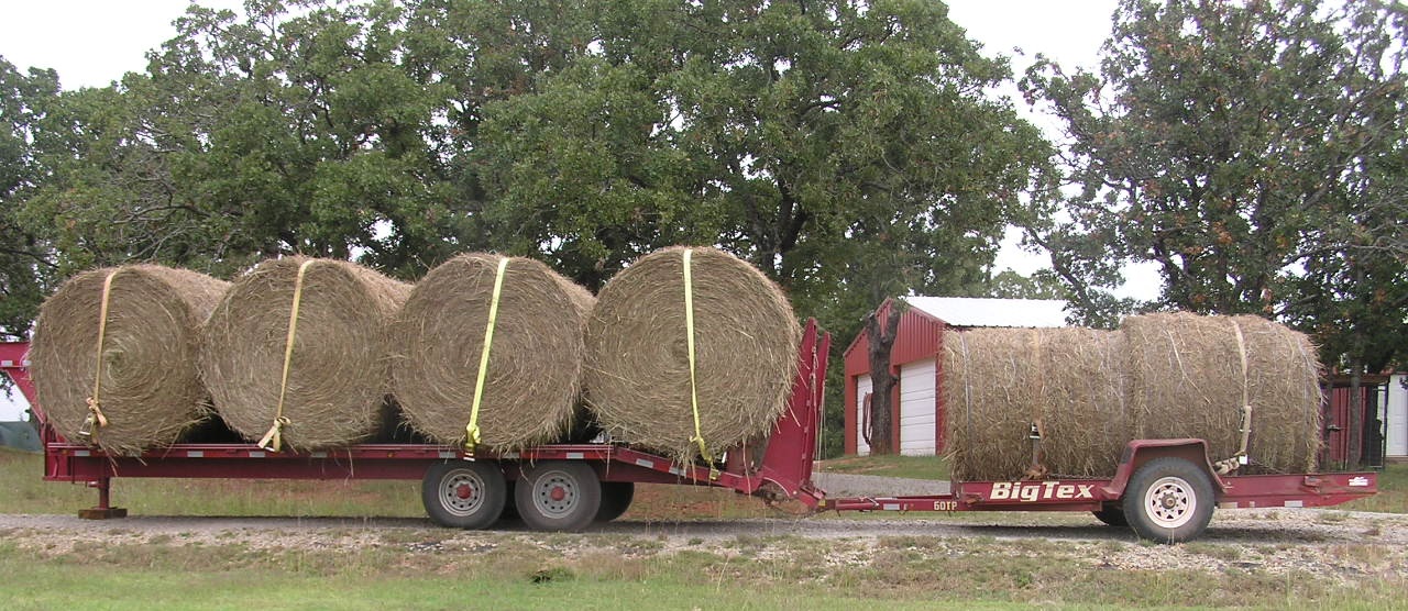

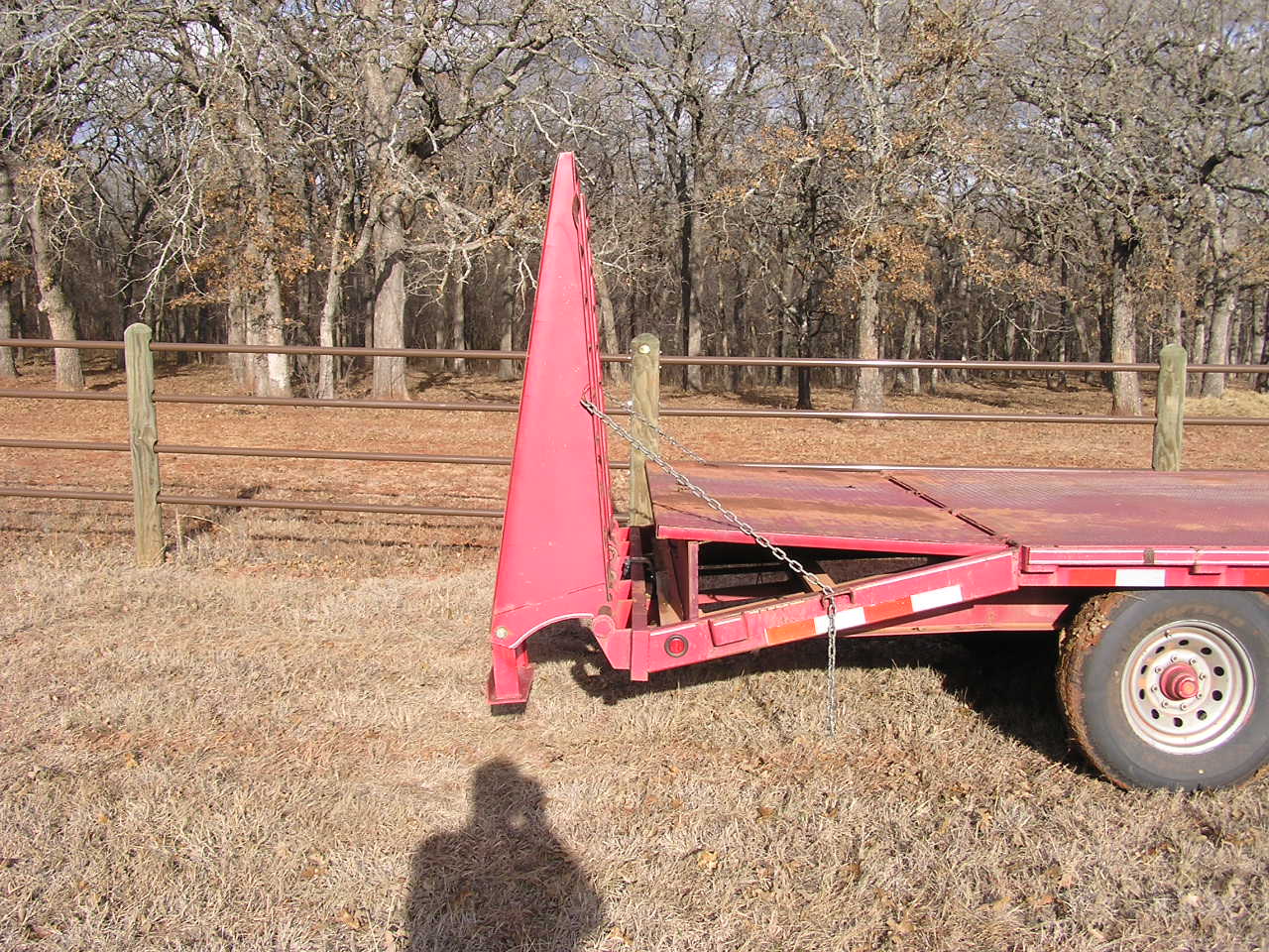

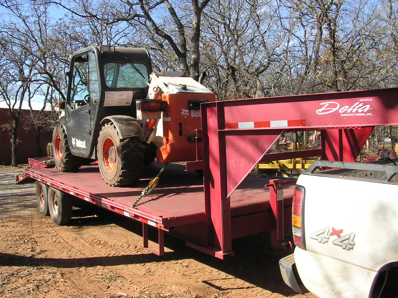

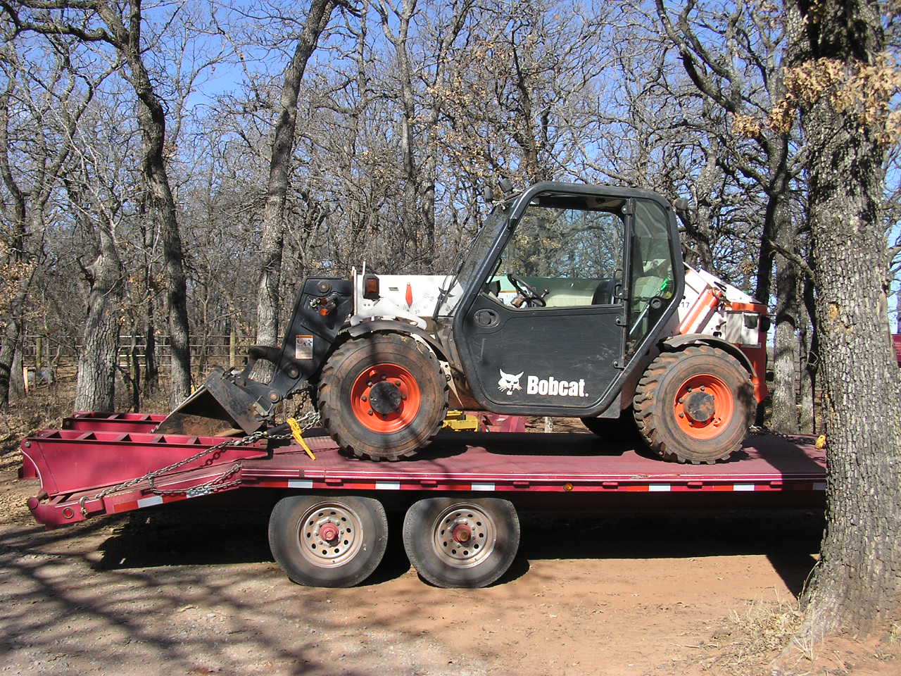

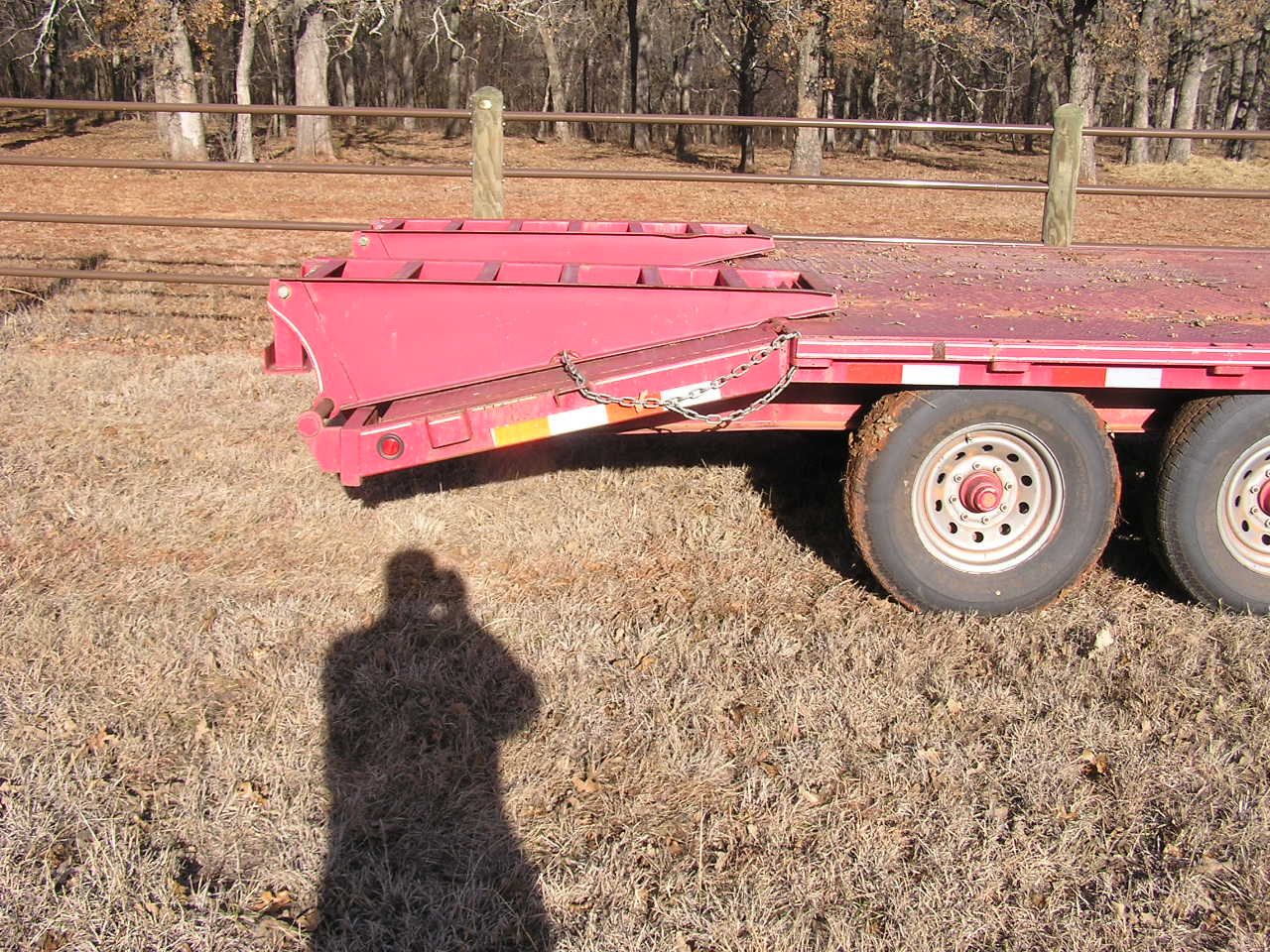

This is were the V417 rides the best.
Not sure that I could haul eight 5x6 round bales on that 22' tilt trailer. No problem on this one and can pull two or four more on the Big Tex tilt.
