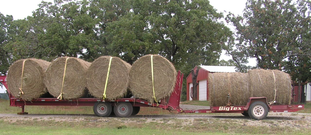

Not sure that I could haul eight 5x6 round bales on that 22' tilt trailer. No problem on this one and can pull two or four more on the Big Tex tilt.

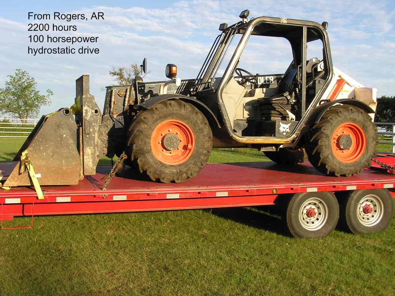

In this pic half of the weight is forward of the axles. I can't see how that can be anything other than heavily loaded towards the tongue. Maybe it's less of a concern with a GN setup than bumper pull, but I think it would be interesting to see how it worked out on a set of scales.

I'm not sure I'd want the axles that far back....almost anything you load is going to be centered quite a bit forward of that, it would seem.
That's about perfect axle placement for most of the equipment I haul.
Those bales are kinda light, probably around 1200 pounds. The heaviest that I ever weighed were 1450 pounds.
The trailer weighs 5000 pounds, with 1000 on the ball, 4000 on the axles.
The V518 is the heaviest load that I have hauled on it. Seven years ago, went across the scale at 24,940 total, truck and trailer. 12,640 on the deck, 3,440 on the ball, 14,200 on the axles.

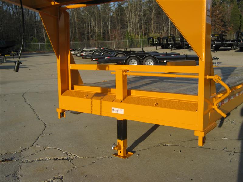

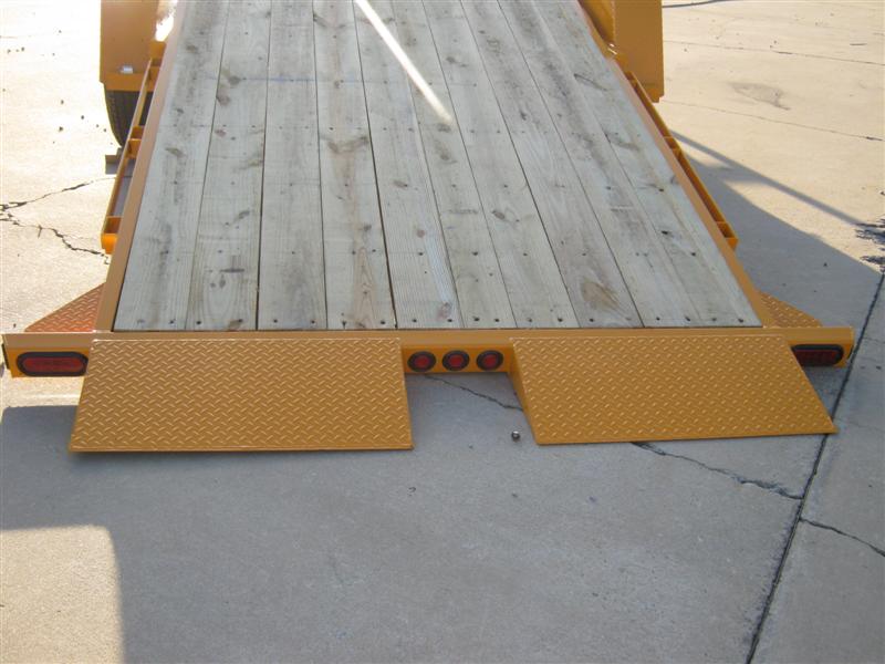

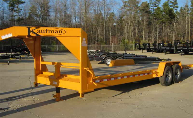

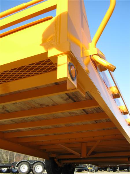

These are pictures that Kaufman sent to me when I contacted them:
