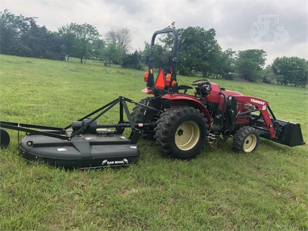

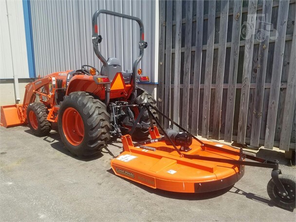

   / Thinking of l3560HST CAB tractor #24
Here's an L3560 with a 5' mower and below is a Yanmar YT235 with a 5' mower. Both are 35hp and both mowers fit perfect. Both available with cabs and A/C.
View attachment 553316View attachment 553317
Thank you! I looked at a YT235 with a cab just this week. Its a nice tractor but doesnt have some features I am looking for. Perfect size tho. I think the 3560l is probably the tractor for me. But I am still a couple weeks off being done with this B2601 so who knows.
