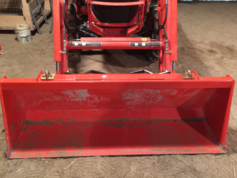

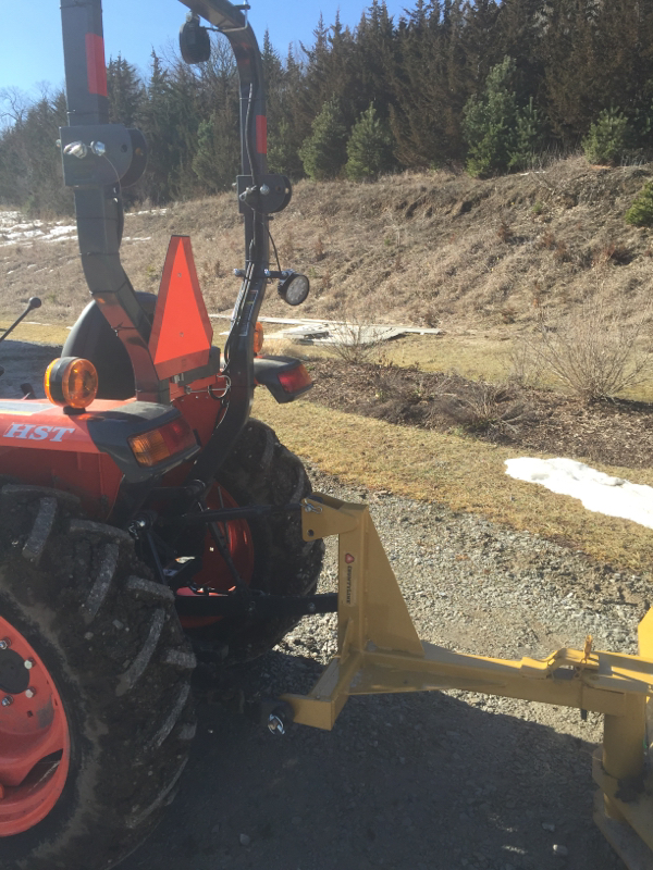

Ah- if you will be snow plowing, then most definitely get at least one remote... Lots of users like the third function installed on the loader joystick, but for snow plowing, a rear remote works just fine. I can see where a third function might be handy for a loader grapple, but I think a rear remote is cheaper, and for $100 you can run a pair of hoses with couplers to the front. Plus you still have the rear for whatever. Maybe get two while you are at it- not cheap, but the second should cost less than the first, and so forth, since they will stack. I don't have a good picture of how the hydraulic hoses are attached to the left loader arm, but here's the hoses that feed the relief valve on the plow- if it hits something, it will just pivot free without damaging anything. You adjust the relief pressure to find a happy place, based on trial and error (well, avoid the error). You can sort of see the hoses in the second photo...

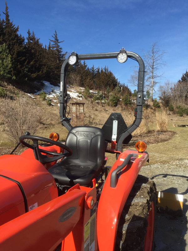

I put a 36w LED worklight on the FEL. Very inexpensive and you can wire it into the factory connector. 3D printed a simple switch housing.
