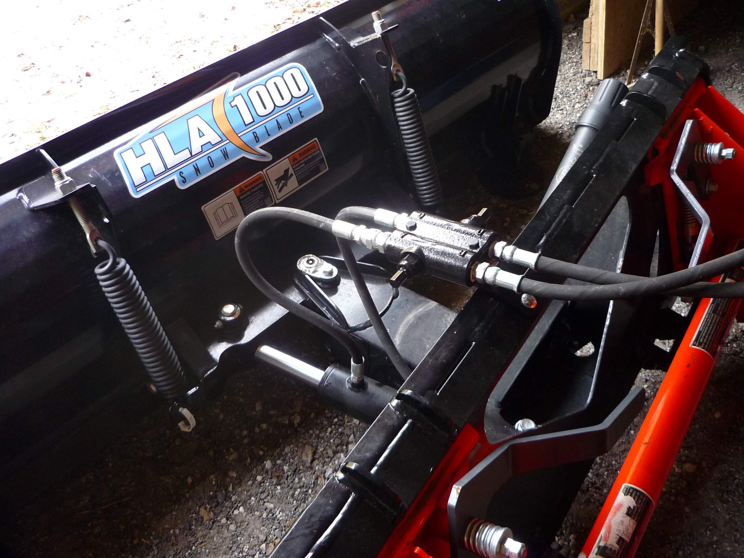

#22
For the rear remotes, what is it that I ask for? 3 rear remotes? About how much should they cost? Being able to angle my snow plow without getting off the tractor would be great.

   / Thinking of trading for a L3901 #24
Ah- if you will be snow plowing, then most definitely get at least one remote... Lots of users like the third function installed on the loader joystick, but for snow plowing, a rear remote works just fine. I can see where a third function might be handy for a loader grapple, but I think a rear remote is cheaper, and for $100 you can run a pair of hoses with couplers to the front. Plus you still have the rear for whatever. Maybe get two while you are at it- not cheap, but the second should cost less than the first, and so forth, since they will stack. I don't have a good picture of how the hydraulic hoses are attached to the left loader arm, but here's the hoses that feed the relief valve on the plow- if it hits something, it will just pivot free without damaging anything. You adjust the relief pressure to find a happy place, based on trial and error (well, avoid the error). You can sort of see the hoses in the second photo...

#29
I spoke with the dealership about adding a rear remote and his number was in the $1k ballpark for 1 rear remote - does that sound about right? That's probably more than I want to spend on something I don't need yet. I see that the rear work lights are only $85, I'll tell them to add those.
   / Thinking of trading for a L3901 #30
Ya, about right for a factory kit. I think I spent around $2k for 3 spools (2 on a joystick with float) & my TnT system getting it through MtnViewRanch (FitRite Hydraulics).
