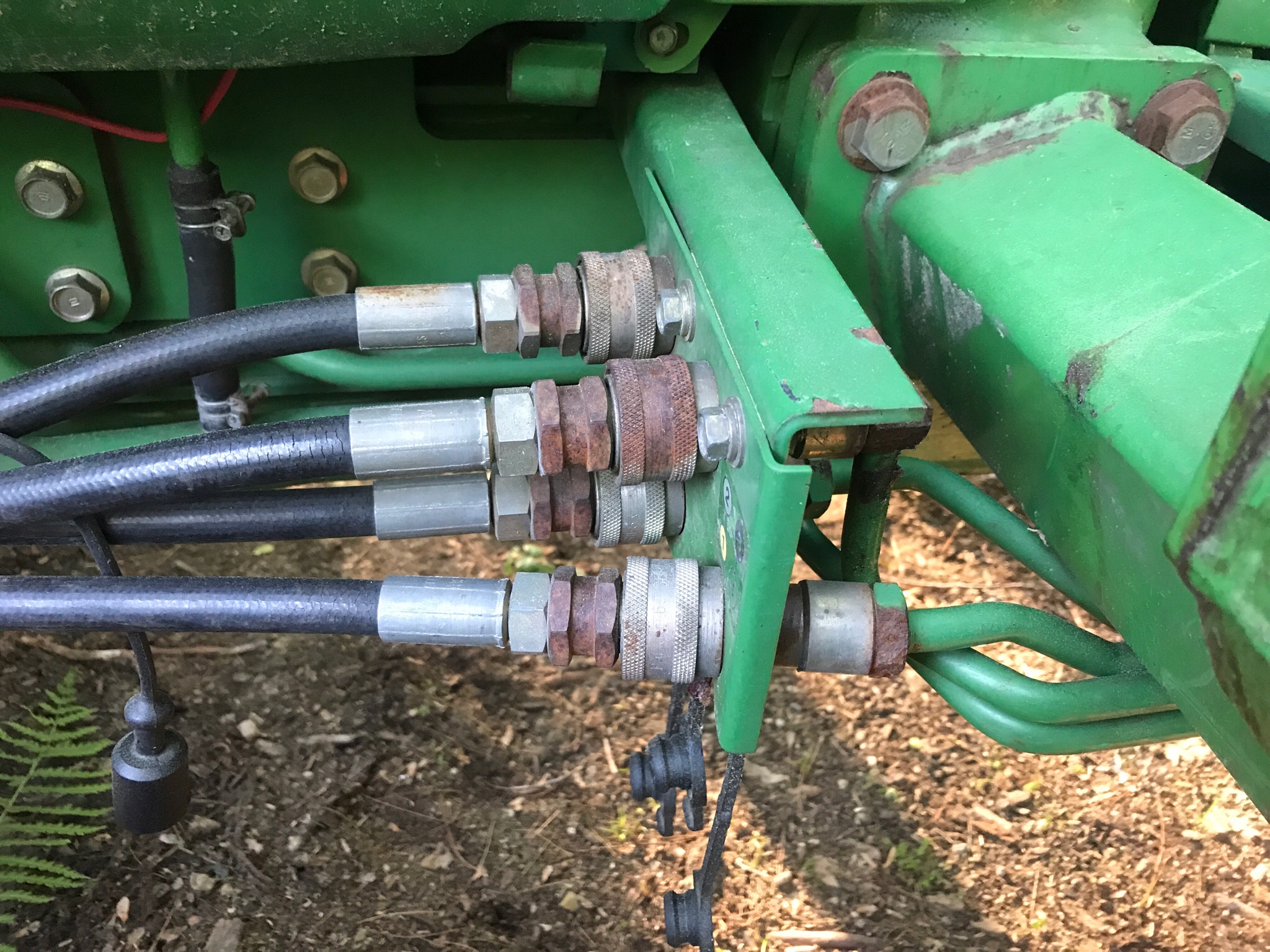

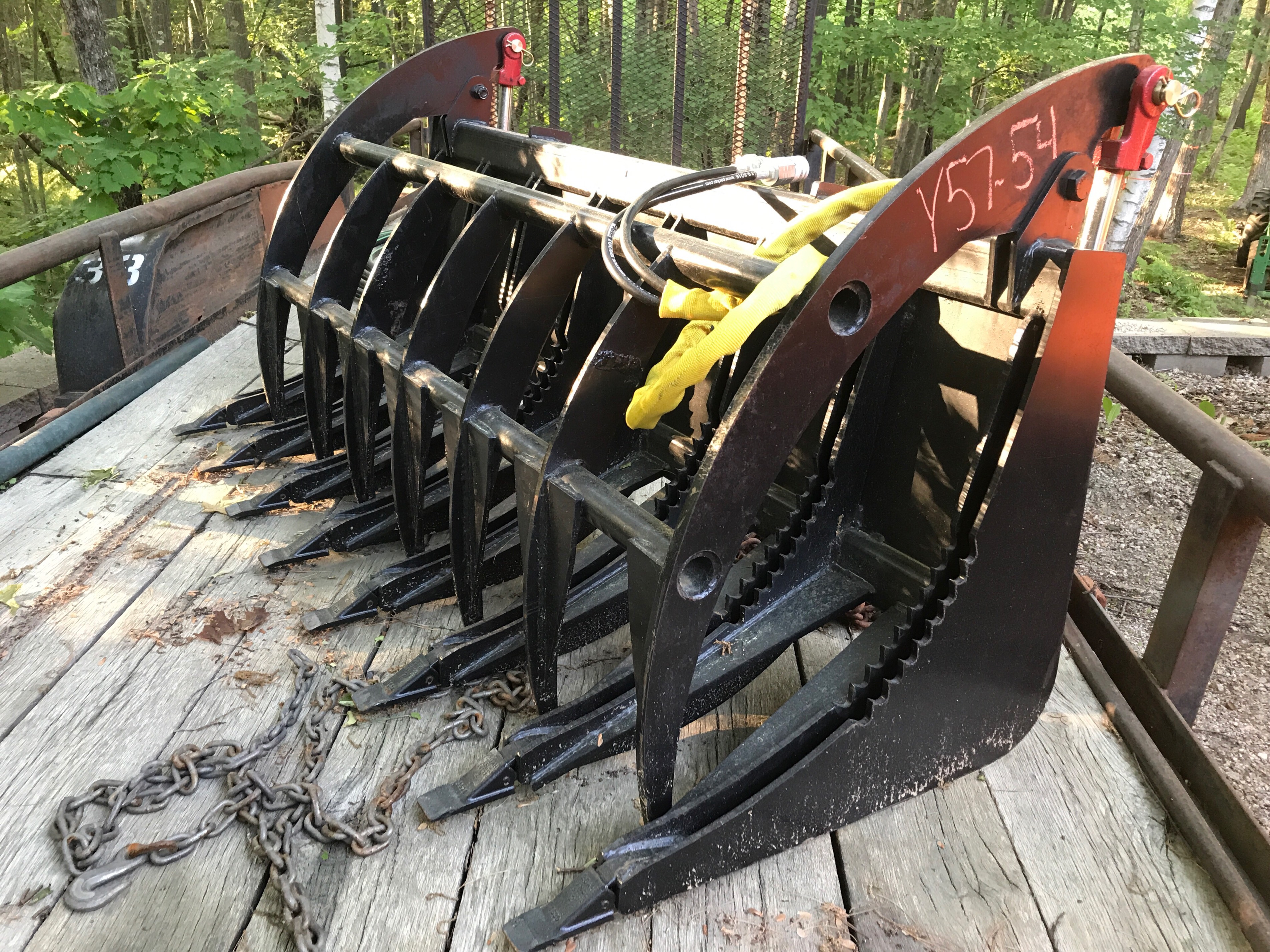

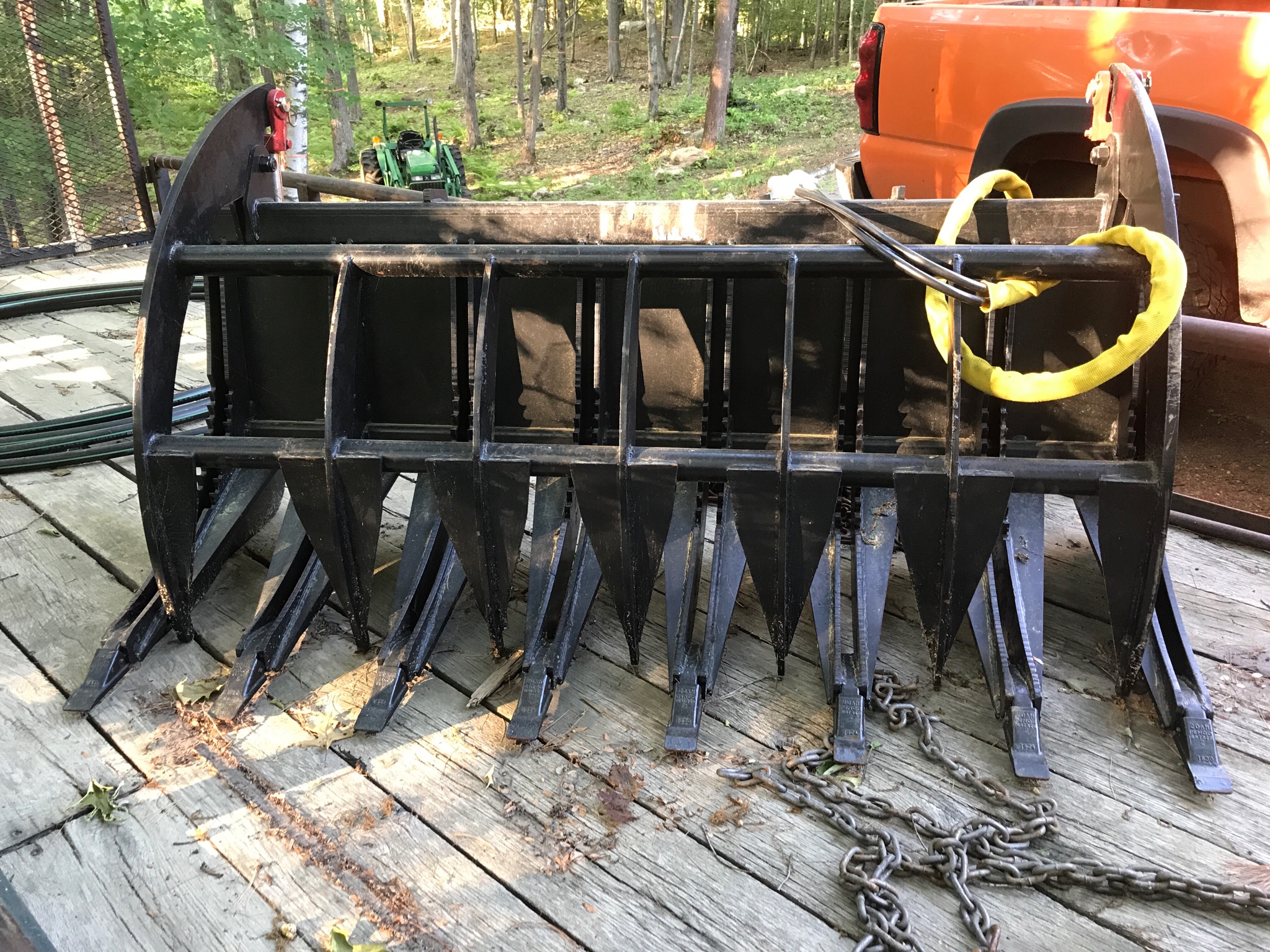

Attached are some photos of the grapple bucket and the hoses on my tractor where the multiplier would connect
/ Third Function Needed to Run Grapple #8
Wow how heavy is the grapple? That looks to big for your 970, and I assume you have the 440 loader? That's only spec'd at lifting about 900lbs.

You tractor was last made in 1998, so I doubt JD will still have anything for your machine-pretty sure they never offered anything but a Power Beyond kit anyway.
Sure, you can fab a bracket to support it, but you can also buy just the valve from us or the Surplus Center and remote mount in a safer place. Either way you will still need hoses and fittings to get everything working. I was just trying to give you some options that may fit your needs better and save you some money. Did you search like I mentioned above?
Adding a true 3rd function is not as easy on this machine as it is on some, you have to remove some hardlines and replace the banjo bolts and replace with ORB fittings to tap into the main hydraulic flow.

Hi, thank you for the reply. The grapple is 66" wide, I am unsure of the weight but I would guess about 400 Lbs. Mounting the valve in a spot other than where the Fasse kit would be mounted does seem safer. Which valve would you recommend; and if possible, can you send me a link from your website or Surplus Center? Getting hoses and fittings isn't an issue. If I go the route of buying the valve separate and piecing everything together, I will also need to find a switch, preferably one that can mount on the side of my loader lever. Thank you, Randy
/ Third Function Needed to Run Grapple #11
Randy, find a way to weigh that thing-it looks well more than 400lbs. Can you easily lift it now with your loader?

I unloaded the grapple off my trailer with the loader and it lifted it fine. My loader is a 440.

The Fasse valve you linked, just like the three products I linked are all "diverters", they "divert" one function to another so there is no simultaneous operation of the two different functions. It's either dump/curl OR open/close on the grapple.

I agree the grapple is too big.
The 970 is a smaller and lighter machine that needs a smaller and lighter grapple.
