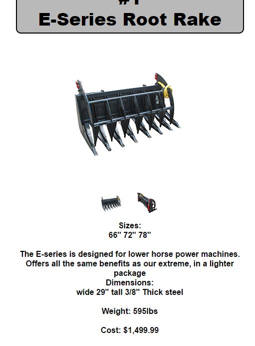

Randy, find a way to weigh that thing-it looks well more than 400lbs. Can you easily lift it now with your loader?

I unloaded the grapple off my trailer with the loader and it lifted it fine. My loader is a 440.
If I installed one of the valves you linked, would it operate the same as the Fasse? Meaning, would I be able to operate lift, curl and grapple simultaneously?
I appreciate your help, as my hydraulic knowledge is limited.
   / Third Function Needed to Run Grapple #13
I'd still try to weight it...
The Fasse valve you linked, just like the three products I linked are all "diverters", they "divert" one function to another so there is no simultaneous operation of the two different functions. It's either dump/curl OR open/close on the grapple.
   / Third Function Needed to Run Grapple #14
Wow how heavy is the grapple? That looks to big for your 970, and I assume you have the 440 loader? That's only spec'd at lifting about 900lbs.
My findings indicate it's 600 pounds.
Travis
   / Third Function Needed to Run Grapple #16
I agree the grapple is too big.
The 970 is a smaller and lighter machine that needs a smaller and lighter grapple.
#17
Thanks for the recommendation. Considering I already own the grapple, I would like to see it performs, if poorly I can sell it and buy a lighter one.
Is there a solution for adding a third function and being able to have all three functions at the same time: lift, curl, and grapple?
