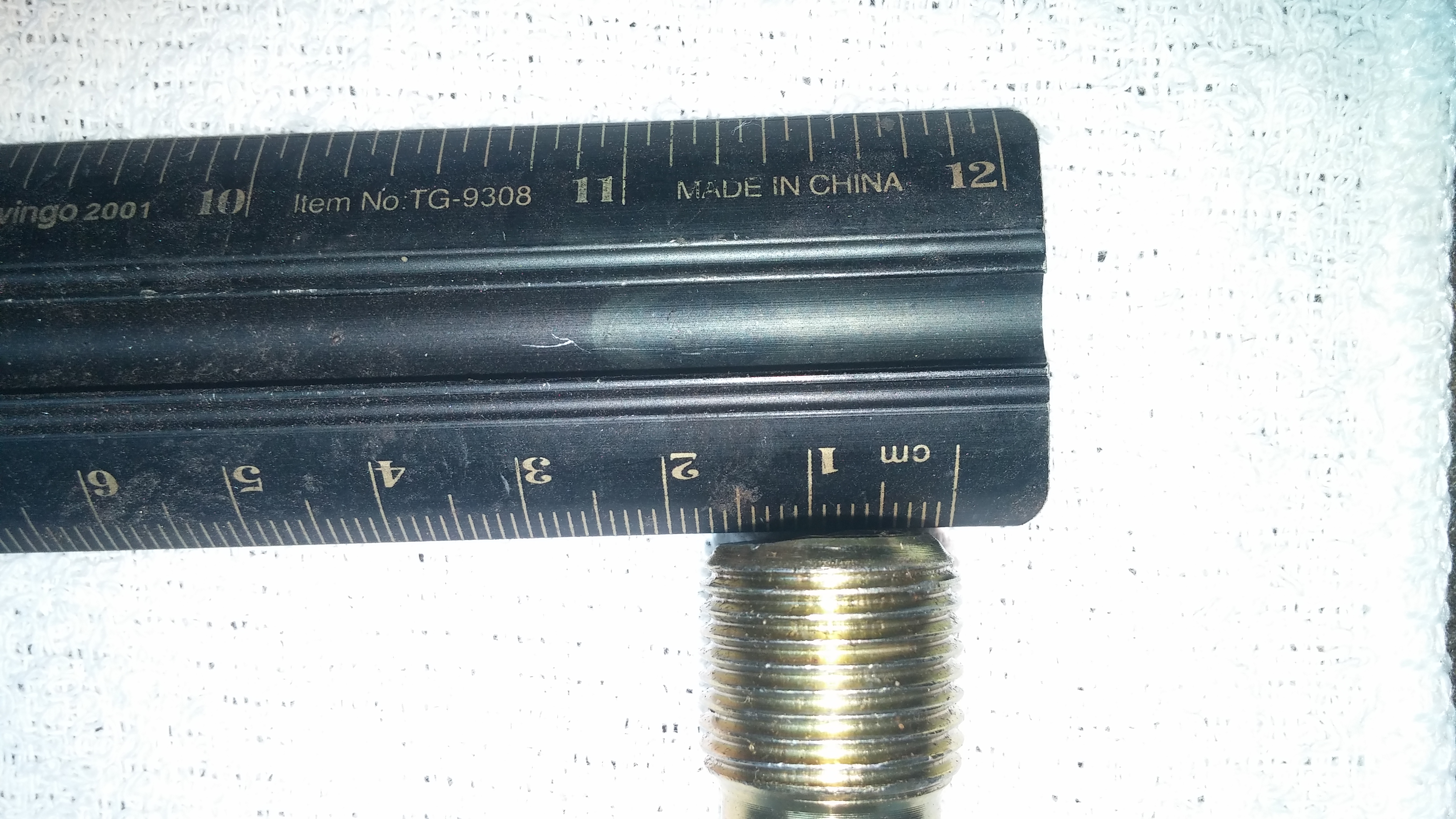

As luck (or Murphys Law) would have it, when we had the bolt pulled, the calipers were at my place and not dad's so this was the best I could do with what I had.
Based on what you all are telling us & some standard dimensions I found HERE (and since 3/8" = 9.5ish mm) I'm guessing that we now need a 3/8" BSPP Male to NPT Female adapter (as I was previously leaning towards an M18X1.5 to NPT)
If someone out there with a bit more know how could "check my math" I would appreciate it.
I did run by the local Parker distributor today but trying to guess from pictures wasn't very productive.
Thanks again!

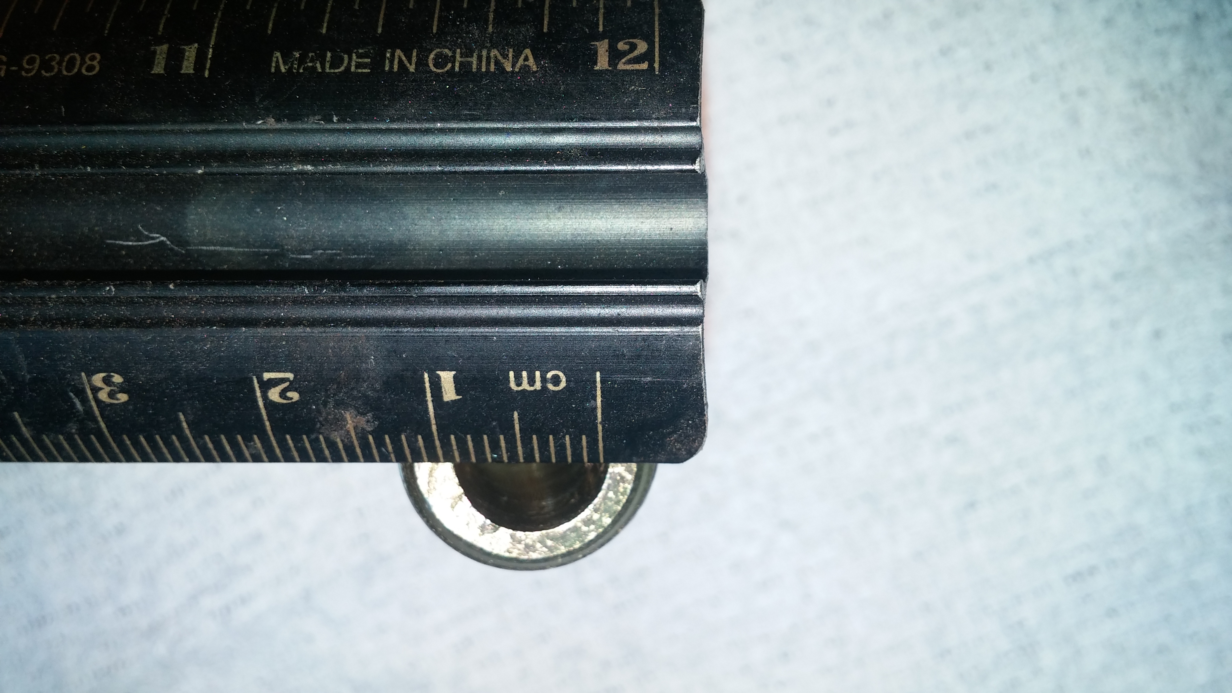

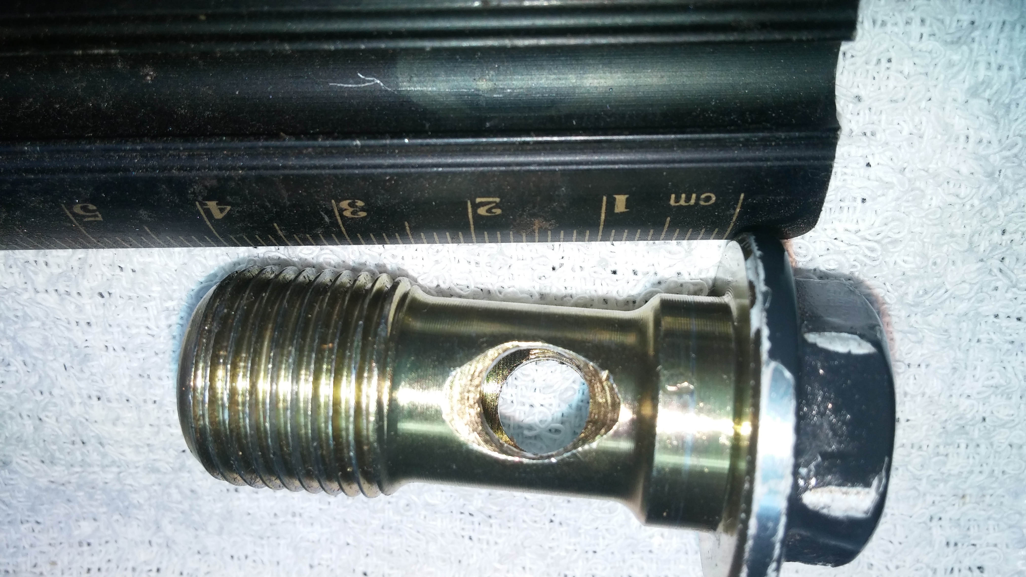

And this is where the world of hydraulic fittings gets confusing - just exactly what dimension of a "3/8 inch fitting" is the 3/8 inch referring to? :confused:
If you look at the 2nd picture I posted it looks like the width of our bolt is between 16 and 17 mm - which matches the 16.5mm or .65" in the chart you list.
Additionally, If you look at the 3rd picture I attached, the orifice opening is just under 10mm.
3/8" (or 0.375") is mathematically 9.5 mm and in the link I have there that shows the orifice size of the "3/8-19" banjo bolt as 9mm. Unfortunately it does not give a total OD of the threaded portion but obviously it must be larger than 3/8"
So with yours and Eric's vote on the BSPP as thread type, I think we've confirmed the size as a 3/8"
Now lets see if we can find some. LOL
Thank you for all the help thus far. Any other tips, tricks, or been there - done that's are still welcome.

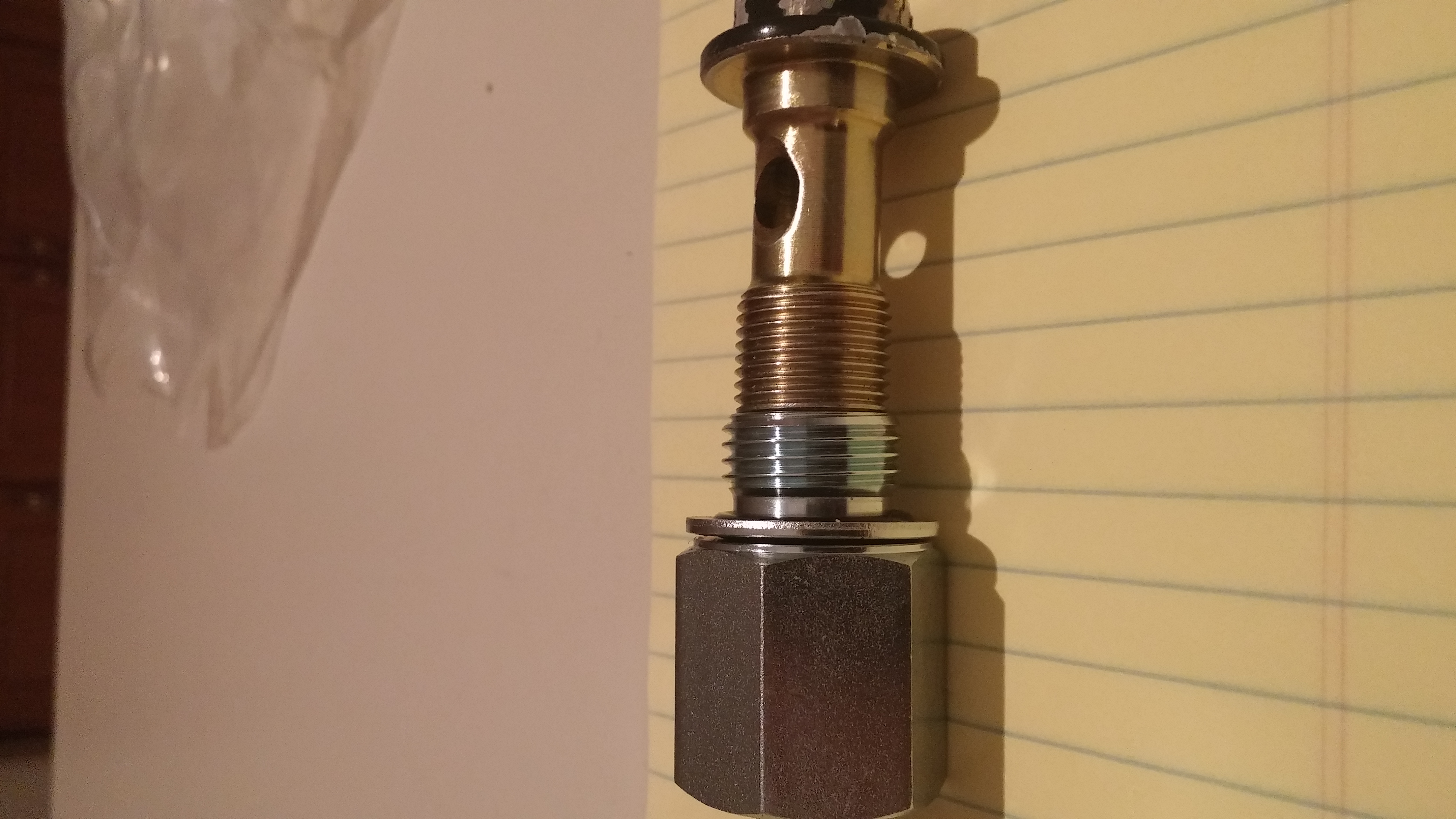

Well I did the test fitting today and these ain't it. :(
2 Things were clear though
1) The threads at least matched
2) 3/8" is too small
I did some more measuring (with real tools this time) and it looks like I needed 1/2" after all. I'll be placing a new order and sending parts back on Monday and hope to have better news by next weekend.
That would make the new part number 9035-08-08 for those following along at home.

The bad news is I STILL don't have the right fitting.
3/8" BSPP was too small. 1/2" BSPP (shown here) is too big.
I finally just yanked the bolt and brought it home with me and found my "good" calipers.
After several measurements the Max Dia is 17.73 mm and the Crown to Crown spacing on the threads is 1.5 mm leading me to believe this is in fact an M18 X 1.5
I will be taking the offending bolt to the local shop to see if they can measure / cross it with anything on Monday (which is probably what I should have done in the first place. :confused2: )
Further updates to follow.
