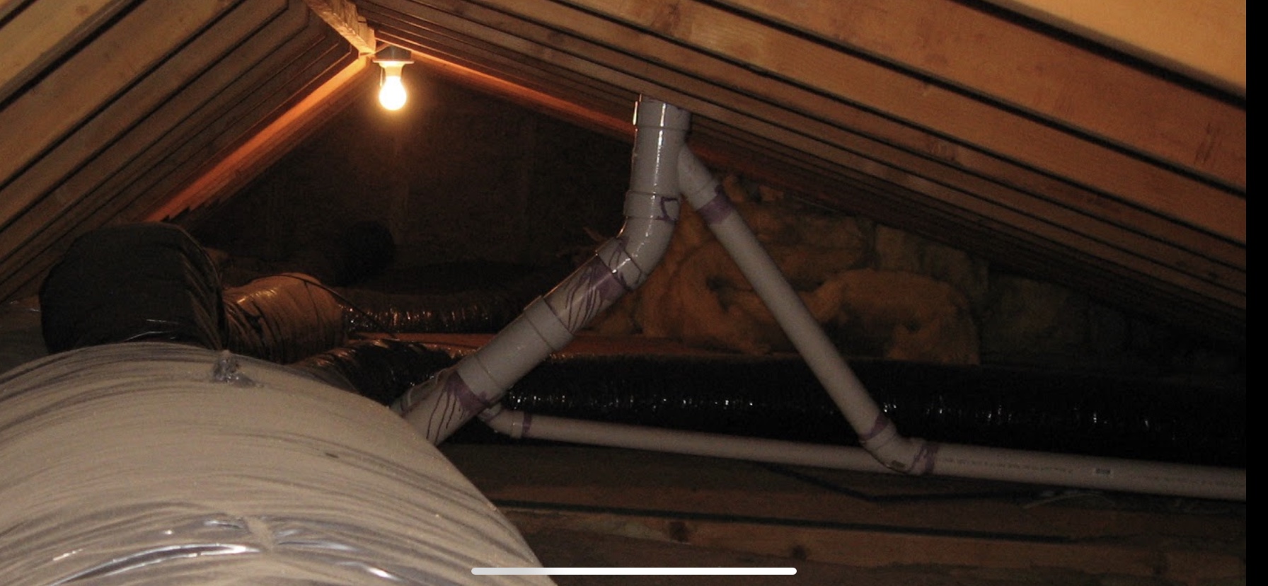

Tied all the vents together in the attic, and have only 1 roof penetration. I did not want multiple roof vents, since pipe is cheap.
Found this picture that shows most of it coming together.
Pipe on right front comes from kitchen sink, one behind it is from upstairs bathrooms, one behind on left is from basement bath and laundry, and left front is the main stack vent.
   / This day in 1997, of my house build #383
I ran our two bathroom fans into one vent pipe and plumbed it up near a whirly bird roof vent. I had to go into the attic and cut the pipe off just above the insulation last Winter. When used it would condense in the cold pipe and drip out of the ceiling vent....... :(
