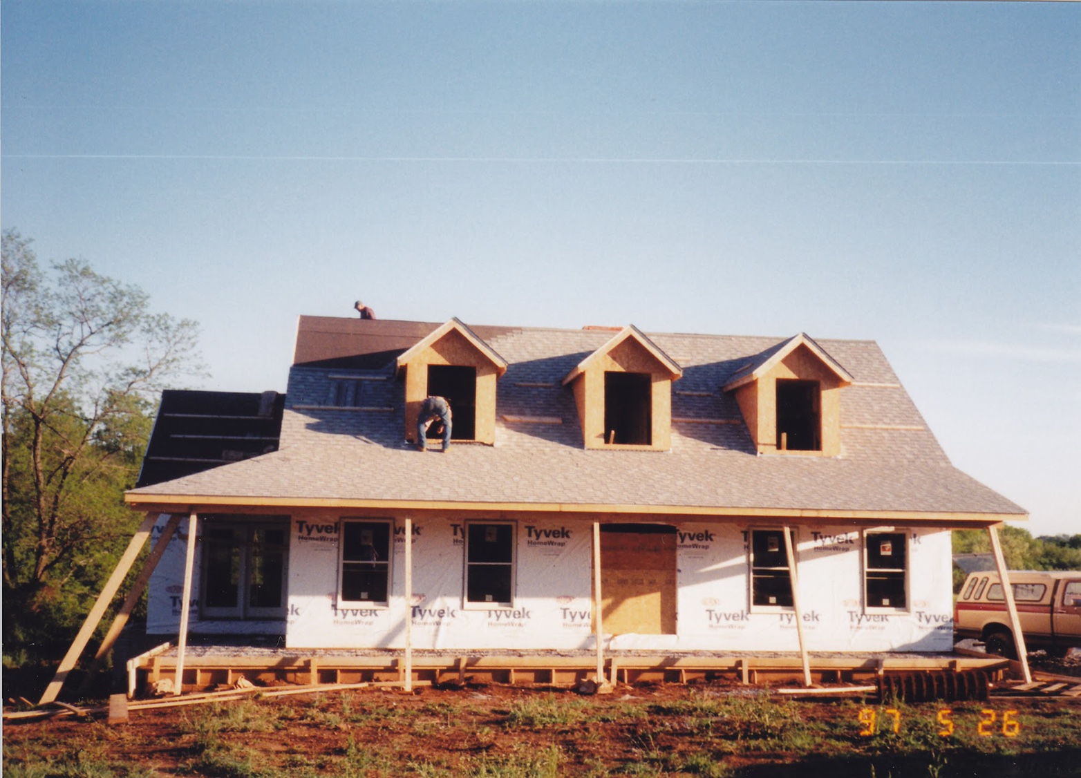

This day in 1997, of my house build
   / This day in 1997, of my house build #371
19970530 Friday
After work
Bought cap shingles
Installs caps on dormers
Install 10 ft ridge vent.
I bought these plastic ridge vents that cap shingles go on top.
In 1997, that was new technology!!!
#373
19970531 Saturday
Basement slab poured by concrete guy, Arthur.
Poured leftover in mini pad off the porch.
Installed 5 windows upstairs, 3 front, back BR, end of hall. (One to go)
Build more interior walls upstairs.
FIL helped.
#374
19970601 Sunday
Finish ridge vent and cap shingles.
THE ROOF IS DONE!
Store rest of shingles in shed (later installed on shed, it still had felt on)
Work on master bath walls.
#375
19970602 Monday
After work
Start electrical (panel is already hot and I have one outlet in basement)
Start nailing on outlet boxes.
#376
19970603 Tuesday
After work
Start pull romex in kitchen.
#377
No work on the house on the 4th.
Did mow at house and at the lot.
#378
19970605 Thursday
After work
Pull romex 1st floor
Former coworker Bob helped 2 hrs.

#380
19970606 Friday
Took day off work
Insulation company came to give estimate
Pulled rest of first floor wiring.
Bob helped 4 hours.
Put basement slider door frame together, it wouldn’t fit the hole.
Had a PT 2x8 frame in the pour to create the hole in the poured wall, so I removed the top and replaced it with a PT 1x6, shimmed the ends on top of the edge boards.
Looking at it now, wouldn’t of had to shave much off to get it to fit. Right side is ok, left side is real close.. never did insulate around the door frame apparently from tonight’s pic.
Would love to replace this slider with a French type swing door, where the other side could open to get large items in basement.
As it is, if I need larger opening I unscrew the top door stop and can remove the sliding panel to get more width. Had to do that recently to get an old freezer out, new one in. Really easy to do.
If I need more space, I can then remove a few more screws and the fixed panel comes out.
