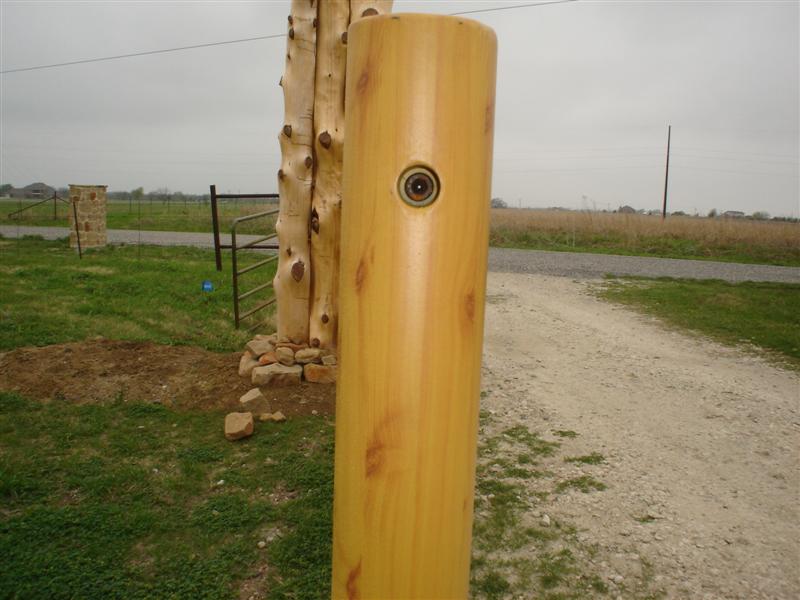

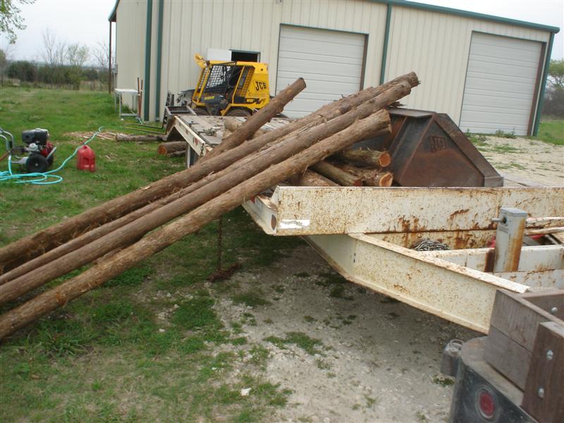

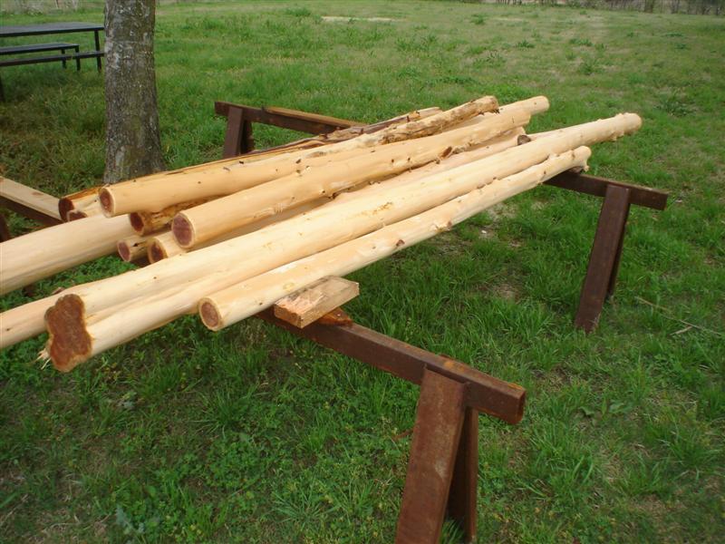

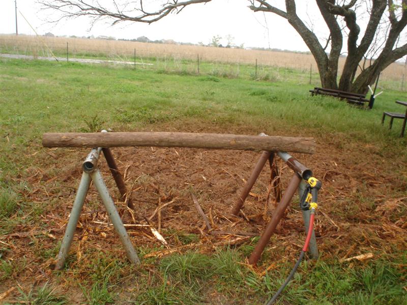

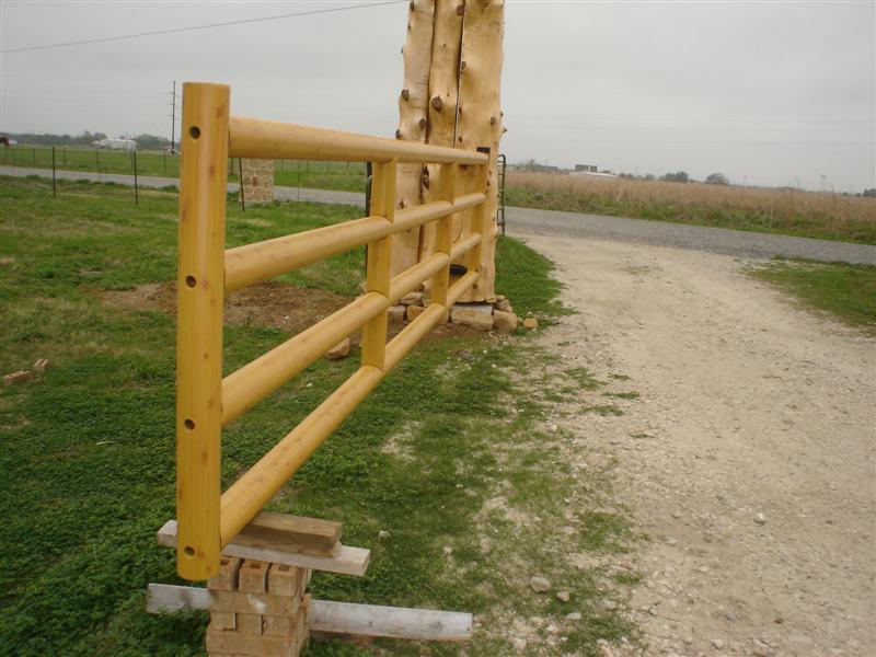

I've been working on this, that and the other. Yesterday I power washed the cedar logs Glenda and me pulled from the woods last Sunday. They're going to be the rails between the metal posts I custom made for the job and then had powder coated to match the gate.

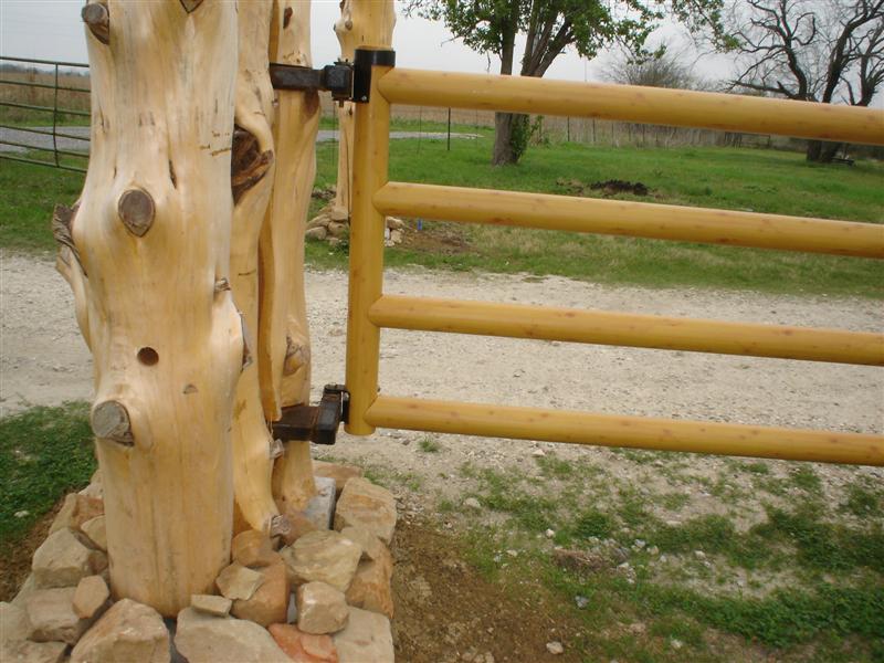

I gotta ask..... in your second pic, end view of your gate, is that a socket head bolt I see in there??? Just wondering why you didnt use stainless ?
BTW very nice lookin gate !!!

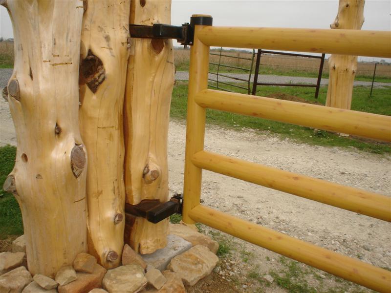

Those bolts will be covered with wood plugs.
There are ten bolts holding that gate together. Two come in from the bottom rail through the middle supports into the top rail. Then there are eight socket head bolts coming in from the ends.
I'm worried about over time the natural flex of the gate causing a weld failure. The last thing I want to have to do is have a piece taken back down to bare metal after a welding repair to be repowder coated. So I'm building a truss that will remove that worry.

Harvey, that gate and entrance just keeps gettin' better and better. I think you are really using your head about not welding up the joints. One weld repair and the whole gate would be blemished.
