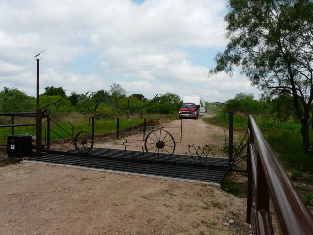

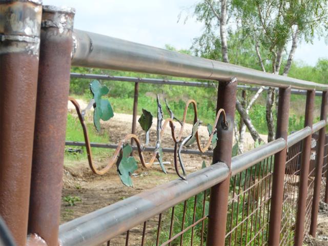

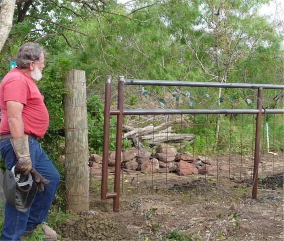

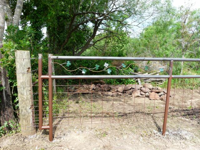

These past eight days have flown by. Today was bye day. But before Harvey left he started to put the icing on the cake. Remember the leaves I traced out on metal and Harvey cut out and Bobby and I welded stems to and the Harvey forged curves and texture to last week, (breath), well this morning before Harvey packed up, he attached a section to the entrance fence to see how it would look, IT LOOKS SO GOOD!
below are a couple of pictures with the vines, leaves and a flower, I'll post again when we have the remaining 14 sections all up and painted.
The entrance turned out perfect. We only had a rough idea going into this project but the entrance now captures the wildscapes and wildlife and like nature you have to look to see it. The added touch of the grandparent's old metal just makes it that more personal, and now there is a story to be told about the gate.
Thank you so much Harvey, Glenda, Bobby and Mike!

   / This, that, and the other #445
TxDon,
Nice looking gate you got there.
You got any paint secrets you want to share? I've got a big corral project coming up next year that will be too big to sandblast, so I'm looking for ospho or something like that to use.
   / This, that, and the other #446
GaryBDavis, I got Harvey's secrets so don't tell anyone. The galvanized hog panels were primed with Kiltz exterior oil base paint and the rusty wagon wheels were primed with ospho. No special primer was put on the other metal. Then everything gets a coat of a 50/50 mixture of Rustoleum brown rusty metal primer and Rustoleum glossy leather brown paint.
After that I might put a Rustoleum hammered bronze or copper. I pre-painted the leaves Rustoleum hunter green and the flowers will be a two tone mustard yellow. That is about as far in the future as I can see now.
