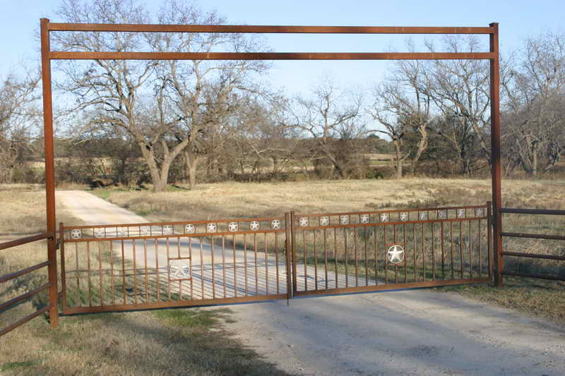

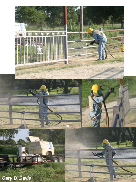

Preparation is one of the more important steps and often the key. Once you get good clean metal and a quality paint on it, you can recoat every 8 to 10 years with minimal preparation (no sandblasting). Spray it to keep the thickness down and you can get several recoats and at 8 to 10 years between, that's a pretty good amount of time.
For my corral project, I think I want to try ospho and an aluminum based paint as it blends with the galvanized cattle panels.
Gary, I've had very poor luck with aluminum based paint. It either rusts right through very quickly or it chips off easily.
Many years ago a client brushed and cleaned a pipe fence. Then they primed it with aluminum based paint. They then painted it white after the aluminum had weathered a bit. Less than a year later the aluminum was coming off in sheets taking the white with it.
You can buy cold galvanized paint by the gallon. It's expensive, probably two hundred plus per gallon by now. You have to use xylene for thinning and the first time you pick up a gallon you will think it's nailed to the floor. It's that heavy.
   / This, that, and the other #453
I've used the cold galvanized spary cans for touching up welds on galvanized gates, etc. But, I've never bought it in gallons and sprayed a large project with it. What brand do you recommend and where do you get it?
My only outdoor projects that I've sprayed with aliminum paint are about 2 years old, so I don't have much time to tell how they will hold up. But so far, so good. Maybe it's the excellent prep job I did?
