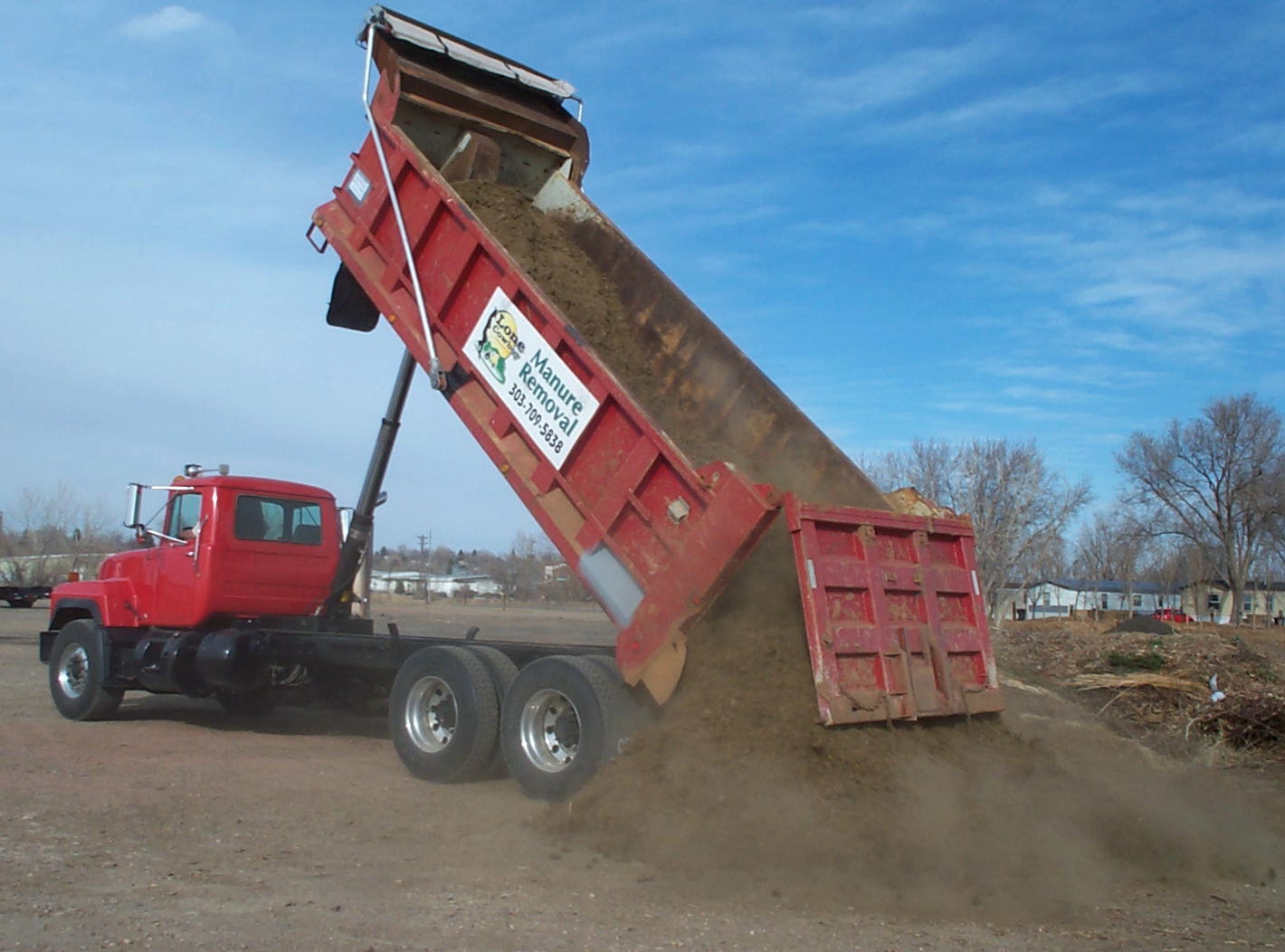

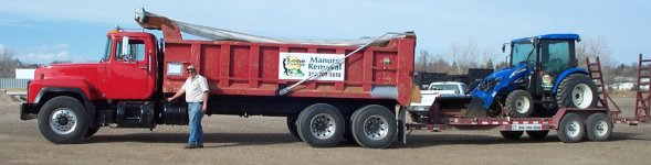

I was actually replying to the OP about air ride, and i did think he meant bags, not seats.
that thing is a beast!!!!!!!!!!!!!! :eek:
How often do you use 4x4? Does it have low and high range 4x4 or what?
My wimpy little Mack. I'm 6'1" tall to give you some scale.

I agree, Builder, that truck is a beast. Sure it would do the trick, but I'm sure you had to pay the price too. Justifiable if you are using it all the time.

It wasn't as bad as you think. :)
You might be surprised how little I have in it. :)
Oh, that Mack isn't wimpy. I've driven enough of them to know the older ones were THE site truck. I was this close (fingers 1/4" away from each other) to buying a MACK 4WD from a guy in Michigan. It was a 300HP with super singles all around, but the sheetmetal had too much surface rust.
I use the 4x4 often enough to justify it, that's for sure. One of my first jobs was running fill down into a swampy area to build up ground for a nursery. The nice thing was not having to be pulled out like the 4x2 trucks. I still take fill down there, but there's plenty of dry ground to turn around.
The 4800 has both high range 4x2, high range 4x4, low range 4x2 and low range 4x4. It has an airshifted Fabco transfer case to give you the high/low range.
I really want to upgrade to a tandem all wheel drive, but I can't find a buyer for my 4800.

What i still dont get is why you guys buy long nosed dumptrucks with a huge wheelbase: You'll need more ground clearance to get over the same hilltop, a longer frame is heavier which means less payload, and a long wheelbase takes a lot of space to turn it around.
