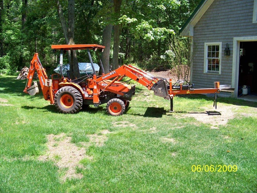

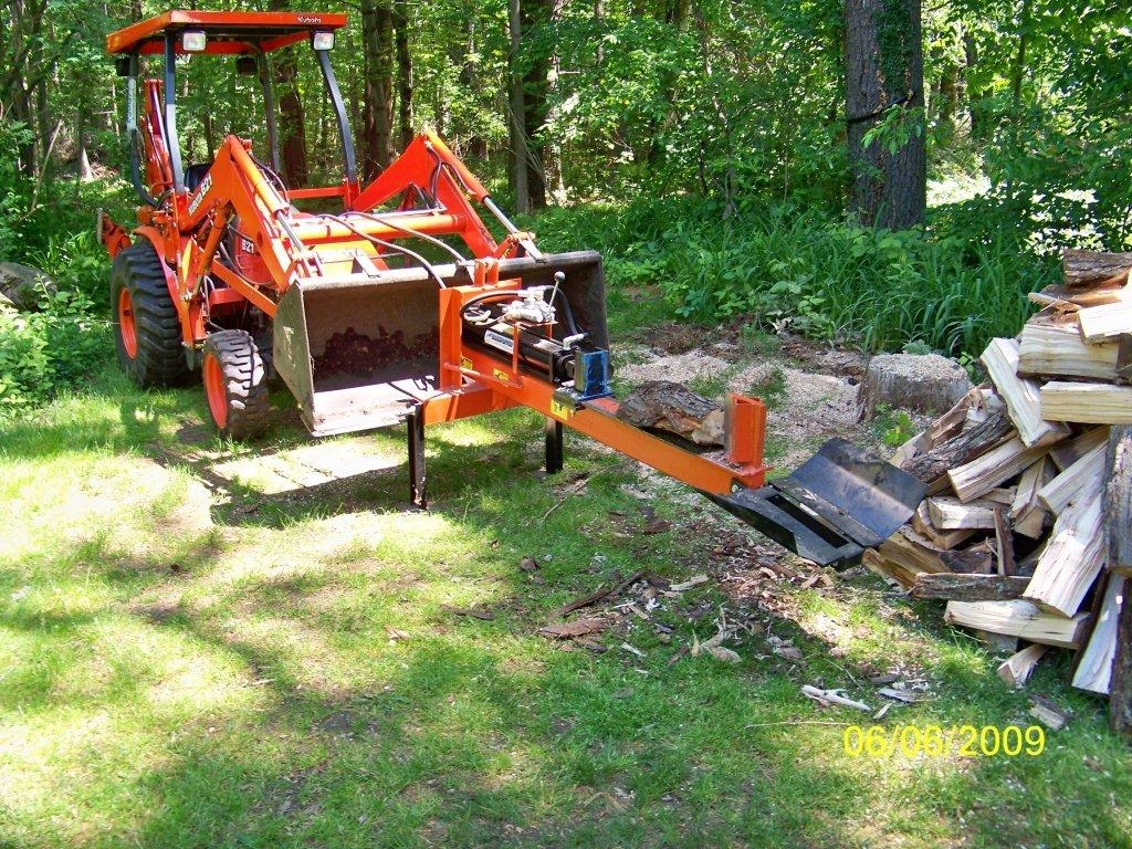

I use a 3PT splitter on my FEL with hoses to the BH connection. Use the BH to lift and cut 20-30 rounds then connect the splitter hoses and run at 1200 RPM. I can do a 1/2 cord in 3-4 hours. Also can lower the splitter to the ground to load large rounds.

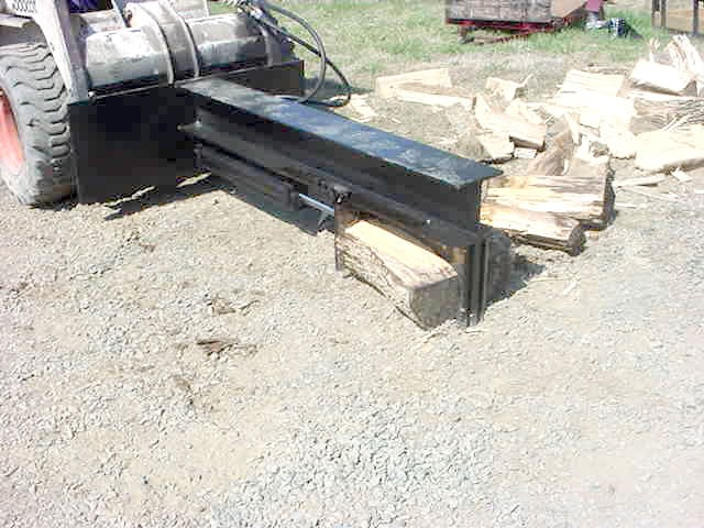

I have a Bobcat mounted splitter like the one in post #30. I bought it because I had a lot of really big (up to 3 foot diameter) rounds that a local contractor dropped off. How to split them? Cut lengthwise with a chainsaw? Lots of wedges and a lot of hammering? Dynamite? The mounted splitter solved the problem. I can bring the splitter to the log and I don't need a crane to lift the log. With a gentle touch, I can even use the splitter as a grapple to pick up logs if I need to reposition them.
That said, I still find it more convenient to use the stationary spltter for any logs I can lift by hand.
I suppose this type of splitter could be mounted on a FEL if it had the Bobcat style mounting plate and an auxiliary hydraulic connection.
