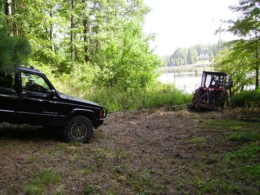

Yep,
40hp with R1's. Gramps always said "If it's got tires, tracks, or hoofs it will get stuck".
