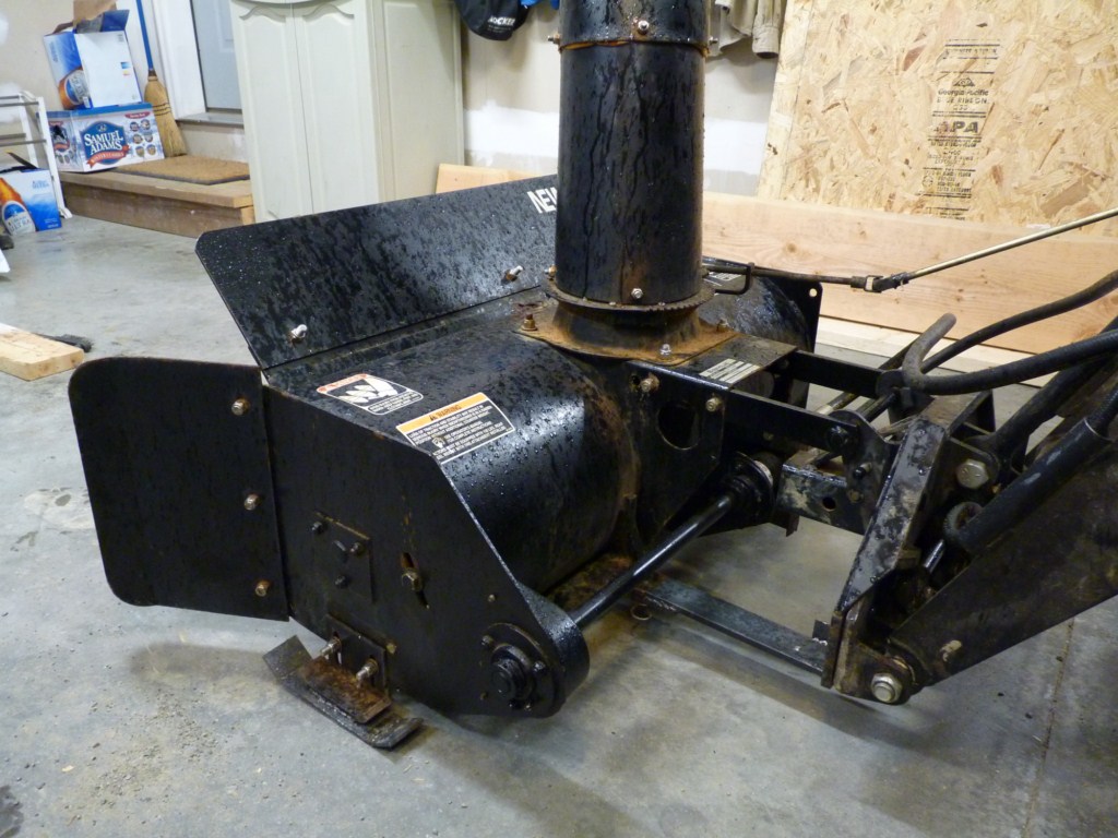

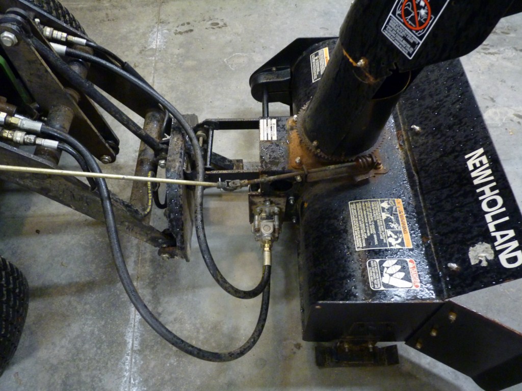

The .58 cu in finish mower motor directly coupled to the drive shaft (ala duane's conversion). I won't be surprised if it struggles with heavier snow, but if it handles the deeper, dry stuff it will be worth it. I use an ATV to plow my driveway now and it works pretty well actually, but having the snowblower for certain situations would be nice. Deep powder is hard to clear with a small ATV plow since it spills over top and out the wrong side.

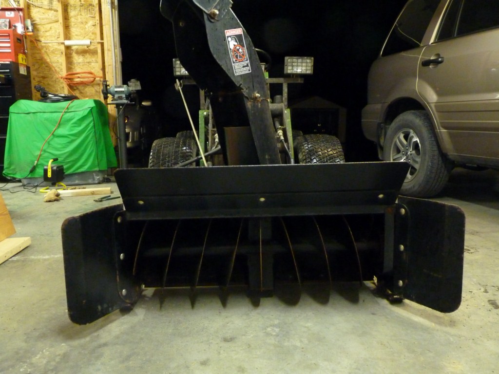

Okay, I'm pretty much done. The only thing left is spraying some paint on the bare metal. I'll describe what's in the pictures: I used my PT receiver hitch QA plate for this project. It can be still used just fine as the receiver hitch since the snowblower can be easily disconnected from the mounting bracket. The bottom portion of the snowblower also attaches using a hitch type pin on both ends of a brace I made. I tried to keep it as simple as possible. The finish mower's hydraulic motor connects to the drive shaft using love joy style couplers. I also increased the size of the stock skids so it hopefully rides better on my stone/dirt driveway. That's about it. Thanks for all the help! Hopefully I can take a video once the snow falls. Here's the pics:
