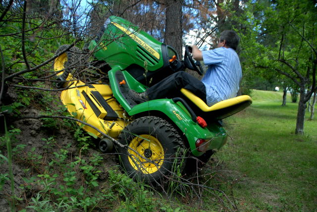

Dude,
Congratulations on your X749 decision...
I love mine! It is great for mowing in hilly terrain. It is very stable and has excellent traction. The All Wheel Drive means that I don't have to worry that it is in 4WD when going down a steep slope, its already there.
However, I think it is best for mowing duties. If one can afford this and an SCUT for other duties, it is great to do loader work in the morning, mow in the afternoon, and do more loader work later in the afternoon without swapping implements. Just grab the tractor that is set up for the job... Sure, maybe one can put a mower under an Scut with loader attached, but that would not be as maneuverable as the X749 alone.
On the other hand, the high position of the X749 mower deck does not allow for a lot of ground clearance. I would love to raise it another 2 to 4 inches. In areas where I need the clearance, I use the 2520. Because I have the 2520 also, I don't worry about what the X749 can't do like an SCUT. I just use it for what it does best, and use the 2520 for what it does best.
You should love the X749...
