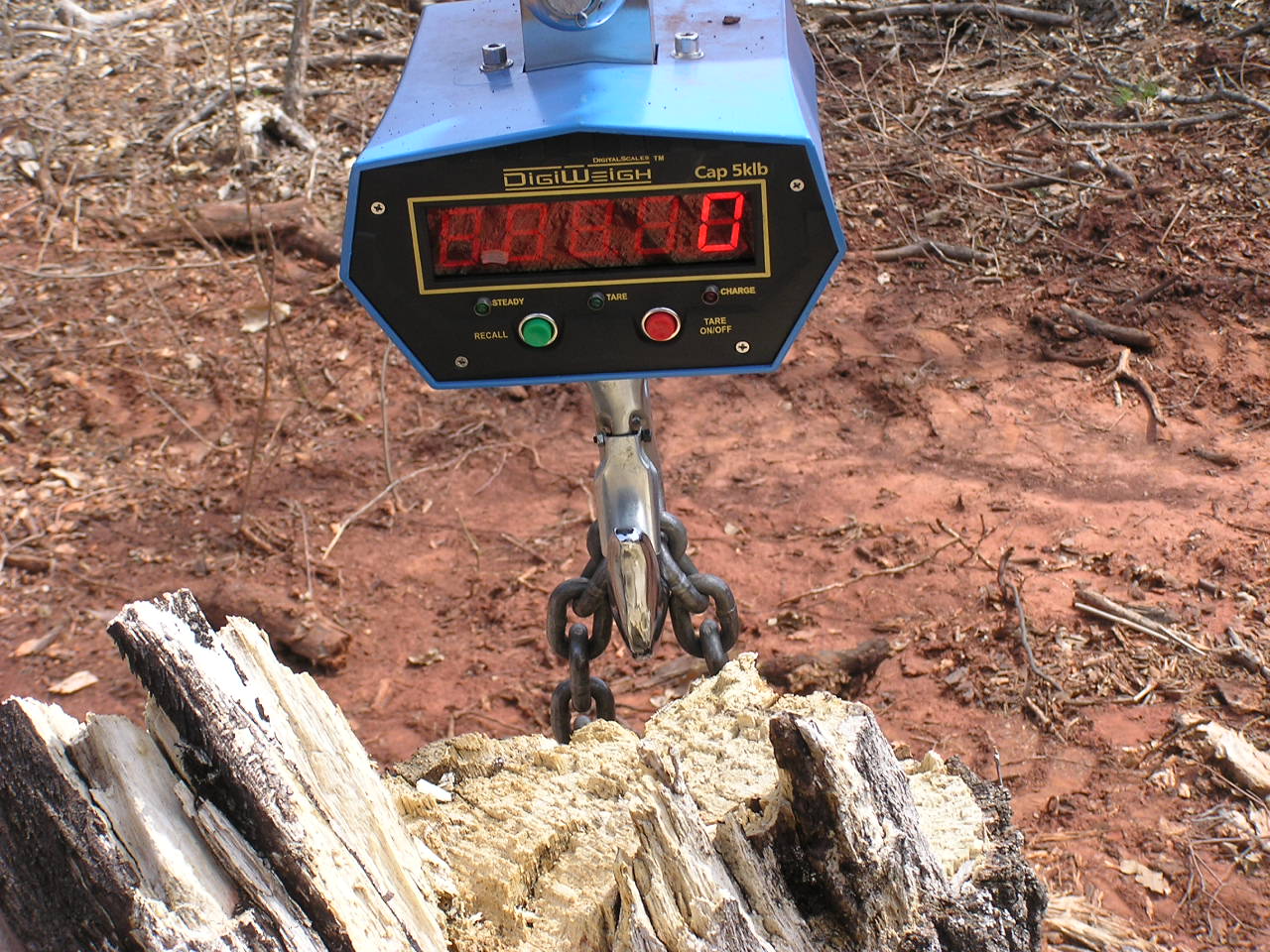

From left field, a chain come-along.
Just a brief FYI on thse, I looked for sources for them and except for a china-madexknockoff on The Sportsmans Guide, they were amzingly expensive where you can find them at all. There are hardly any used ones at all, and no one other than the shaffer co seems to make any at all.
It's a shame too because they seem like such a great idea.
I need to hook the chain come-along to my crane scale and find out how much pull I can get with it.
