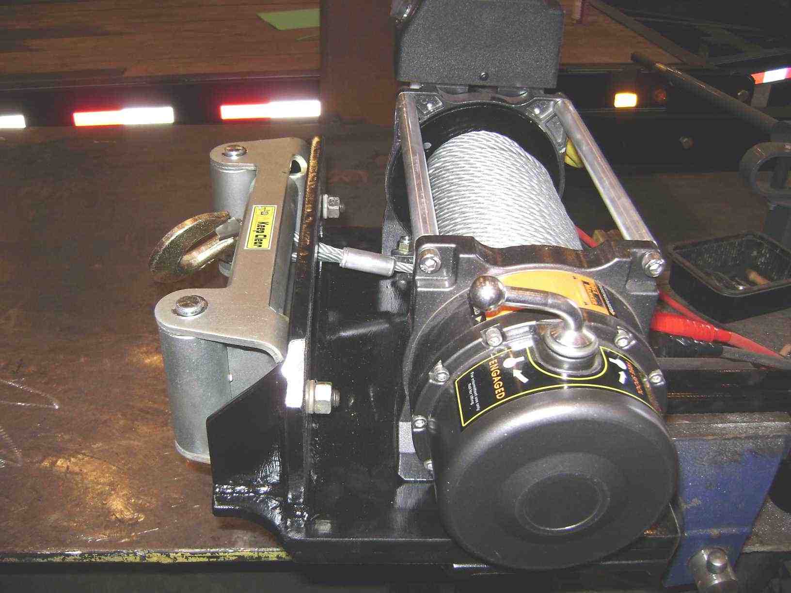

Very few times a winch will be preferable to simply hooking up and dragging the item. I can imagine when traction is not ideal you could jam the bucket in the ground and pull (cable grinding over the bucket?) with the winch. Or will you elect to just use a longer chain and move the tractor to better traction? Or use a cable and a snatch block for more pull?

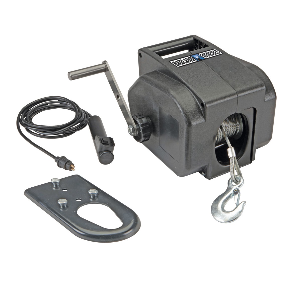

I bought this 2,000lb HF portable winch for $79
it's a piece of junk. Then it fell off the trailer tongue (16 inches to dirt) and broke the case before I was able to return it. Also you don't get the rated pull when the wire is stacked up on the coil, so you have to pay it out all the way to get rated pull, which is time-consuming with a slow winch and will compound your frustrations in actual use.
And then you have to re-wrap the cable in an orderly fashion, while bending over the FEL bucket and trying to push the right button. Try to enact where you will stand while holding the button and aligning the rope, while solo. And then consider it's slow. That thing will have you over a barrel.
Sorry to rain on your parade, you know I like projects. But with the little I know about small electric winches I'm not inspired unless it's totally troublefree and along for the ride (as on my ATV).

Your comparing something different than the OP bought that you mishandled in a position it may not be in. And he only paid $59 plus shipping, not $79.
<snip>
2500 lb. ATV/Utility Electric Winch with Wireless Remote Control
Don't think I will use it too often so don't really want to invest too much.
Let him mount his and report back.

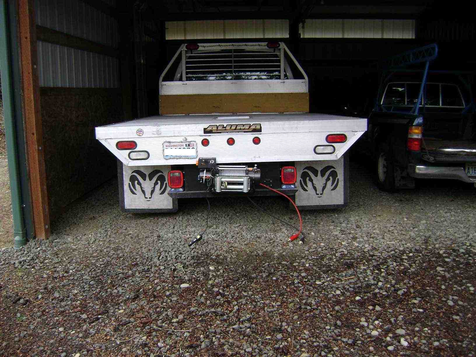

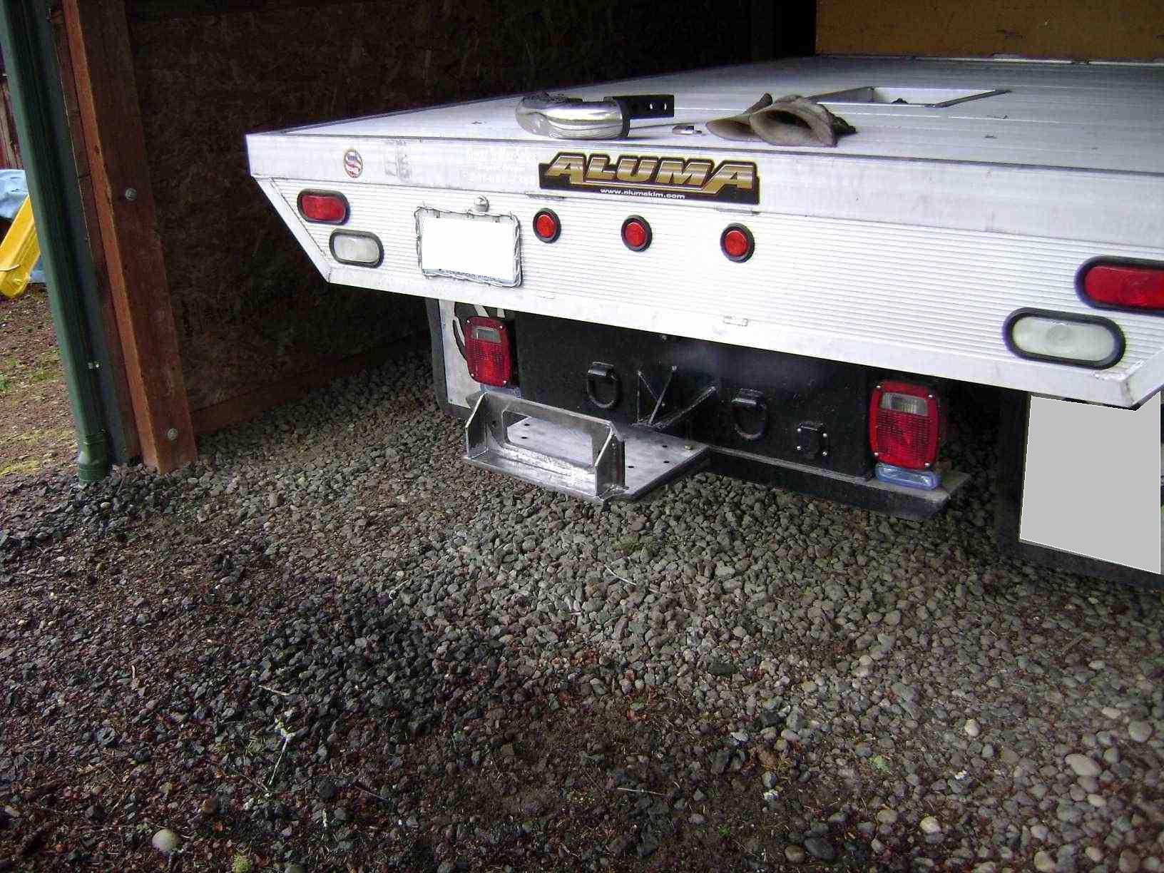

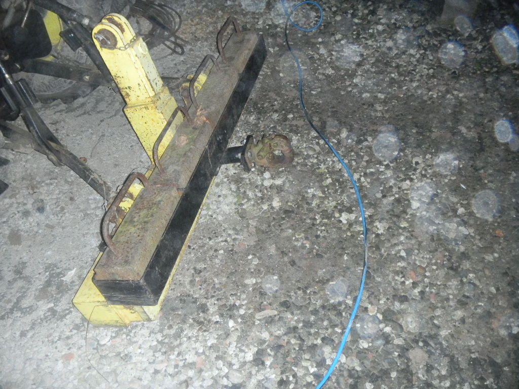

What would you think about mounting a trailer hitch receiver under the front bumper, and under the hitch in the back of the tractor. Build a winch mounting stinger, then you could have a winch in the front, or back of your tractor.
Or maybe install a pintle hitch on the counterweight, and have a hole in the winch mounting plate that would pin to the pintle hitch.

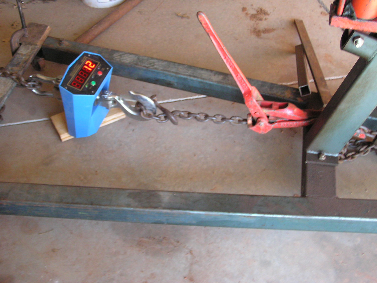

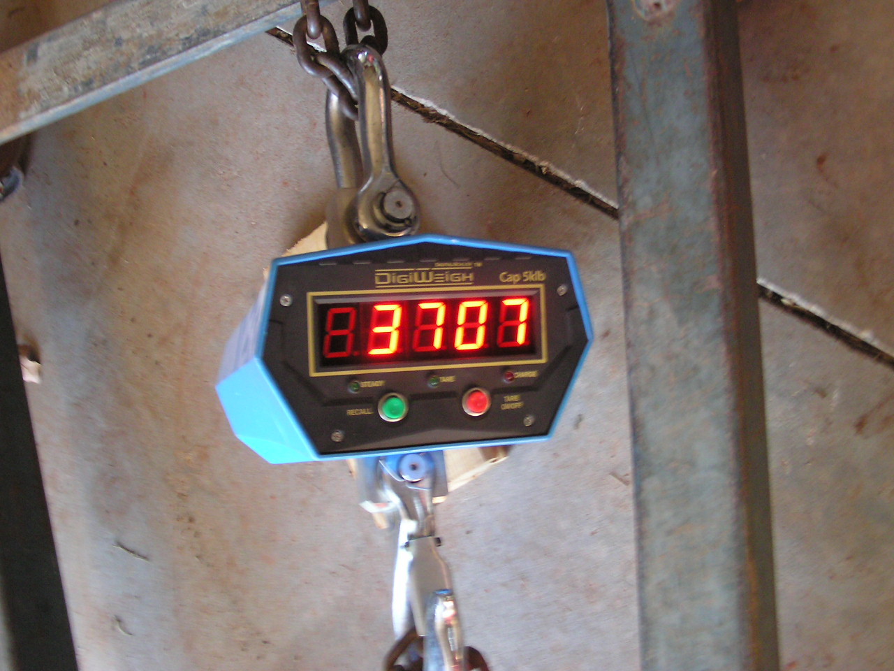

I need to hook the chain come-along to my crane scale and find out how much pull I can get with it.
Well I took the time to test the Standard Chain Come-Along and easily exceeded the working load limit of 2750 pounds! JE Shaffer Co.
   / Thoughts on mounting a 2500b winch on BX? #78
Those chain come-alongs are obviously well over engineered, but for the $375+ I found them listed at, you can buy an electric winch that has a much higher pull rating, granted that's only good if you have power available, but it's too bad they aren't available somewhere for a little better price.
CL here I come again!
