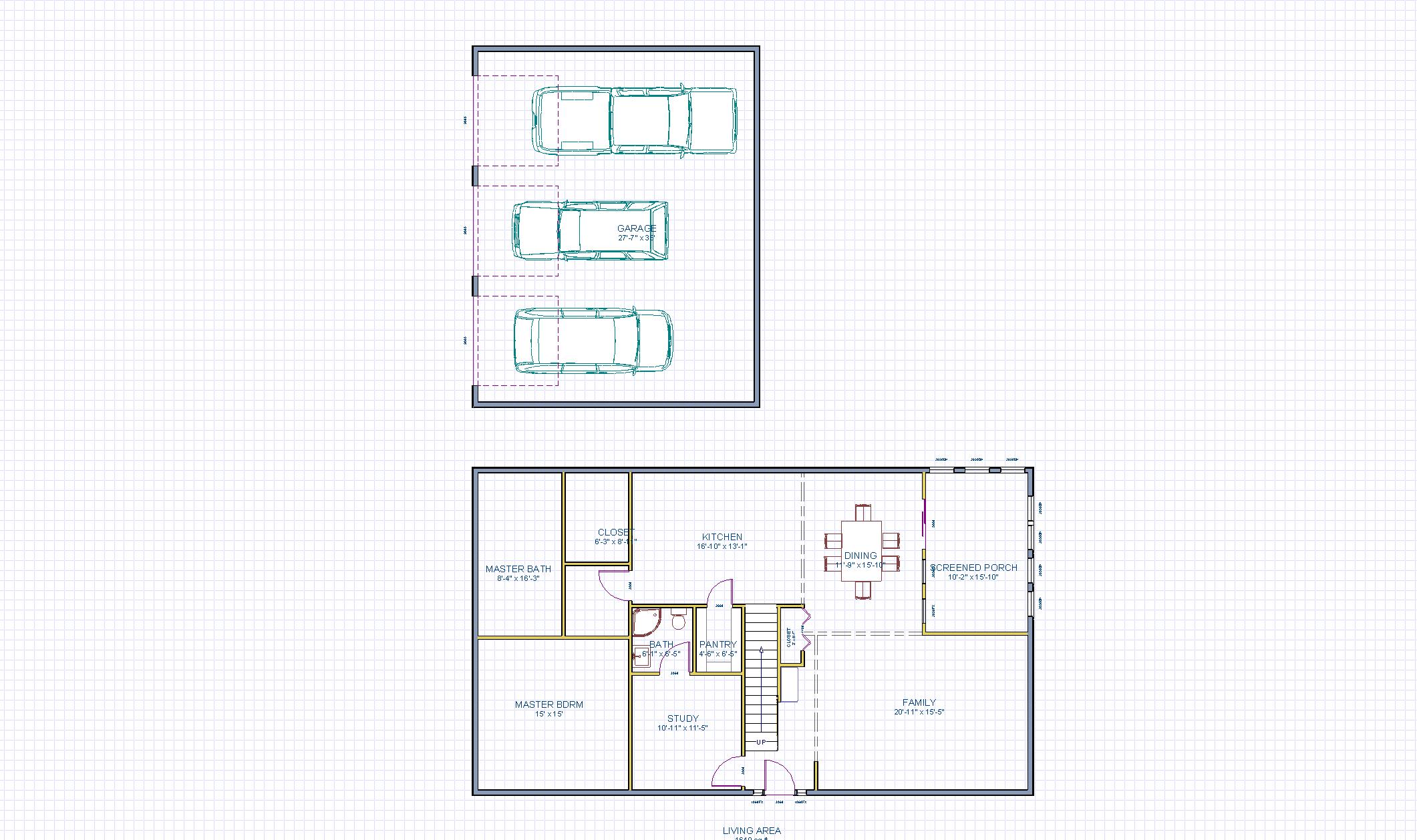

I was able to take some time this afternoon start over again. Dmcarty, I agree with you about the grid paper. That's where we started months ago, and we like the overall layout, so it's going to be hard to move away from the general idea. Besides, it feelsfaster and easier to use the drafting program.
Anywho, considering things like room sizes, efficiency, cleaner exterior lines, and open layout, here's where I'm at so far. I like the arrangement of the entry, family room, dining, and kitchen. I also like making the sunroom into a screened-in porch instead and pulling it under the main roof.
I don't have a clear idea of the master suite nor the mudroom, yet. I intentionally left the garage separated from the house, but oriented and lined up in an "L" shape. Somehow there will be a mudroom/laundry that will connect the two.
We're going to try to stick with a 2-story. I spent a lot of time the past 2 days perusing E-plans and I have a concept in mind. Like one of you said, the second floor will depend on the first, so I'm working on it first.
BTW, ignore the dotted lines. They're put there by the program to calculate room sizes.
If you want to move furniture to the upstairs, that offset between the centerline of the stairs and the front door will cause issues. The bottom of the stairs is too close to the front door. Bump the front of the house out 4' all the way across and that will give you a larger master bedroom, a larger study, a larger front entryway and a larger great room.
If you have a party, where will guest's pee? They will have to go through that study or through the dining room and kitchen and use the master bath. You want the master bath for the master, not the guests.
I do like this layout better than the first. :thumbsup: Good luck with the planning. ;)

I second the notion of adding 4' to the front.
I would also consider re-locating the bathroom. Having to track through the study to use the facilities isnt something I would like. Instead, I would condider something like this....
Where the current bathroom is, make that the closet for the master suite. and re-locate the bathroom to an area where the closet is. Or even downsize the kitchen a tad. That kitchen is HUGE especially with having an open dining room with no walls between it and the kitchen. This will do a couple of things, it will give you a bathroom right when you enter from the garage. And also keep the plumbing closer together so your runs arent as far. And this bathroom really only needs to be a toilet and sink. I wouldnt see the need to have a full bath since I "assume" the master bath will be a full bath and "assume" that the upstairs will have its own FULL bath. All you really need is a guest restroom. And no shower is necessary, and tracking through the study I wouldnt want.

We'd like for the study and associated bathroom to have a dual purpose. My in-laws don't do well with stairs. My parents are younger, but someday probably won't do well with stairs. That's always going to be the case for some guests. For the most part we'd like for the study to be just that, a quiet sitting area with some chairs and books. Something nice to see when guests arrive. We were thinking it would have a Murphy bed and the bathroom would have a shower for when guests that can't really use the basement guest room come over. I have a friend in town with an almost identical arrangment in their house, but I haven't seen it in a while. I might go over and look at it sometime and see if I can replicate it. If I recall, they have a front area with sink that attaches to the entry hallway, and then there's a back area to the bathroom with toilet and tub that also attaches to the study/guest room that is at the front of the house, just off of the front door.
