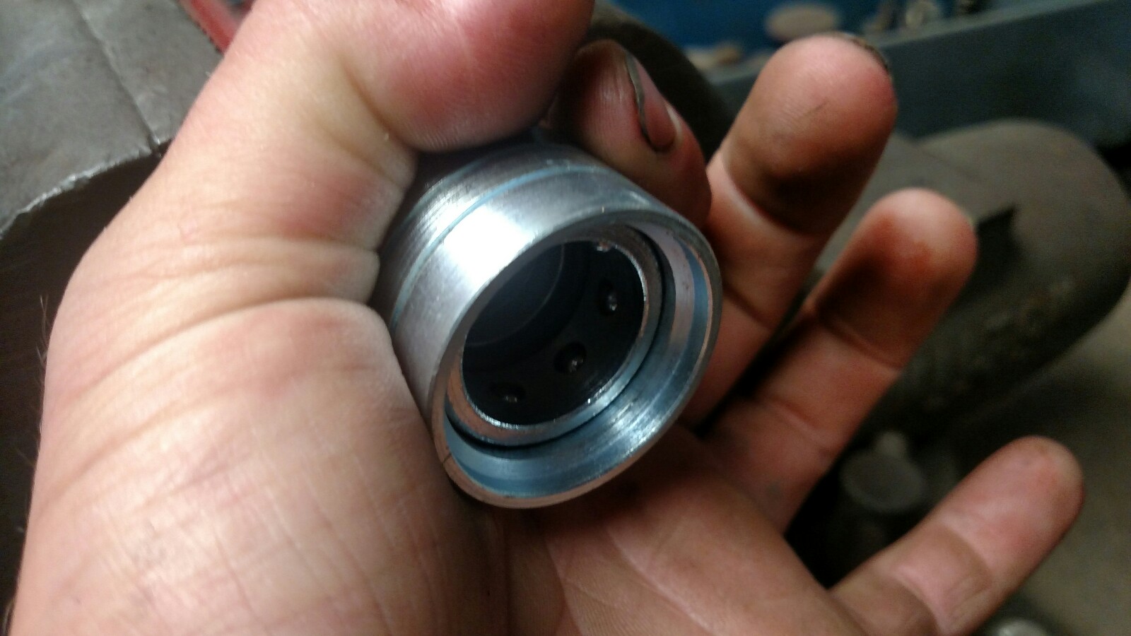

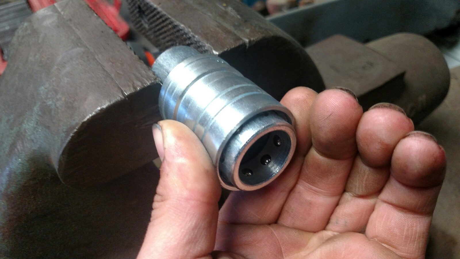

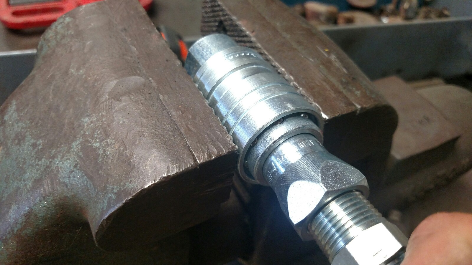

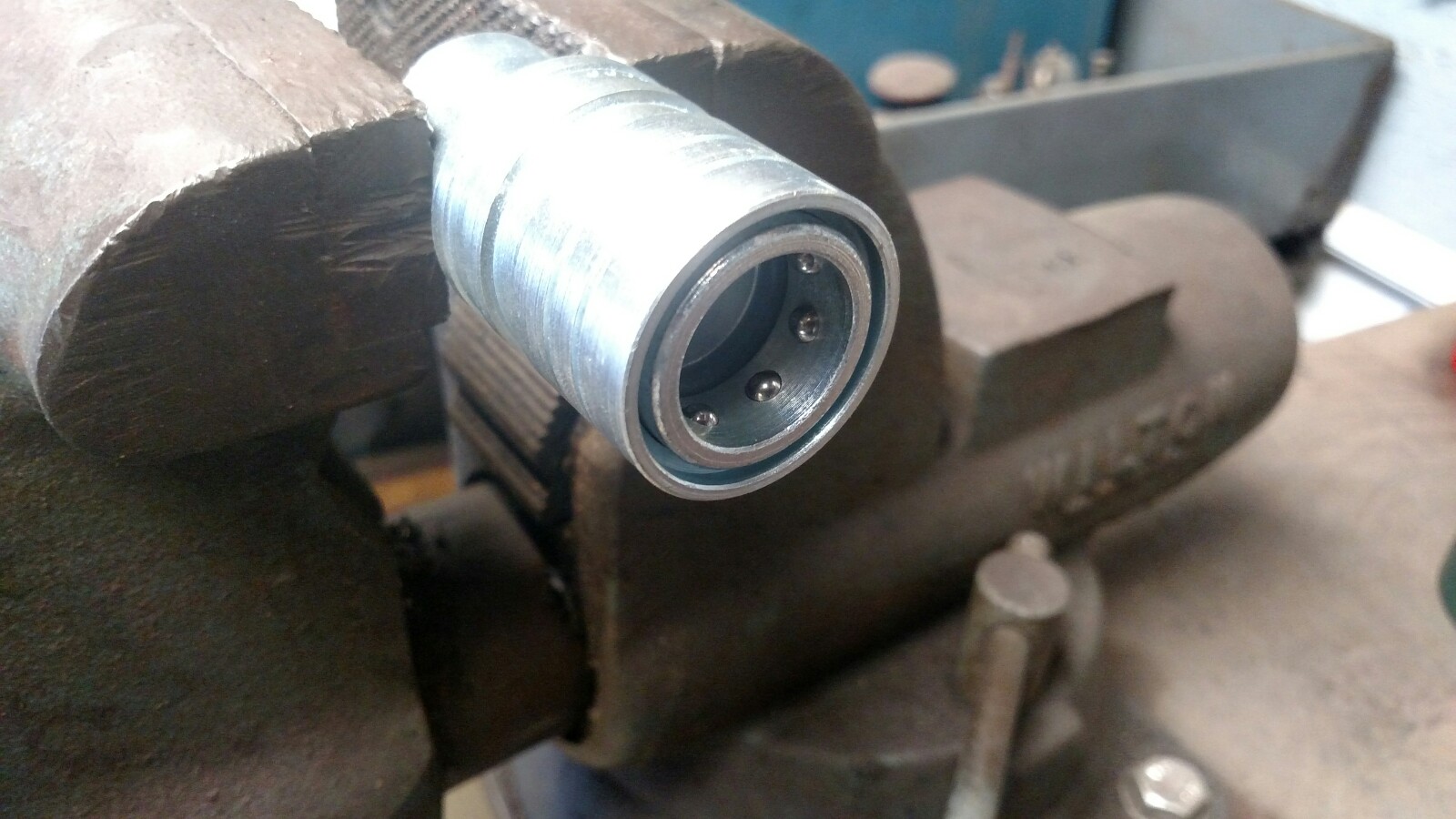

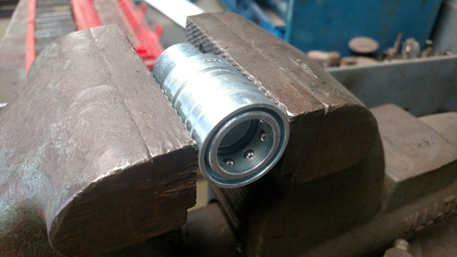

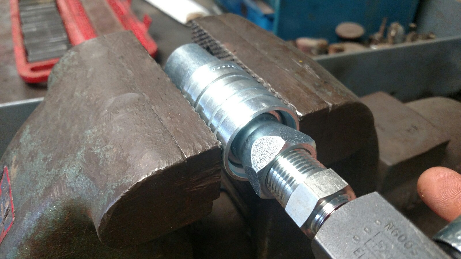

Here is the two-way sleeve coupler
You can pull the sleeve back like normal
Now what makes it a two-way:
If you mount via the sleeve (either with a clamp or snap rings in the grooves)
You can take one hand and just pull on the hose connected to the plug, as with the body free to move and sleeve mounted...it's the same action as pulling the sleeve back but can be done only with one hand, and thus also provides breakaway protection:
The two way part allows you to use one hand and just push the plug into the body (again, if mounted via the sleeve). This action is the same as if you were to pull forward on the sleeve:
Hope that clears it all up
Very good explanation and photo series. :thumbsup:
