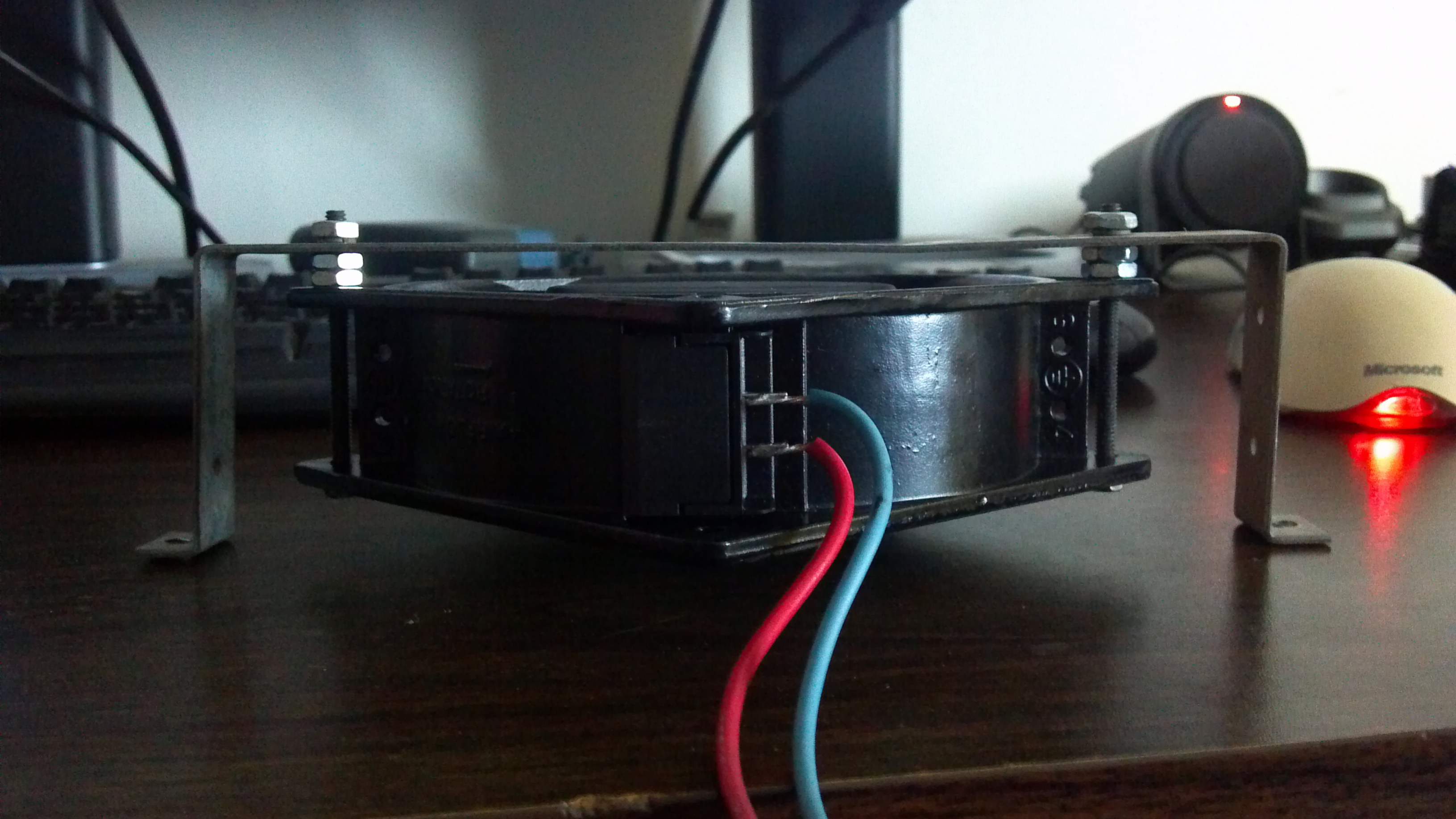

Well, I'm back from my trip, and I have a small update. I got the new fan installed! It came with no leads, so I just soldered on the leads from the dead motor. I will always be thankful to my dad for teaching me to solder years and years ago. It has come in handy more times than I can say.
I had to put the fan on the opposite side of the mounting bracket, in order to leave room for the amperage slider to go up and down. To keep the airflow going the same way and to keep the fan from rubbing on the bracket, I shimmed it out with some extra nuts that I had laying around. I also re-used the bolts that held the original fan on.
On suggestion of the Internet, I also rewired the fan so it is on the service side of the welder's main switch. This keeps the fan running even after the welder is shut off, so that it continues to cool the transformer. I find this particularly useful because I usually turn the welder off in between rods, just to keep any little accidents from happening. I know this may not be strictly necessary, but at least until I am more familiar with the process, it makes me a little more comfortable.
EDIT TO ADD: An additional benefit, at least while I'm jacking around inside the darn thing, is that the running fan serves as a reminder that the welder is plugged in, and the service poles of the main switch are hot. At least once, I have gone to reach inside the box while it was plugged in and had to smack myself when I realized what I was about to do.
Here it is, working away!

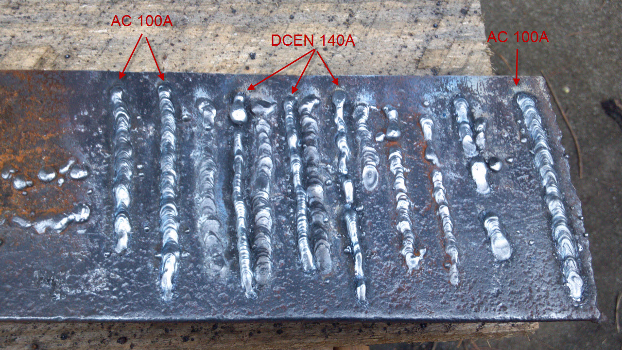

Also: now that it's the 1st, I have a bit of pocket money again, and will probably buy an auto-darkening helmet. Maybe also a small box of fresh rods, just to rule that out as a possible cause of the DC problems.
   / Thoughts on this used welder?
#120
I got an auto-darkening helmet today, and boy howdy is that a treat. Only thing is, now I have to remember to make sure it's turned on again when I get done grinding. There's an accident waiting to happen. Maybe I should use a different face shield when I grind. So far, I just look away and tap the work piece to confirm that the lens darkens before I start welding in earnest.
Anyway, here's today's work.
I went out and bought a brand new box of 1/8" E6013 just to rule out bad rods as a source of my DC problems. All of the above beads were run with those rods. I was able to consistently get a DC arc struck, but I had to run the welder all-out at 140 amps to do it, which seems higher than would normally be recommended. The DC beads also seem taller than they should be, to my amateur eye. Bear in mind this is on a piece of about 3/8" thick T-stock, if that's relevant. On the AC side, I think the 6013 runs a little nicer than the 6011 I was using, although the auto-darkening hood and my slight increase in experience probably play in.
