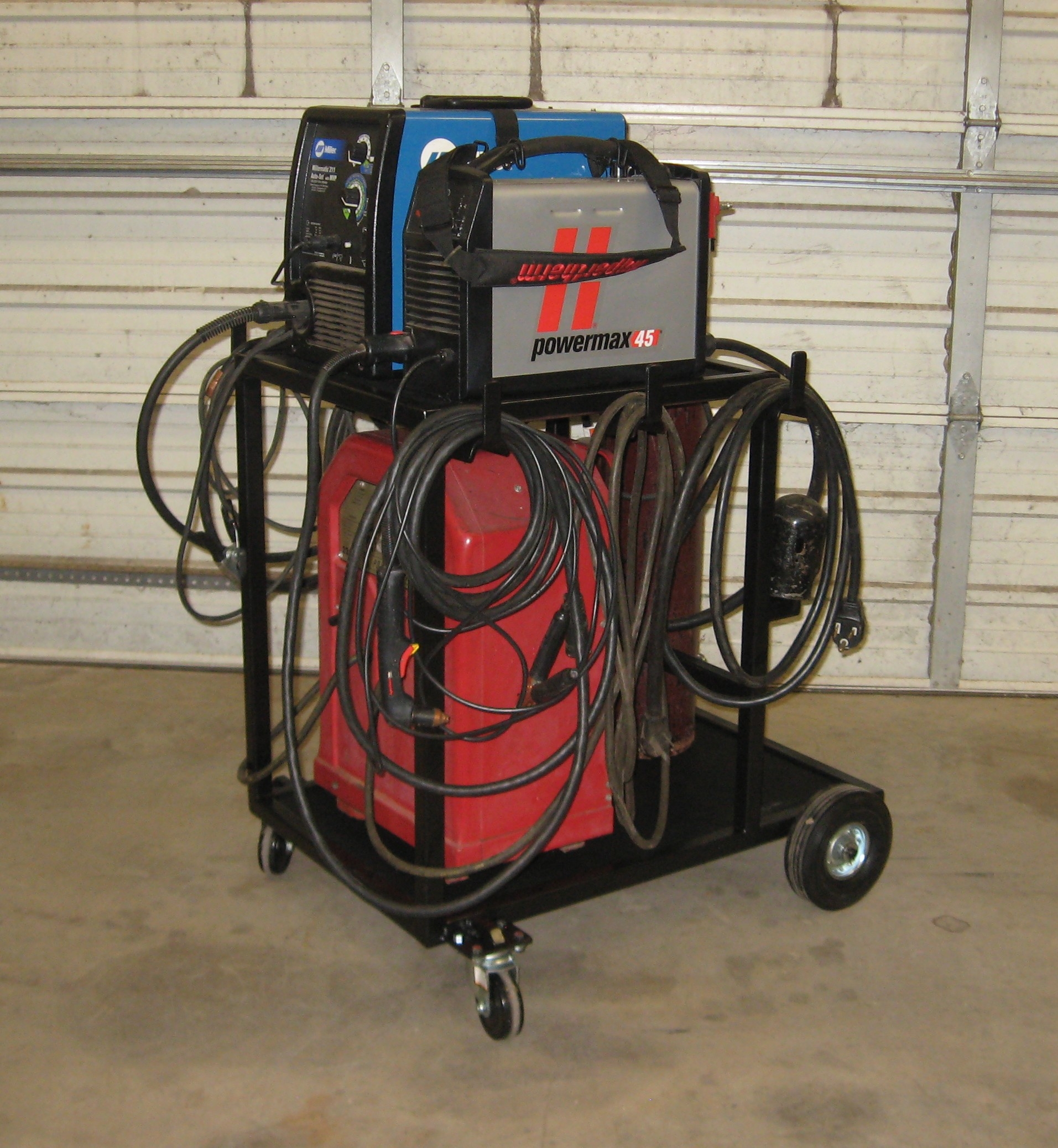

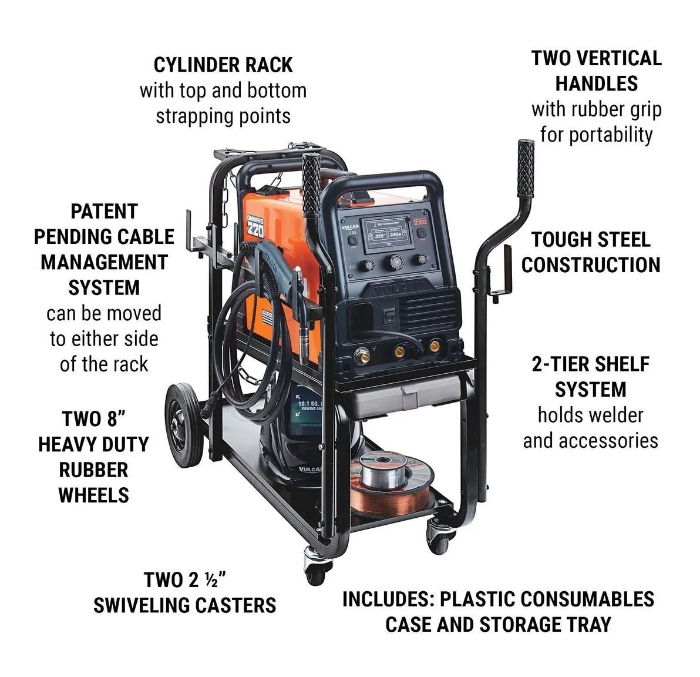

You bought large Vulcan cabinets, and I made it clear I was talking about a small Vulcan similar to the Miller. I will attach a photo.
The big Vulcan looks very nice for a person who wants three machines on one cart, assuming the air space is adequate for ventilation, but I chose shopmade carts because it was completely wrong for me. It takes up a vast amount of room, the drawer storage is lacking, and it sets the machines down too low.

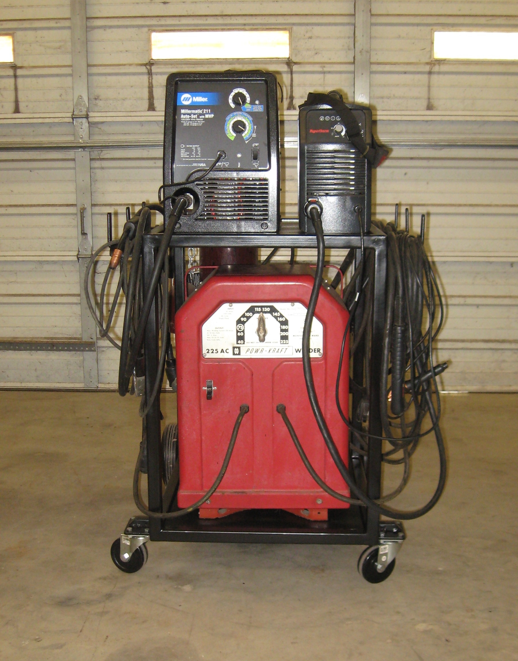

Most people will not want to put three machines on a cart or have to deal with a monster 4 feet long. I wanted a cart that held two machines and two large bottles, and I wanted TIG rod storage. With a total of 4 machines, I would have to buy two large Vulcan carts to get all that. I wouldn't want to push and store one of those boxcars, let alone two.
I now have two carts just as I want them. One is set up perfectly for a welder and a plasma cutter. The other was made for two welders. They are extremely strong. The thick tubing in the bases runs all the way across them. The casters are much stronger than they have to be. They roll easily with one hand. The machines are right at eye level. I have hundreds of pounds of stuff in the drawers, kept clean and neat where flying crud can't get at it. The carts are very easy to maneuver and store. As you can see, I put a trapezoidal base on the cart in the picture, making it very resistant to rocking and tipping.
Incidentally, I got the idea for my carts by looking at products from a company called All-A-Cart. They make kits to turn factory-made boxes into welding carts. The name is ZTFab. They cost a great deal of money for what you get, and they send you steel parts you have to weld together, and paint, yourself.
I couldn't understand why anyone would buy these things; especially a fabricator. Their original kits cantilevered their tank platforms from existing caster screw holes. No additional wheels. That meant the heavy tank on a ZTFab cart was unsupported from the far end. Really bad. My design runs from one end of a cart to the other, supporting it the entire way. Current ZTFab kits, which cost $260 without the tool cart, have added wheels under the tanks. They still don't sell frames that run from end to end, so their kits put a lot of stress on those Chinese holes.
At the same time they were selling these, Youtube was full of videos of people making better carts from tool chests. And it was also full of people who got free ZTFab carts and claimed they were fantastic. They made videos of themselves putting the carts together. Free ads for All-A-Cart, which says something about Youtube creators and how easy they are to buy off.
My first cart: $230 for the tool cart (2020), around $100 for steel, paint, and parts, indestructible frame running the length of the court, two huge bottles supported firmly: $330 plus incidentals. And it was exactly what I wanted, so no compromises.
ZTFab: $260 plus paint plus welding and grinding, plus shipping, plus $240 for the cart (at the time): ~$550. No real support. All work done by me. What???

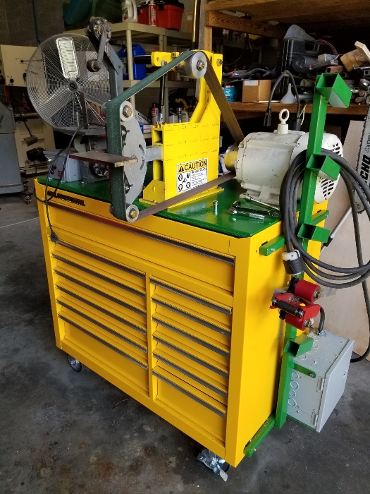

I also fabbed up some stuff so I could use a US General cart for my belt grinders. It's a huge blessing.
09 03 22 Belt Grinder Cart From Harbor Freight Tool Chest Fab Done small.jpg

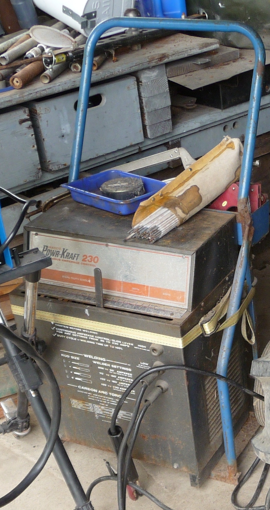

I have 4 I think, welders. The one I use the most is the HF 230V Mig with .030 wire and gas. Most of my welding is not welding main frames on tractors and such and the little Mig is right there, easy to start, gas gives me a clean penetration, on a roll around cart.
