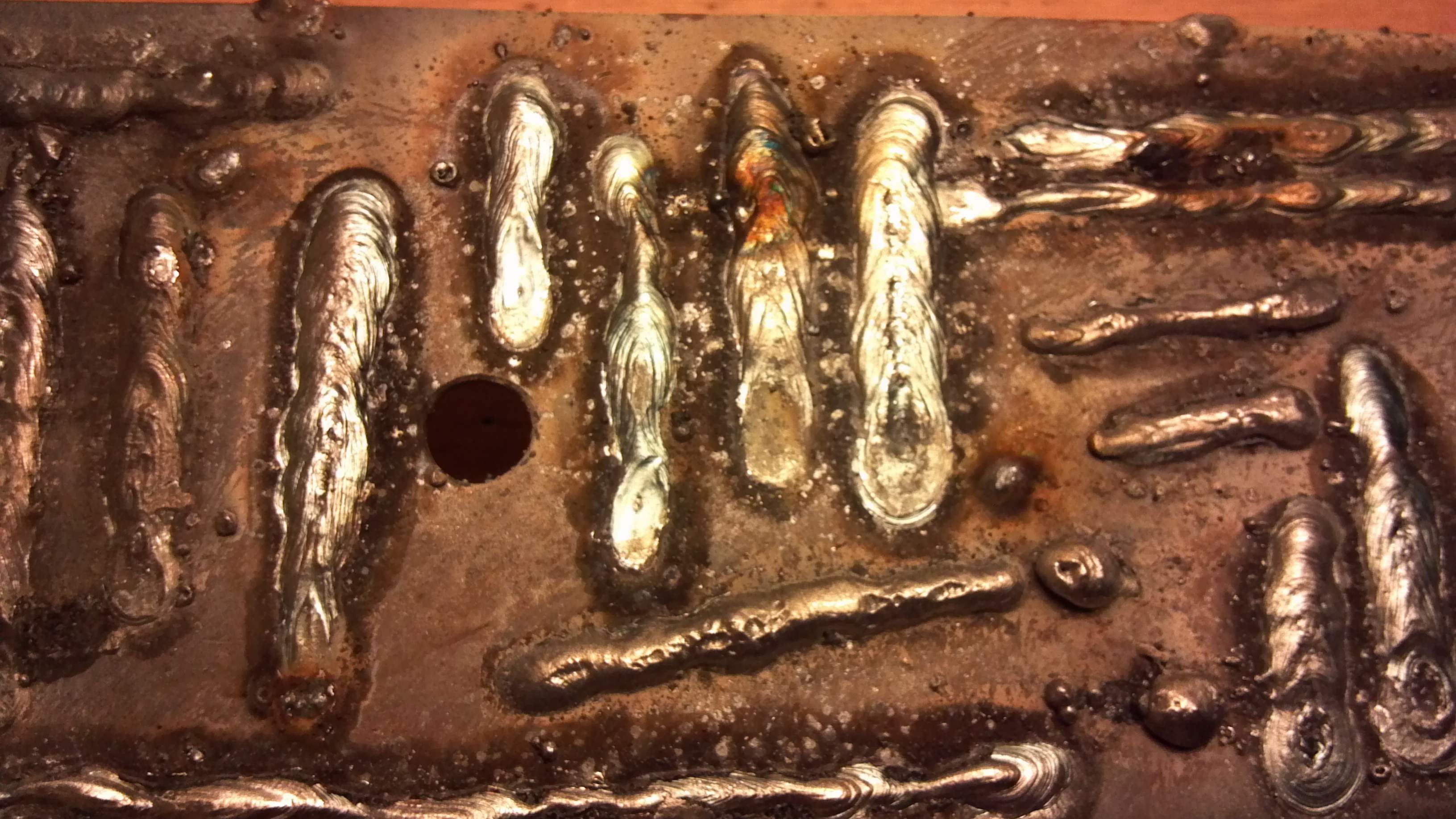

I did some more practice tonight. I had planned on welding up a small frame for the hand truck that I use to move my welder around on. Just a square base-plate basically, to allow me to tilt the truck back and move the welder around without having to have the welder ratchet-strapped to the cart like I do now.
At this point, I figure 1/8" is about the thinnest material I can try to weld, so I got some 1.5" angle iron, 1/8" thick. I actually have another piece of flat, 1/8" scrap that I had laying around my barn, so I shined it up and ran some practice beads. I had previously run some beads using 1/8" 6013, and I thought those were a little thick for what I intended to do, so I got some 3/32 rods at Tractor Supply when I bought the angle iron. Having gotten good results with 6013, and knowing that 6013 is a low-penetration rod (so less chance of blow-through), I wanted to get 6013, but they didn't have anything smaller than 1/8" so that was out. They had 3/32" in 7014, so I got that. They had something even thinner, but it was about twice as expensive as the 7014, so no dice.
I started out using the 1 amp per mil rule. 3/32 = 0.09, so start out at 90 amps.
WHOAH. Way too hot. Lots of spatter, a "pancake" at the end of the weld, and the puddle was like 2" long. So I turned it down maybe 10-15 amps.
Still way too hot! Part of what was confusing me was that I was having a little rod sticking and a tiny bit of difficulty starting the arc, so I was thinking my power was on the low side of what the rod needed. But really, I bet it is just that my work metal was not as clean as it needed to be since it had been sitting outside for a couple of moist days. Finally, I dialed the welder down all the way to its lowest setting, about 40 amps.
Much better.

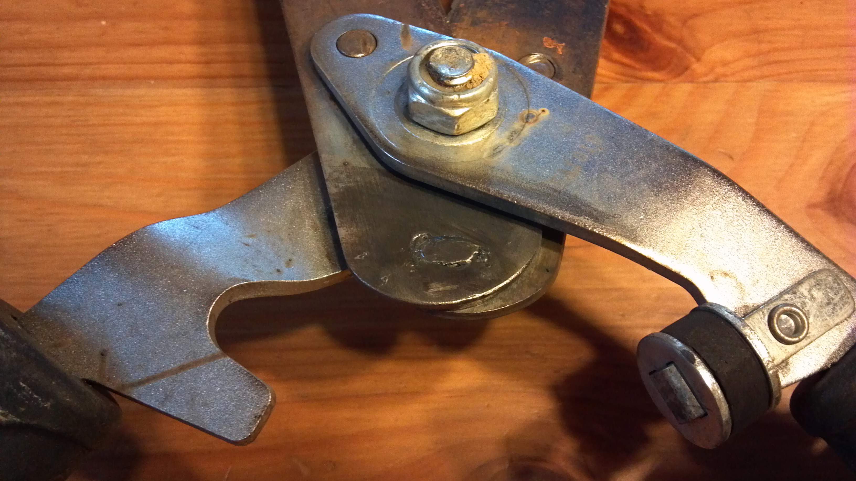

Today's small welding job: fixing a pair of hedge clippers. They are double-jointed, and a pin fell out of a joint. You can see two other pins in the photo that are still in place. I'm honestly not sure what's holding them in. They kind of seem to have been peened at the end, but of course that'd only hold them in from one direction. I previously tried JB-weld, but it gave up nearly instantly. I figured I would probably want some relatively hard metal, so I cut the head off a bolt, stuck it through, put two tack welds on either side of it, and ground it all down.
BTW, I am aware of the hazards of welding galvanized steel. In this case, it was, like, literally four total seconds of welding, so I just kept my head out of the fumes and held my breath. If it was a larger job, I would set up a fan blowing across the work location to carry the fumes away.
This was a $30 pair of hedge clippers. The way I see it, I get to count that against the cost of the welder. At this rate, I'll be MAKING money in no time!
BTW, in case you care, I used 1/8" 6011 at about 110 amps.
