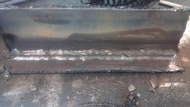

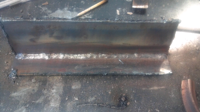

I went to an informal workshop put on by some local welders today. I think I really made some progress. There really is no substitute for seeing someone do it in person. Two tips that I took away were how to steady myself against the table, and to switch to 7018 rod. I had been avoiding 7018 because I don't have a rod oven, but even 7018 that hasn't been in an oven runs a million times better than 6011. With 6011, the bead is so terrible that I can't really see what I'm doing right or wrong. With 7018, the rod is working with me, not against me, and I can more easily see my progress.
Here are the first two passes of a T joint I did.

HA! Real welds! Ain't it grand to make a weld like that and look at it and say "wow that is more of what I had in mind".. Yes you gotta get set up with the TIG. Argon cylinder, 17V torch, and regulator.. I can help if you get stuck finding the stuff. Torch about $75, regulator about 25, Cylinder you are on your own, I bought mine a 125 cu.ft. for $210, (full) but the prices and rules vary so much per region. some places you cannot even buy one that big, you have to rent. It is cool once you kinda get on to it. You are really coming along, and it has been enjoyable watching your progress.

Once you lay down a nice weld bead, there is no turning back - you are hooked! :D Great progress. Congratulations.

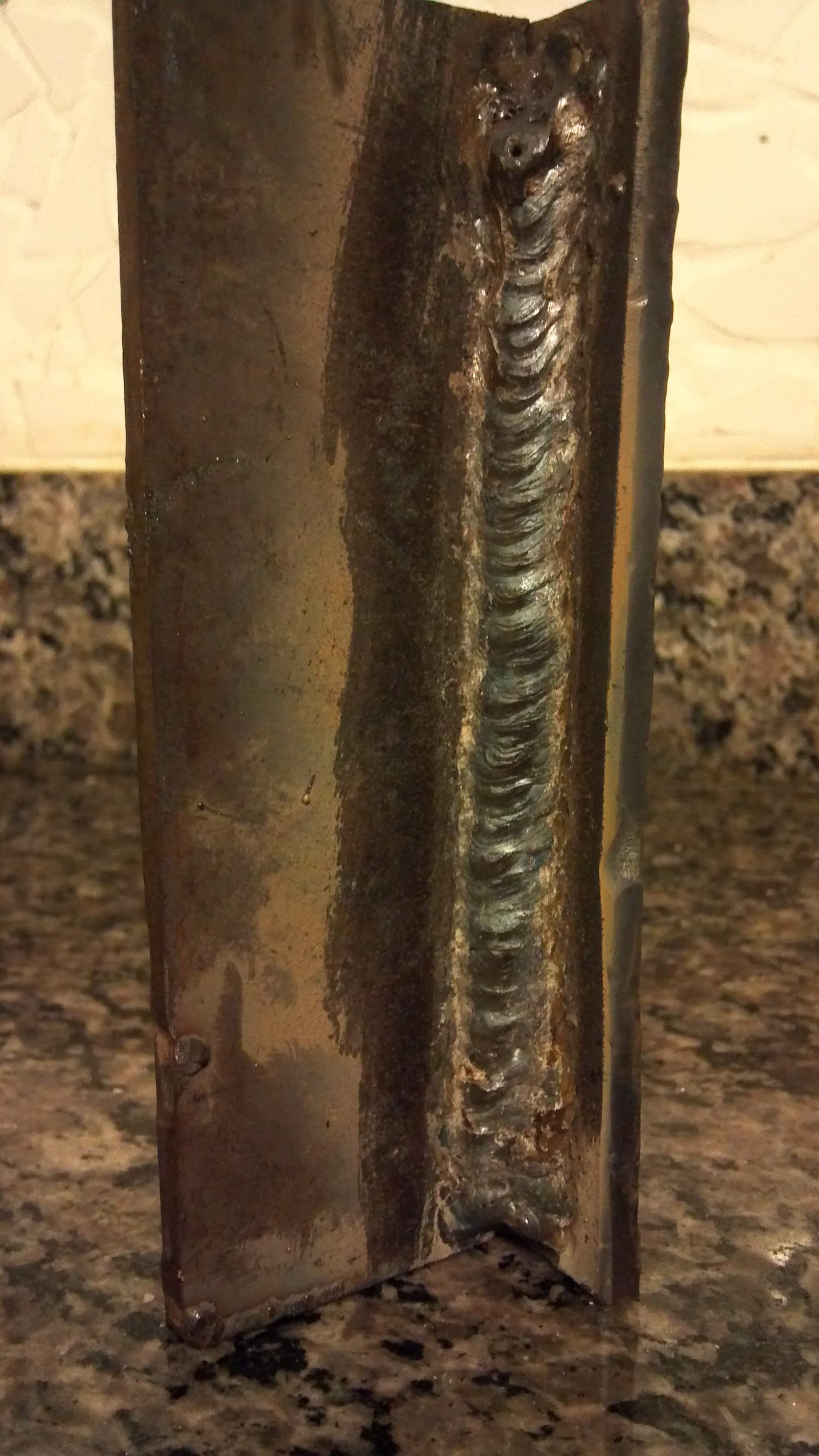

First attempt at vertical up. E7018 at about 130 amps on 1/4" stock. Using a "z" motion.
I gotta tell ya, 7018 is really a wonder of a rod. Makes me look like I might know what I'm doing--at least to the untrained eye!

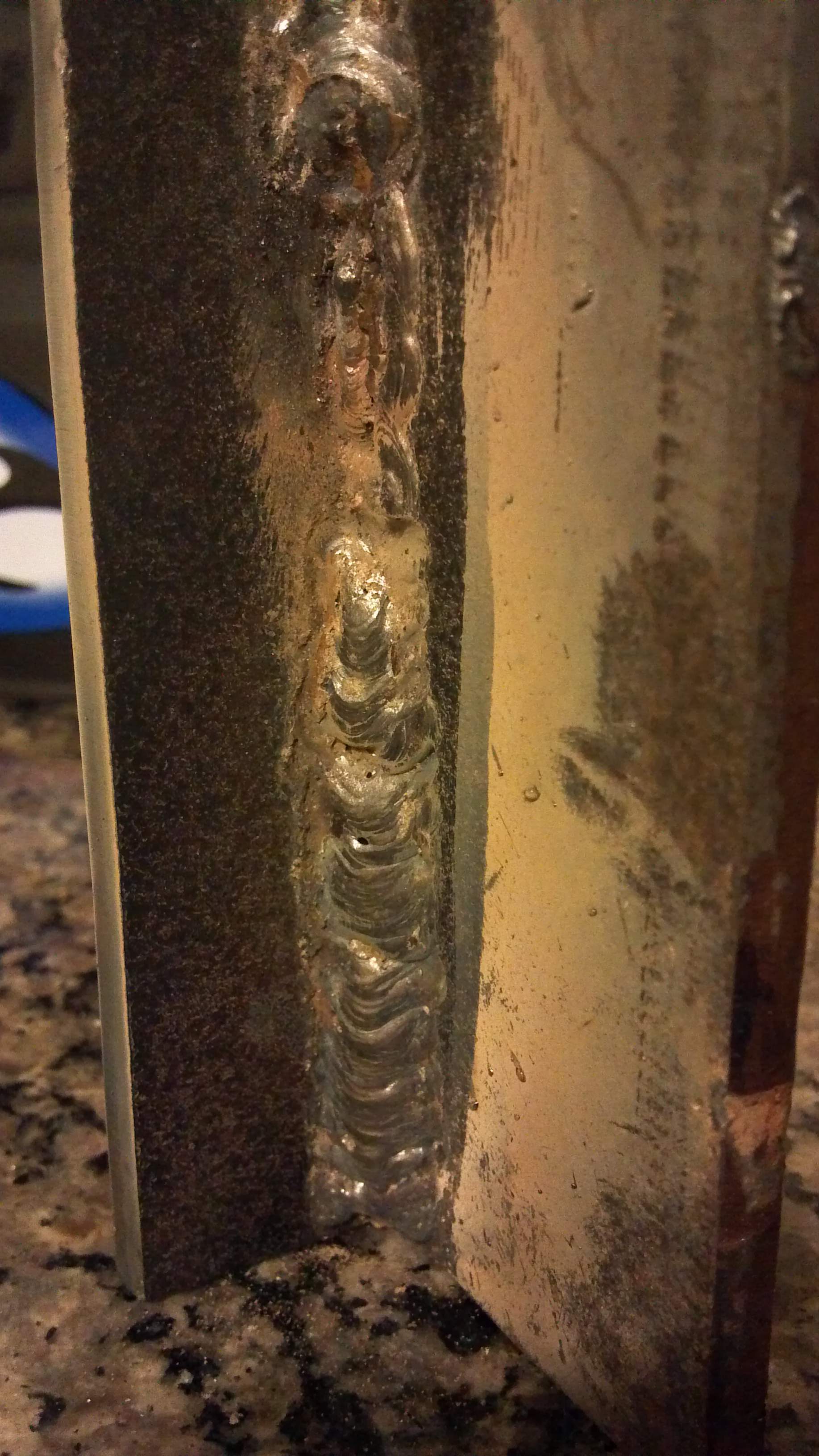

Here's my second attempt. This is actually over about 3-5 fillet passes that I made in the horizontal position, so it would be more of a cover pass.
I know I have a long way to go, but I'm really super-pleased with these results.
