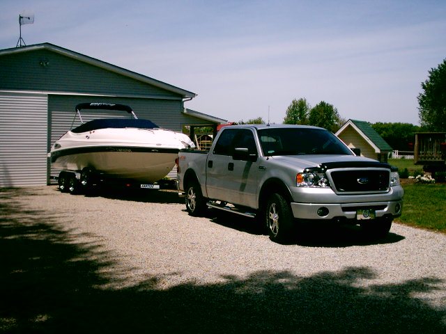

I am sorry, I read more into than was there. I miss took Super Crew for Super Duty. I have owned 2 F-150's with 4:10 gears. They have been available from 1997 through 2008 and probably longer but I am sure of the 97-08. I do not believe they are available anymore since the new tranny came out but I have owned 5 with 3:73 gears and all have done a good job of towing in the 7,000# area. I only had a struggle one time with a 9,500# load on a hot 110 deg day in August in the Smokey Mountains. Really too much weight for that truck. Got home on Sunday and bought a new 2004 PowerStroke on Monday. The last F-150 I had, a 2007 4x4 SuperCrew, with a 5.4 and 3:73 gears averaged 16.4 mixed and did around 10.5 towing every weekend a 7,000# load from April to October. Just sold that truck earlier this month.
Sorry for getting off topic.
Chris
