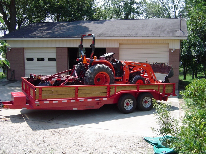

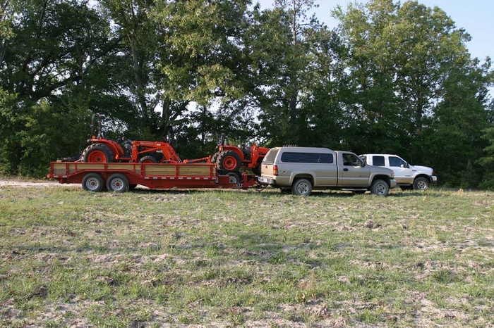

There is a guy on this site that has a heck of a trailer. I can not remember who he is but he had a custom built car/equipment hauler. Its a bumper pull 14,000# unit that has stake pockets and removable sides but is a full dump also. He had some pictures of it dumping firewood and it was slick. Great all around trailer.
