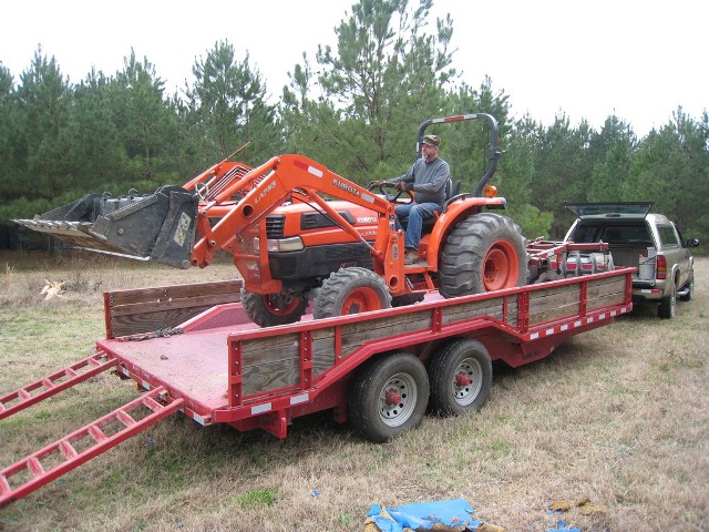

Its not my trailer. I know nothing about it but it could be towed with a 3/4 or larger diesel truck or a something like the Ford V-10. Its one of the members on here. I have always like his trailer and think it would fit this guys needs.
Chris
   / Thoughts on using a Dump Trailer for hauling my Kubota? #25
   / Thoughts on using a Dump Trailer for hauling my Kubota? #26
That has to be the most versatile trailer I have seen Redbug. I would be proud to have it behind my truck any day.
Chris
