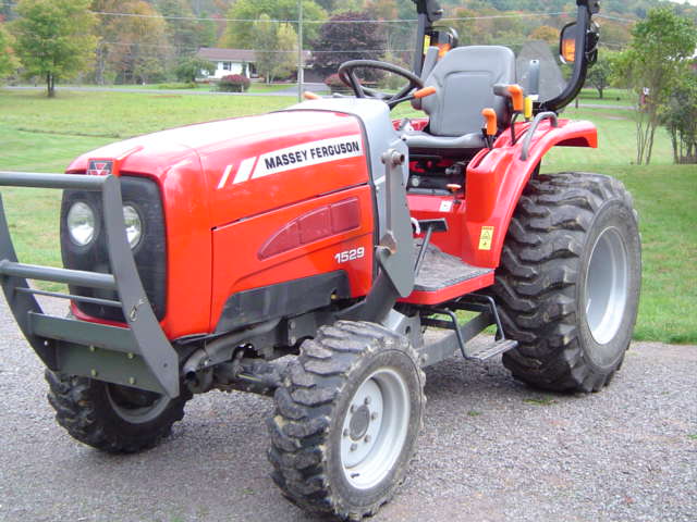

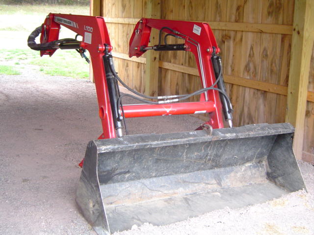

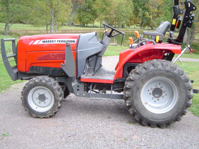

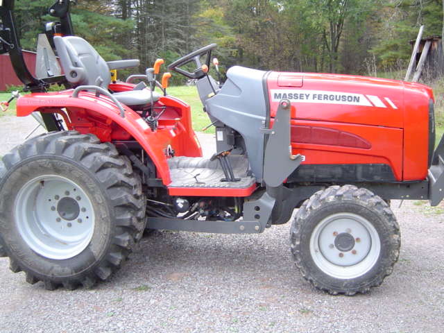

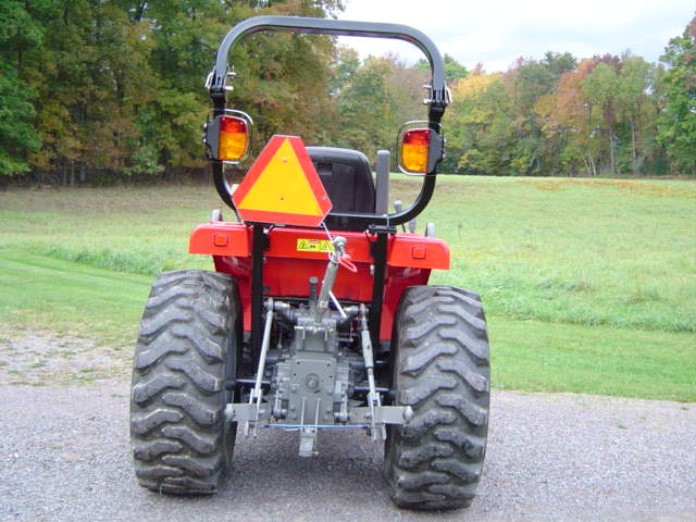

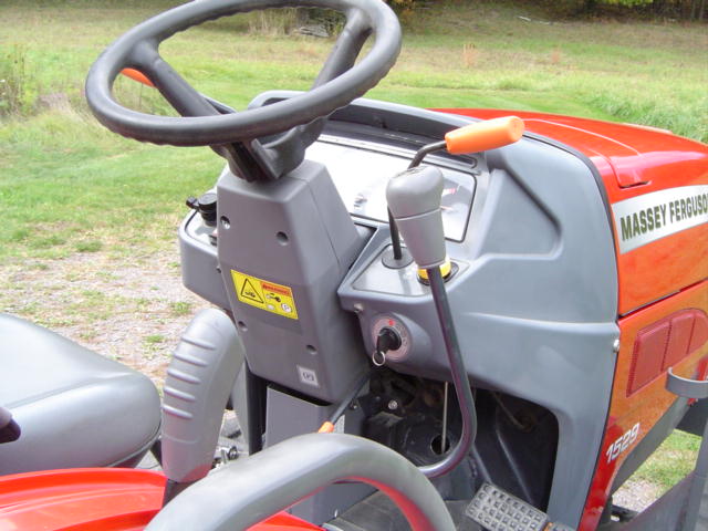

I pretty much have all of the cosmetic work done ... mostly just cleaning, removing rust, a little touch up paint, and replacing the turn signal/hazard lights on the inside of the ROPS. Loader is off, to take the tractor to "my guy" to change the PTO and seal in the front axle. Also, note: Lower ROPS.

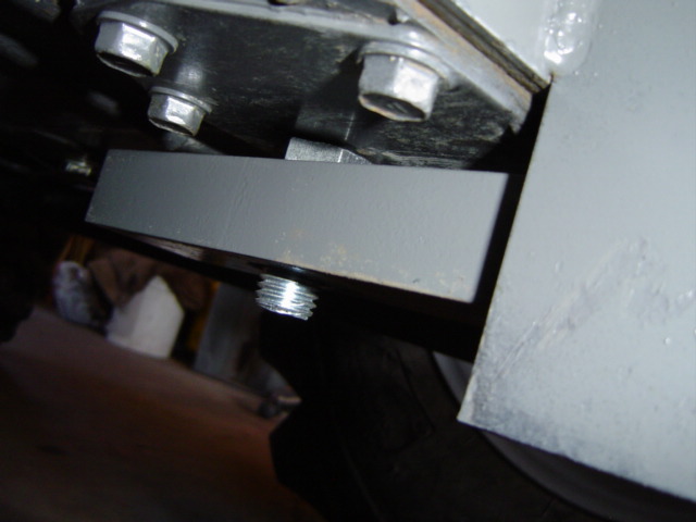

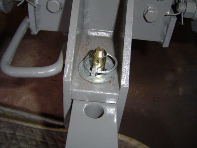

I had found a used drawbar, which I installed on the 1529. Then I was reading a thread, where the guy's drawbar lost the pin, and then slid rearward until the brush hog grabbed it and ripped a big hole in the bottom of the aluminum rear housing.
The first thing, which I did, was to check, if my rear was aluminum ... nope, cast iron. I didn't want the drawbar to slide out, in any case!, so I pulled the drawbar and dropped a 3/4" bolt into the furthest, forward hole and slid the drawbar in from the front. Hopefully, if I should lose the drawbar pin, the forward bolt will stop the drawbar, when the bolt reaches the front of the drawbar bracket. The bolt head is close to the underside of the rear, so it can't get out of there.
Add pix:

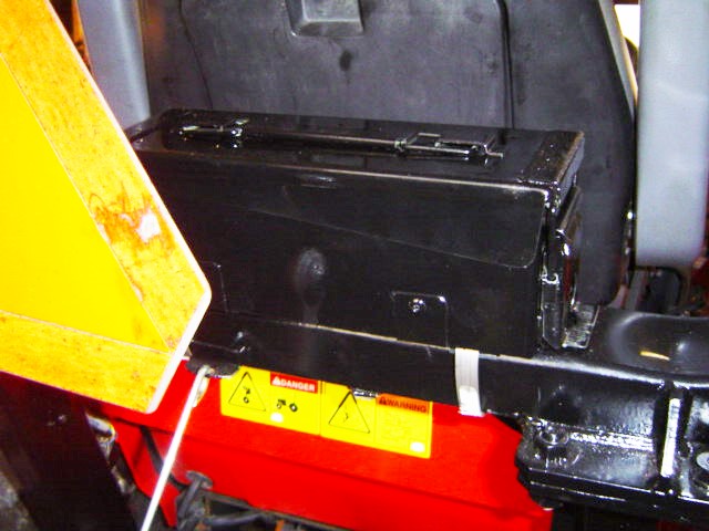

Today, I mounted, on the ROPS, my "modified" 30 cal. ammo box (because I felt, it was too deep), to hold lynch pins, top-link pin and a few small items.

That spot on the ROPS is where I typically set my chainsaw. Two bungee cords hold it very secure while I head to and from the woods. I'm still looking for a good place to integrate a small toolbox.
