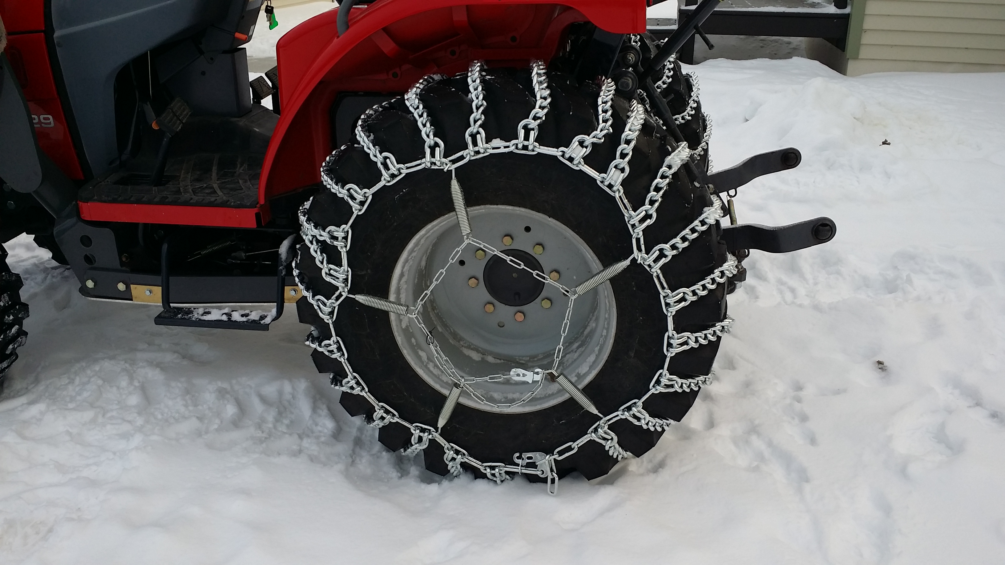

The 1529 enjoys having a set of chains. I put a set on the rear tires and it made a notable difference for me here in northern Minnesota this winter.

Thanks! My friend had an old set, we had to dig them out of the snow. I cut them to length, got them on and finished getting the drive open. They make a world of difference! You don't feel like you're always on a banana peel. Had the truck stuck 3 times today. I'm ready for spring!

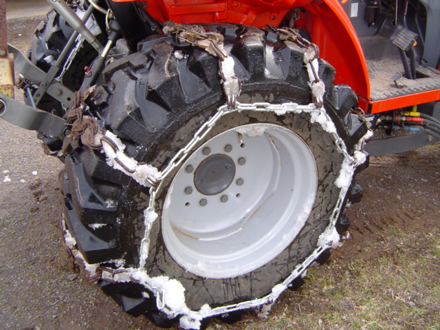

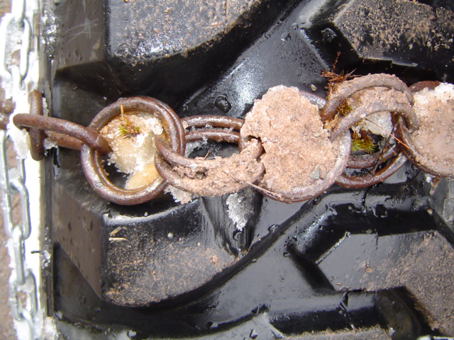

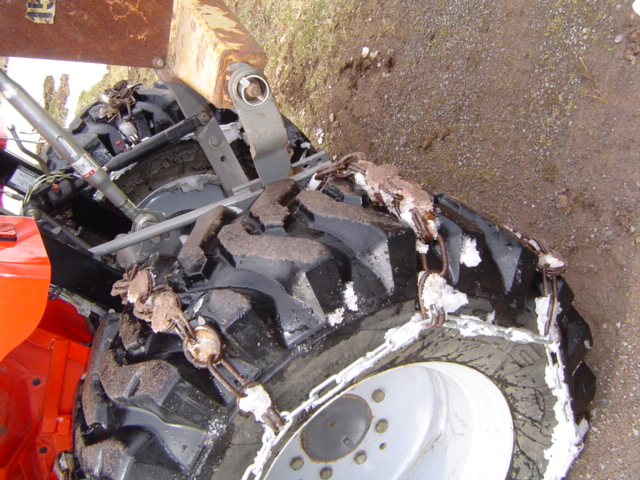

I just finished refurbishing the "double ring chains"! ... I replaced the side chains, which were pretty badly worn. It got to be quite a project, even using a chain tool. I took it out in the snow, for a test. They got through, what is remaining. I had one hill, where the front end broke loose and left me sideways. :thumbsup:

tmajor....congrats on getting the 1529 chains reworked. Sounds like they will be in good shape for years to come now. Never did any work on chains before....just installing and removing. I took mine off my 1529 about a week ago. While we could certainly get some snow yet, I doubt it would amount to much. The ground is warming up and the only snow I have is a couple of place where I piled it with the FEL. I picked up a Wallenstein chipper/shredder and as soon as things dry up a little more, I'll be able to give it a try.

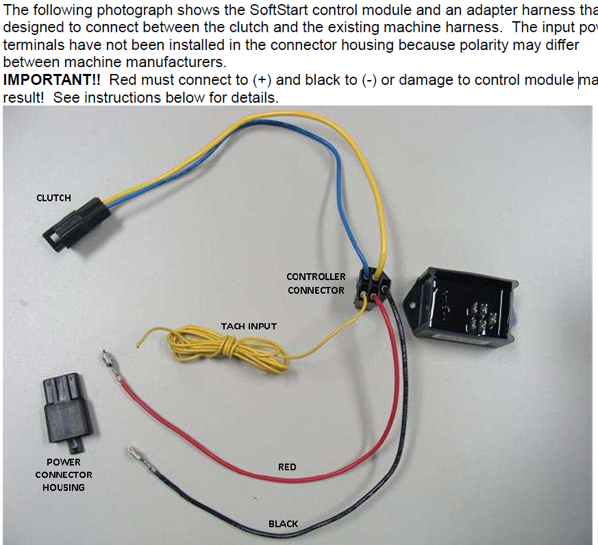

So, this morning, I did a little Google homework and found the SoftStart Clutch Controller, which is supposed to soften the PTO clutch engagement, by electronically pulsing the clutch, until up to speed.
In talking to the MF dealer service/parts, I find, that they use the same device for the larger MF tractors. In my opinion, they are priced reasonably enough ($45), that, if I can get it hooked up and it works as intended, my mind will be more at ease, and I won't cringe, each time I engage the PTO, with a load on it.
Also, in talking to "Warner Clutches", they sell the same device to OEMs, for the same purpose.
In my head, I'm comparing: an hour to install the controller and a $45 cost, to 6 hours labor @ $60/hour and $500's in parts.
"SoftStart" demonstration video on a belt driven mower deck .... Your tractor doesn't have any idler pulleys, belts, etc., to "take the force", when starting the PTO.

The more I learn, the "less intimidating" it looks! Here is a much better explanation of what needs to be done. I'll try to further enlighten, as I get into it.
The instructions, seem to indicate, that you simply find the clutch connector, separate it, insert the factory installed plug into the clutch end of the harness, verify which is the +12 volt wire on the tractor side and insert the red wire into the corresponding slot in the empty plug and then the black wire into the other empty slot in the plug, which will then plug into the tractor side of the harness. The yellow tach wire is optional. The attached diagram shows the tach wire wrapped around a spark plug wire for a gas engine, while diesel, would have it going to the alternator "tach output". Also, if you accidentally get the "slide in contact" in the wrong slot, they can be removed, by inserting a small, flat tool and depressing the little bit, which holds them in place.
