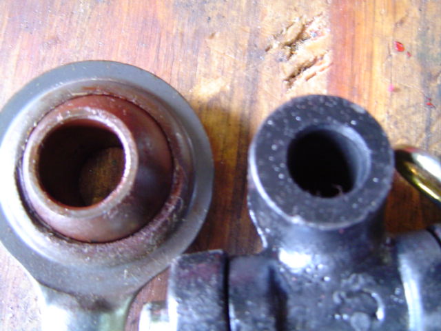

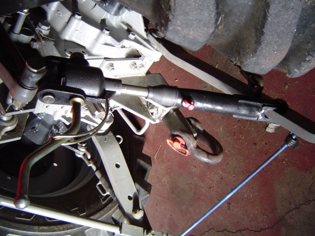

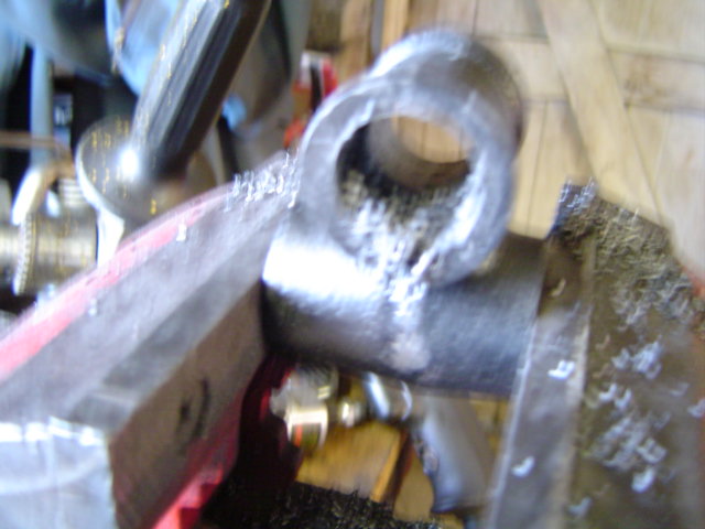

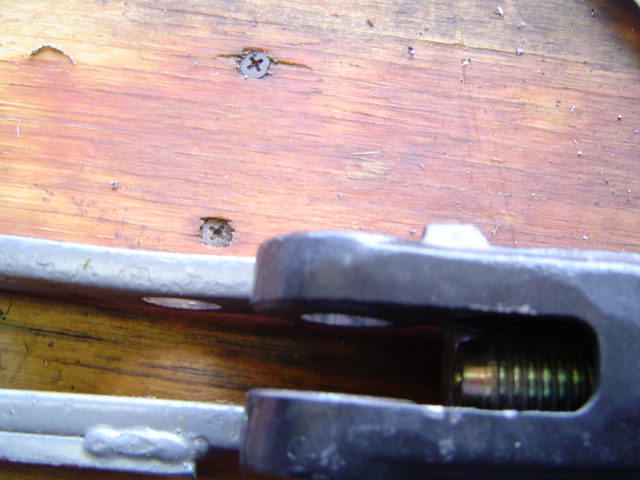

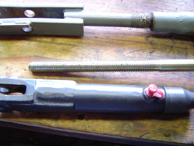

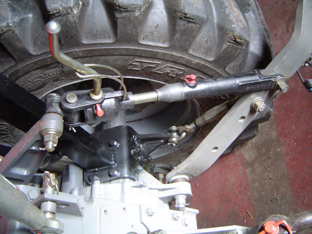

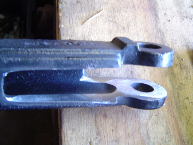

I received, modified and installed the box leveler, today. There was a bit more to the fitment process, than I had planned on.
The original and new were close in length, however, the new one was about 1" longer, when closed, so I cut 1" off the threaded portion, as it was bottoming out on the bottom fork/draft arm. The bottom pin was the same size, as original, however the fork on the new one was only 5/8" wide, instead of 3/4", as are the draft arms, so, I had to grind the inside of the bottom yoke, to open it, to 3/4". The top knuckle had a 5/8" hole, while the shoulder bolt from the original was 3/4", so I elected to use the original bolt, requiring drilling out the top knuckle to 3/4". Then, the knuckle was about 1/2" too wide for the shoulder on the bolt, so had to grind it down to slightly less then the shoulder length. All in all, it worked out to my satisfaction.

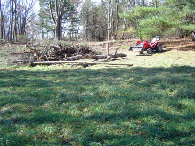

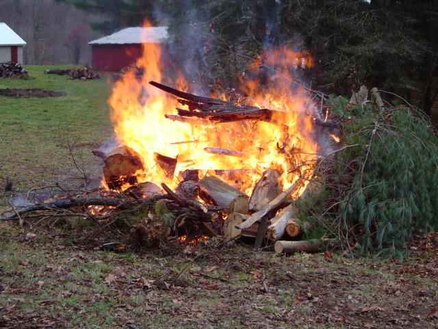

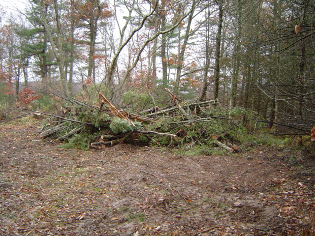

I check this thread every time I access the forum. I hit 160 hrs on my 1529 today. Got it when it was in the 90s.
I found a new use for mine last week. Here is the photo:
   / Thread for MF 1529
#38
To think, if you had a bigger tractor and bigger bucket, you could have gone for the "bigger one"!
