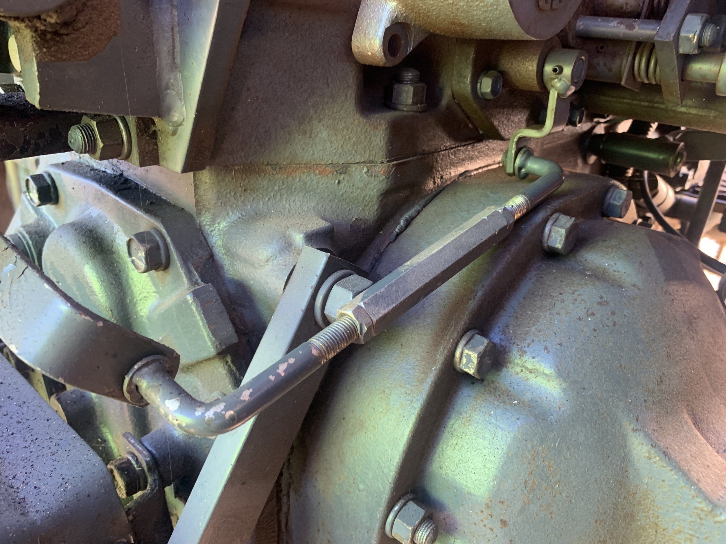

Based on his video, I think you'd have to say there is something wrong and his position control is failing to work... Hmmm. The fact that he can't turn his lowering rate knob may be a clue...
But? What is wrong? Why is the position control lever not doing anything?

That's a good explanation of draft. But that still doesn't answer the question of what's wrong with my tractor. Why does the position control lever not do anything? Why can I only lift the 3 point with the draft control lever? Is something broken, or is something not working properly?

Absolutely! That's the real question and we do not know. I suggested the "lowering speed knob" being stuck and not working is a strong clue to what is wrong and I still think so. Because the lift DOES move up and down in your video (never mind the control settings) that means your hydraulics are working, you have flow to the lift cylinder, etc. I suspect something in the control linkage is stuck which is why the "lowering speed knob" won't turn. I don't own a 5740 so can't go out and inspect one or study it. Your position control lever operates an hydraulic valve so it is possible the valve is bad but in many, many years I've never seen that go bad. Has it ever worked properly while you have had it ? I'm betting is has never worked right while you owned it. Was stuck when you bought it.
You might end up having to have a dealer look into it. I think you will find the fix is all labor. Doubt seriously there's a bad valve.

It is hard to say exactly what is wrong with your lift arm control without being there. Looking at your picture in post #1 and trying to comprehend what the manual is describing. I would say that to reduce the sensitivity your draft control lever should be forward to the stop in your picture, apparently that would be the least sensitive draft position. Then per the manual the position control lever should raise and lower your implement.
Which top link bracket pin holes are you using. The upper most location may be the least draft sensitive.
If with the draft control at the forward stop if the position control does not lift the implement then the function of the draft control lever needs to be checked out. Is it operating a cable or a linkage going to the internals of the tractor. It will take a service manual to get that adjusted correctly.
It could be the rate of change adjustment but it is allowing motion to occur.
With this being a "97" model and 24 years old the draft control and position control linkage could be all screwed up and the sensing portion of the draft control damaged or misadjusted.
Good Luck with her.

Have you checked the linkage from the top link bracket to somewhere in the rockshaft housing? It almost looks like something is wrong or disconnected there and it's constantly sending feedback to the 3 pt control valve to lift the 3 pt.
