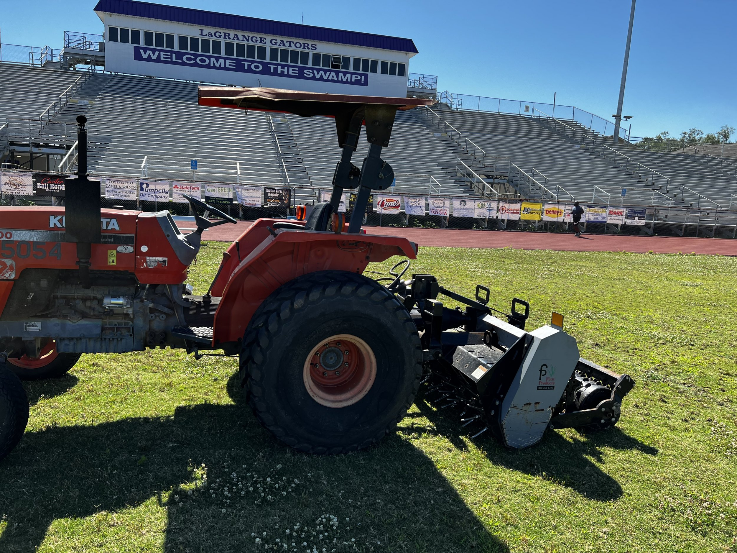

Today, I was able to get the 'lowering speed knob' to turn freely. It wasn't really stuck tight, but it was open all the way.
Unfortunately, this did not resolve the issue. I tried adjusting the lowering knob into many different positions and still could not get the 'position' lever to affect the 3 point hitch in any way at all. Not even the slightest.
I did use this tractor for several hours on last week with a fairly heavy attachment, and it got the job done. I do have more work with this attachment for this week on this tractor, because my Grand L6060 is down with a DPF issue.
