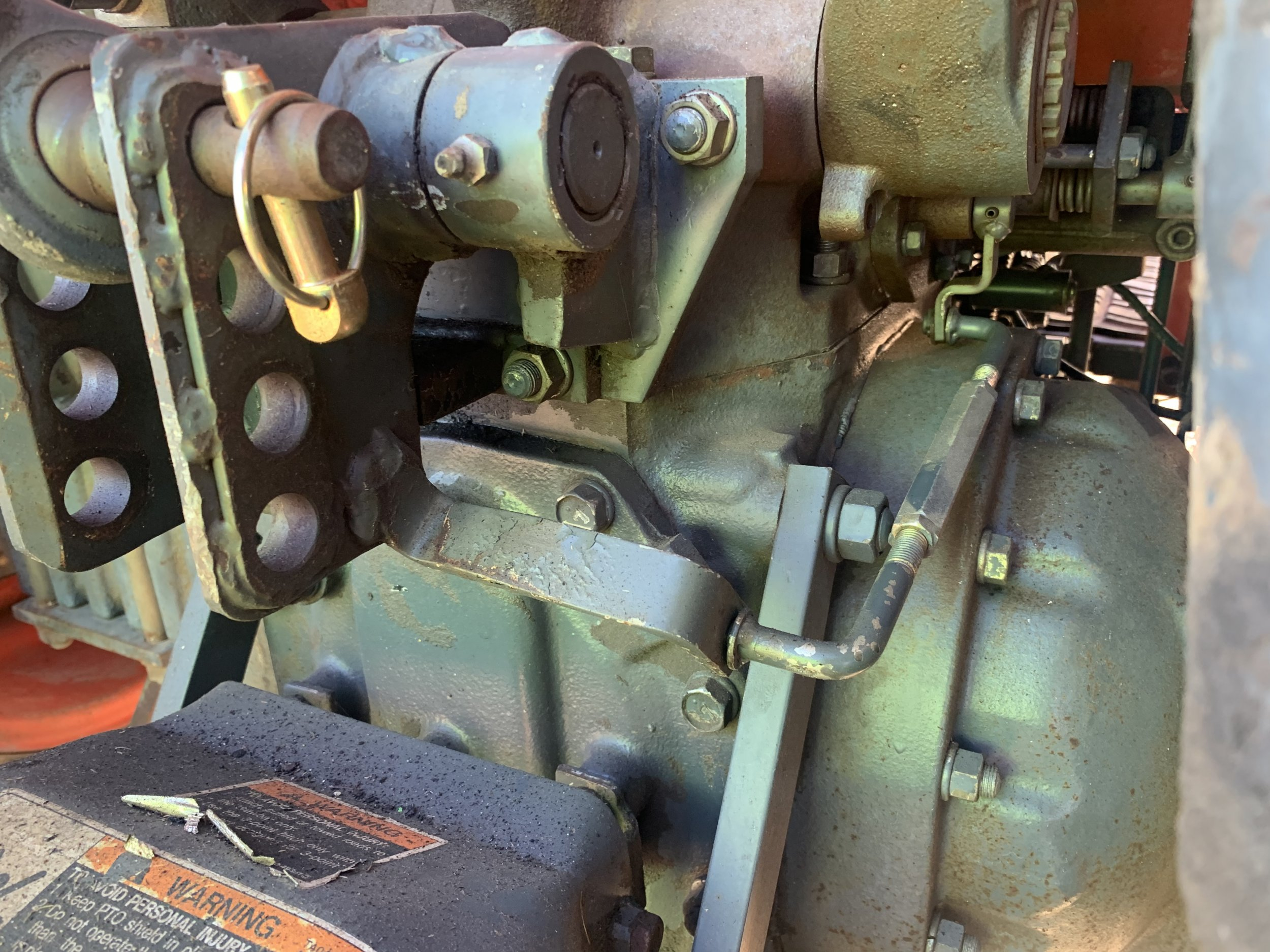

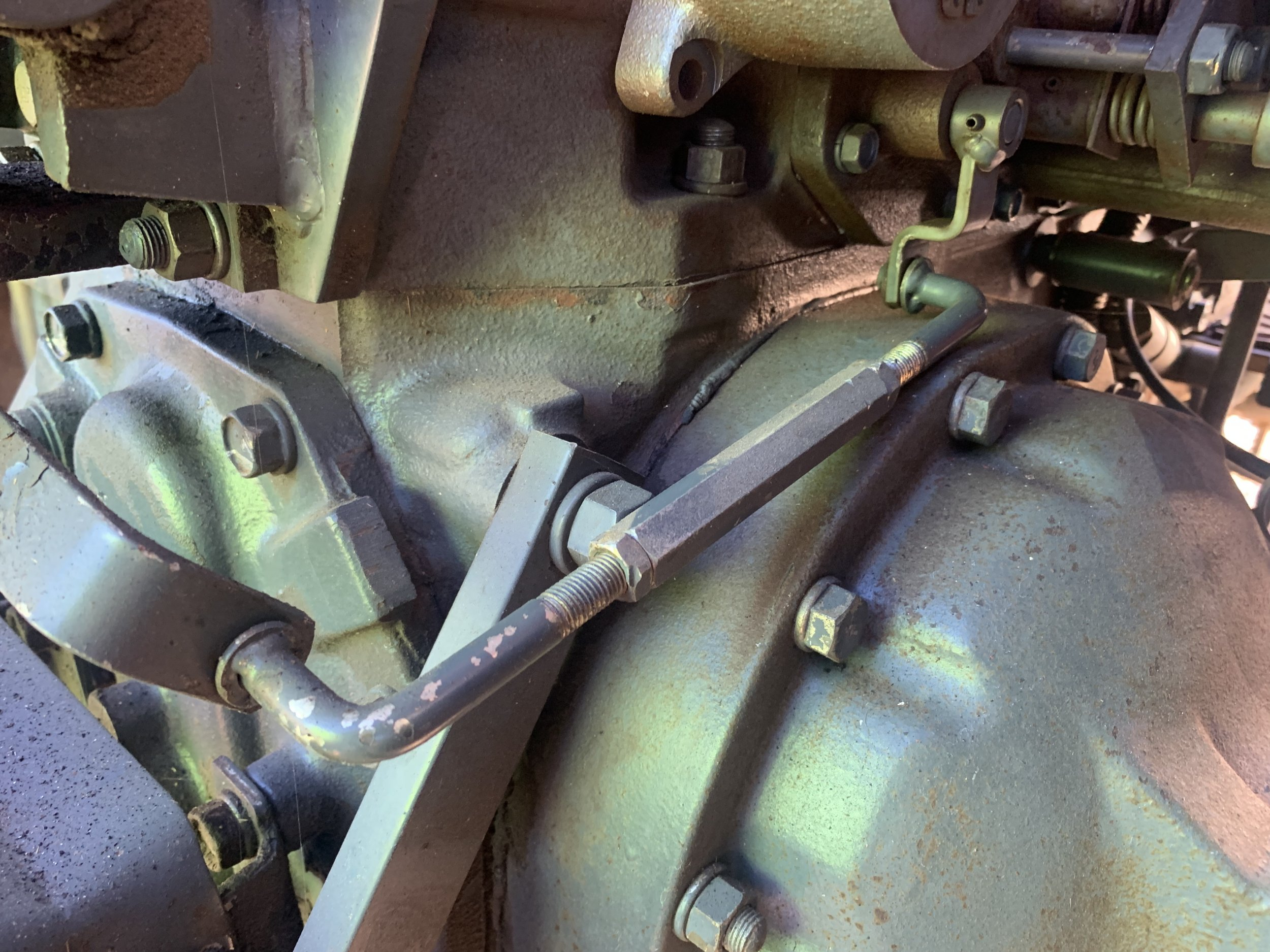

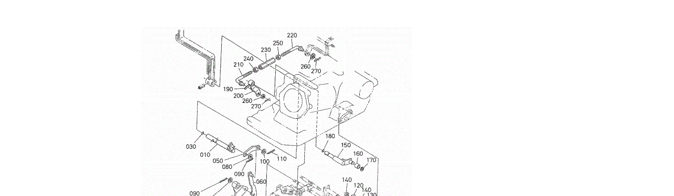

Did you ever find out the problem with this
No I have not. I wish I could figure it out, but I don't want to spend a lot of money on this tractor. I have 3 other tractors that I use on a regular basis, and this one does not get used much at all.
I'm afraid that if I bring it to a Kubota dealer, it may get quiet expensive to repair.

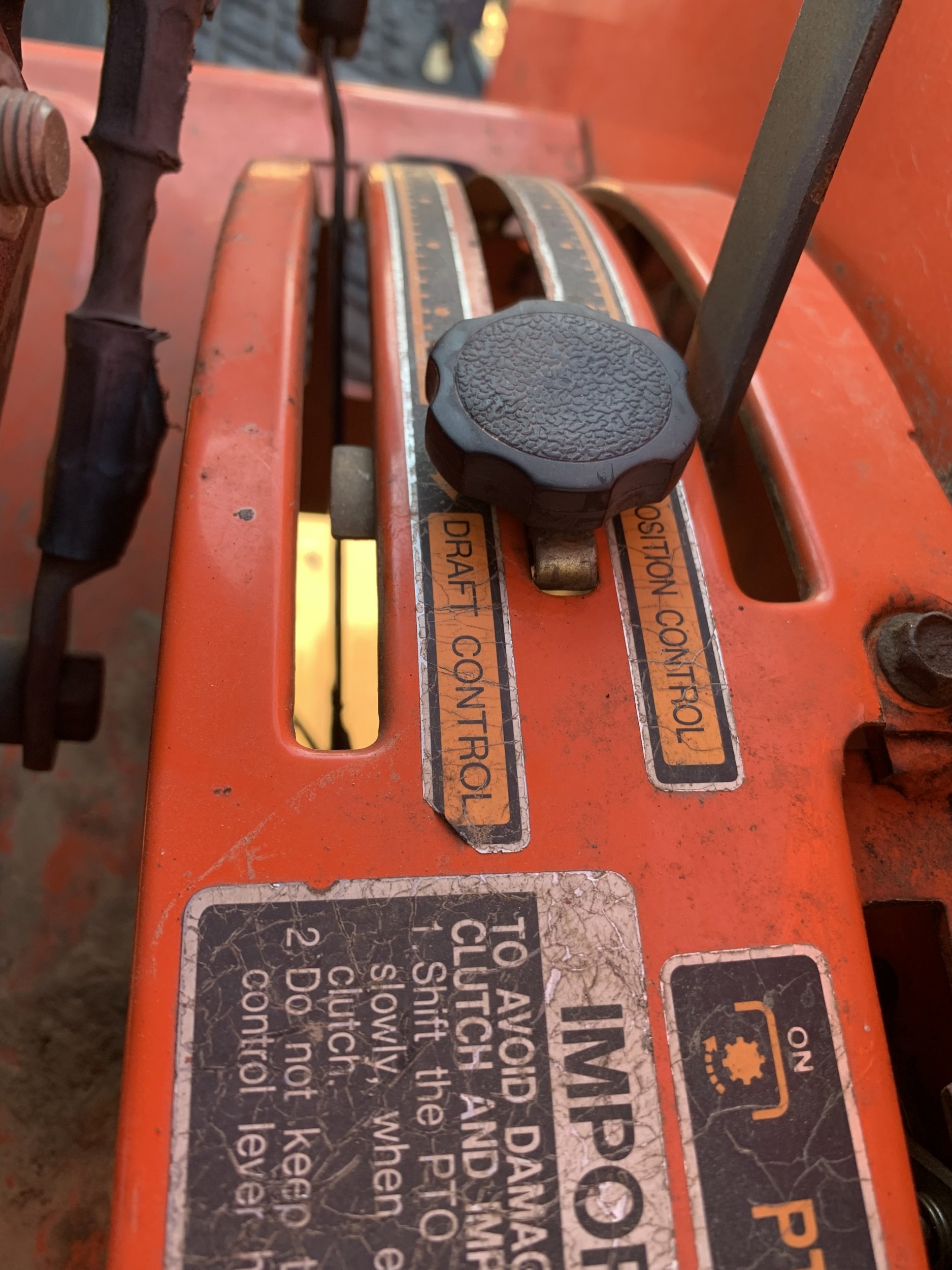

Draft control tries to keep a constant pull on the tractor by varying the depth of the pulled implement, with the position control setting the maximum depth for the implement.
I do not understand the function that way. I thought the function of Draft control was to maintain and allow adjustment of even plowing depth, not to manage tractor pull. Makes no sense to me to pamper the tractor when it is intended to be your slave, not your master. Of course, if you run into an issue of losing traction that is a reason to set the plowing depth more shallow, to me the secondary issue. Just viewpoint I suppose.

Draft Control using up/down axis forces (only, not fore and aft)
Is this some different type of draft control you mention? The Harry Ferguson draft control used fore/aft forces to pivot the implement causing it to compress the top link and actuate the draft control.
As far as getting the plow to penetrate, the draft control cannot control that as it has no down pressure on the 3PH. With that said I've never experienced a plow trying to float on "soft almost fluid soil".

Downward force is provided by the nose of the plow pointing downward and tending to pull the plow deeper and deeper depending on soil density, strength, etc. Back in horse-drawn plowing days, the front wheel was there to prevent the plow from "burying itself" too deep. By sensing vertical position, Draft Control regulates the depth of soil penetration by the plow with the goal of constant depth. Draft IS depth. Thus Draft control inherently means depth control. That's traditional Draft Control. Over decades of use, more complex control systems have of course evolved like the EDC mentioned by LouNY in post #83 in a claim to fame for New Holland. There are many variations.
   / Three point hitch draft control M4700 #89
Sorry, but I think you are confusing draft as a nautical term with draft as a farming term. Draft, as a farming term is the horizontal force required to pull an implement through the soil.
The draft on a 3PH is controlled by raising and lowering the implement by the draft control feature as the implement encounters variation is soil. The position control on a 3PH simply establishes a baseline depth.
