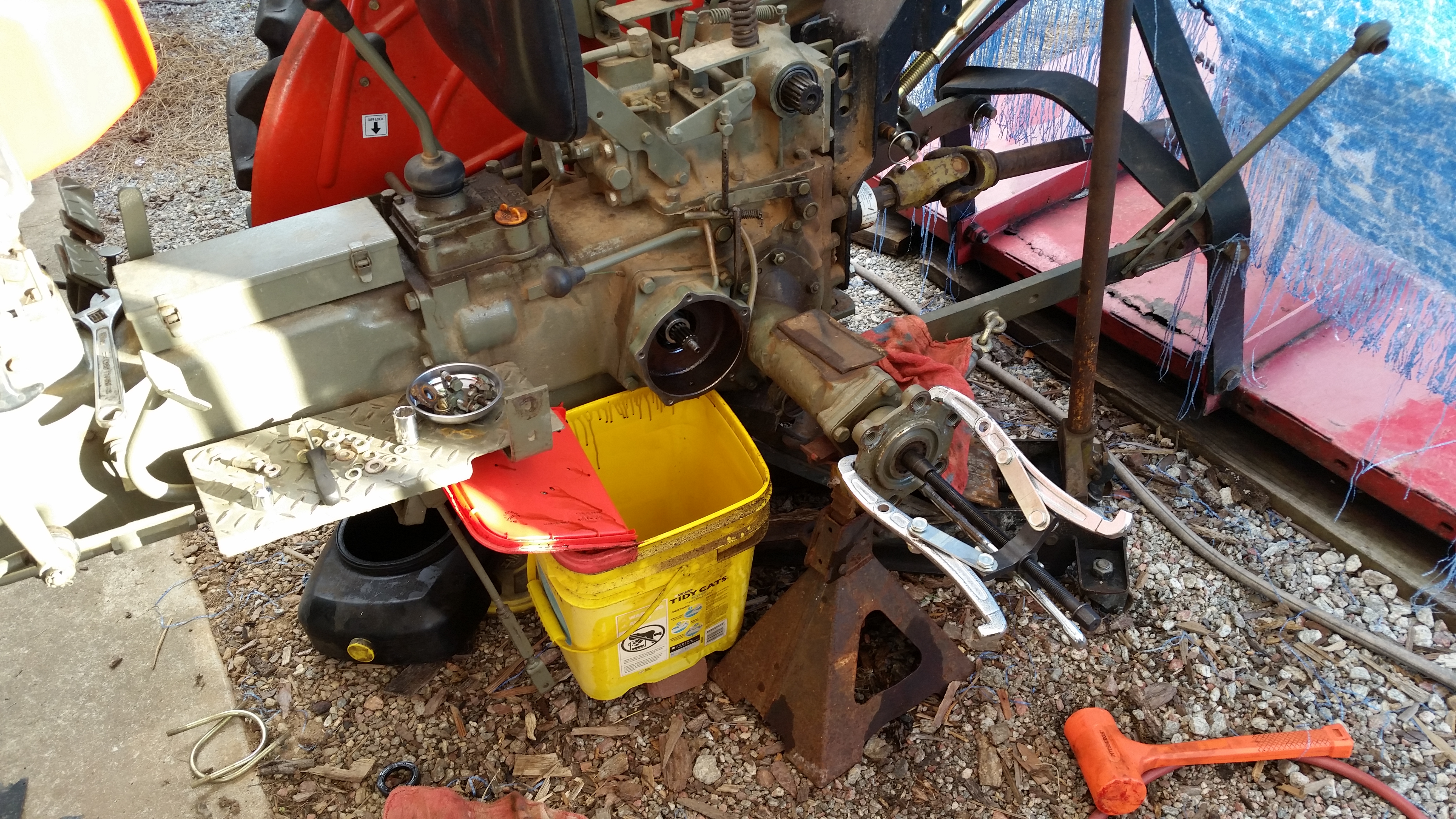

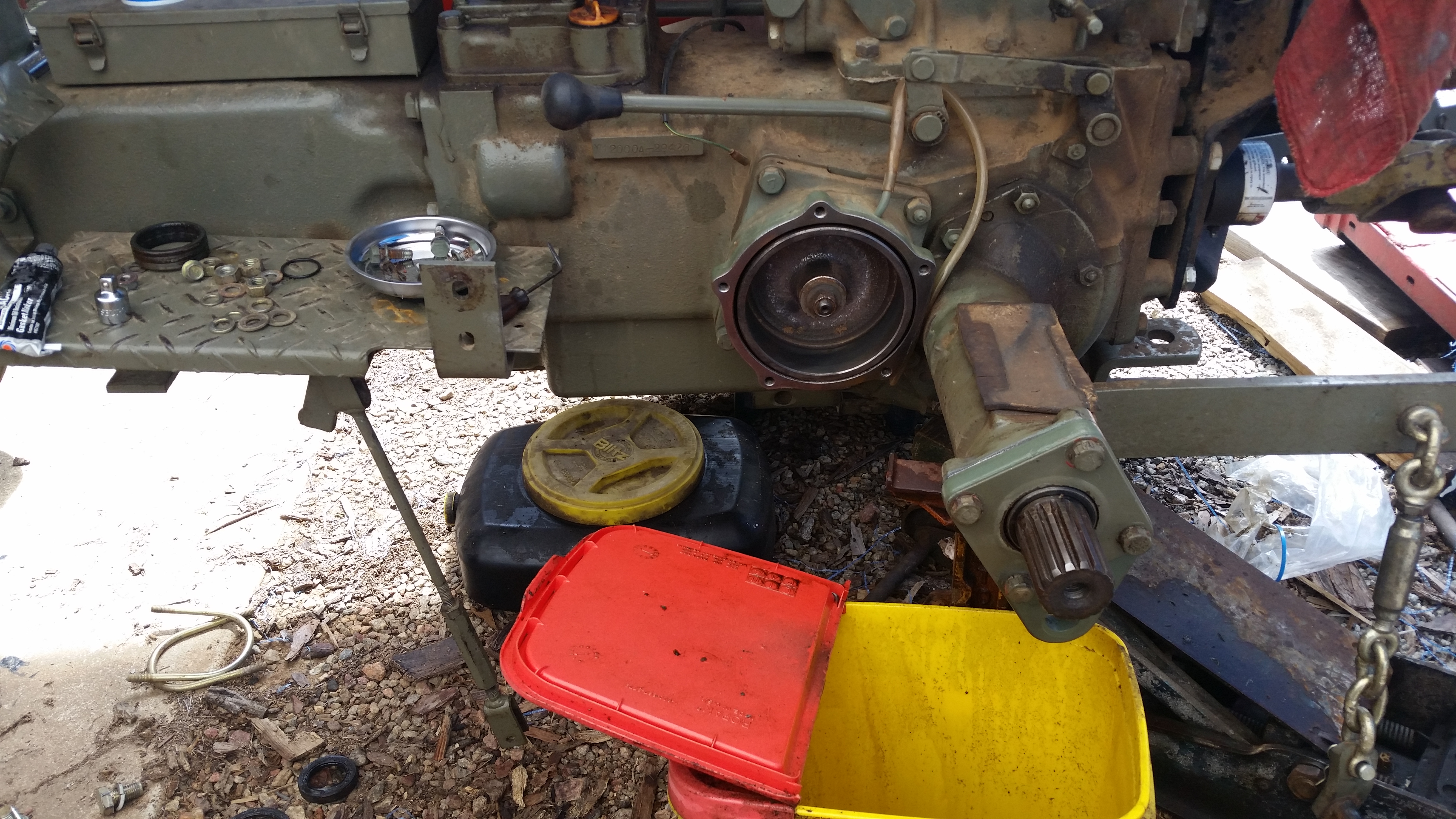

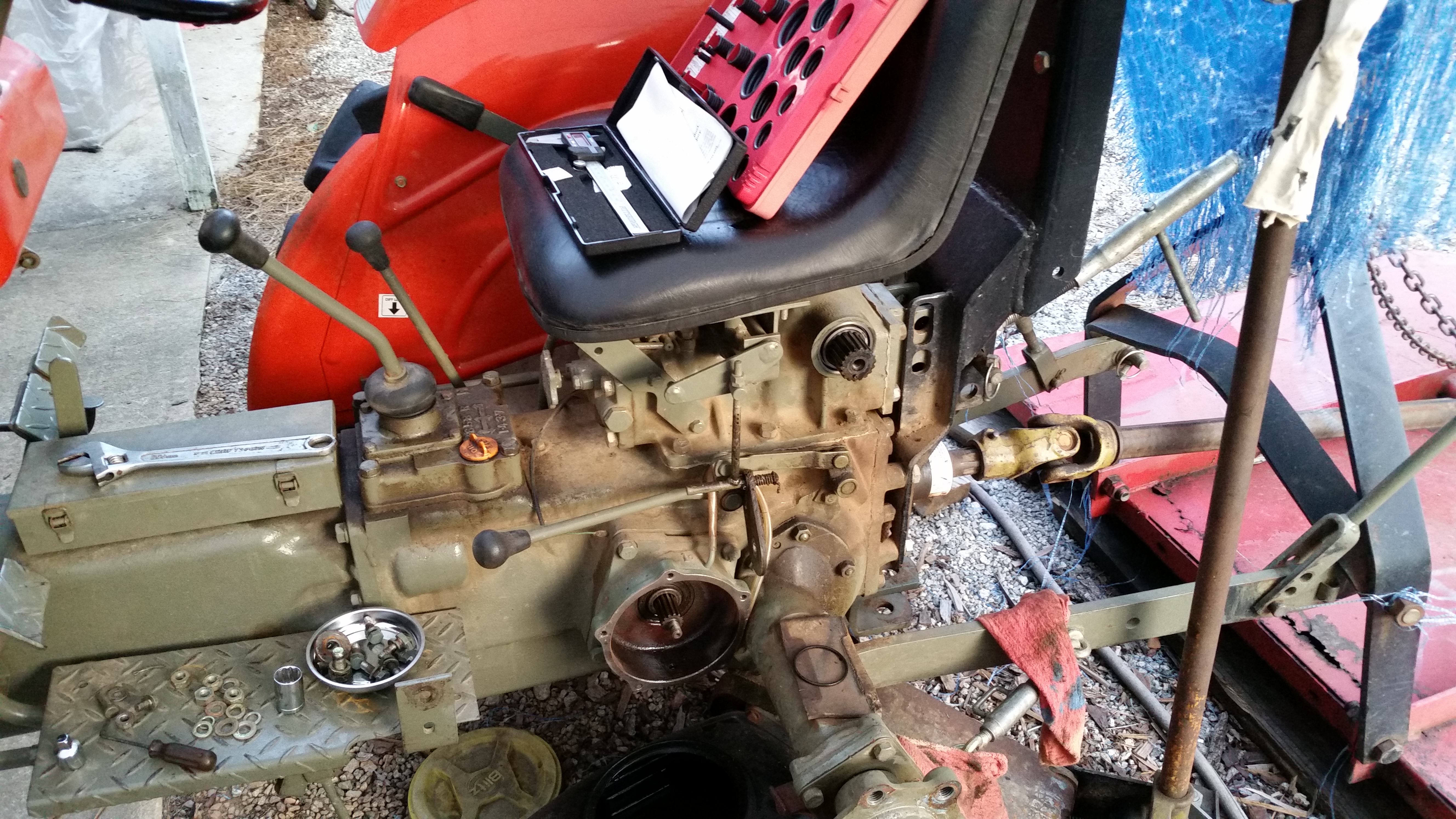

20160814_200003.jpg20160815_190930.jpg20160820_124202.jpgForumRunner_20130602_201739.png[
Ok i went through all the pictures i have posted over the years. All i could see were thumbnail view when i looked through my previous attachments so some may not help but were too small to tell as i selected them. These are pics i posted for other reasons but look to have the linkage in view. These pics are all posted with the lever in the down position and the arms in the down position.
/ Three point valve broken!!!
#90
View attachment 577029View attachment 577030View attachment 577031View attachment 577032[
well dang, like i said all i could see was thumbnails, so i had no clue what they were till i posted them and clicked a larger view.
The best pics have the rod disconnected from when i removed the arms to replace the o rings behind them!!!

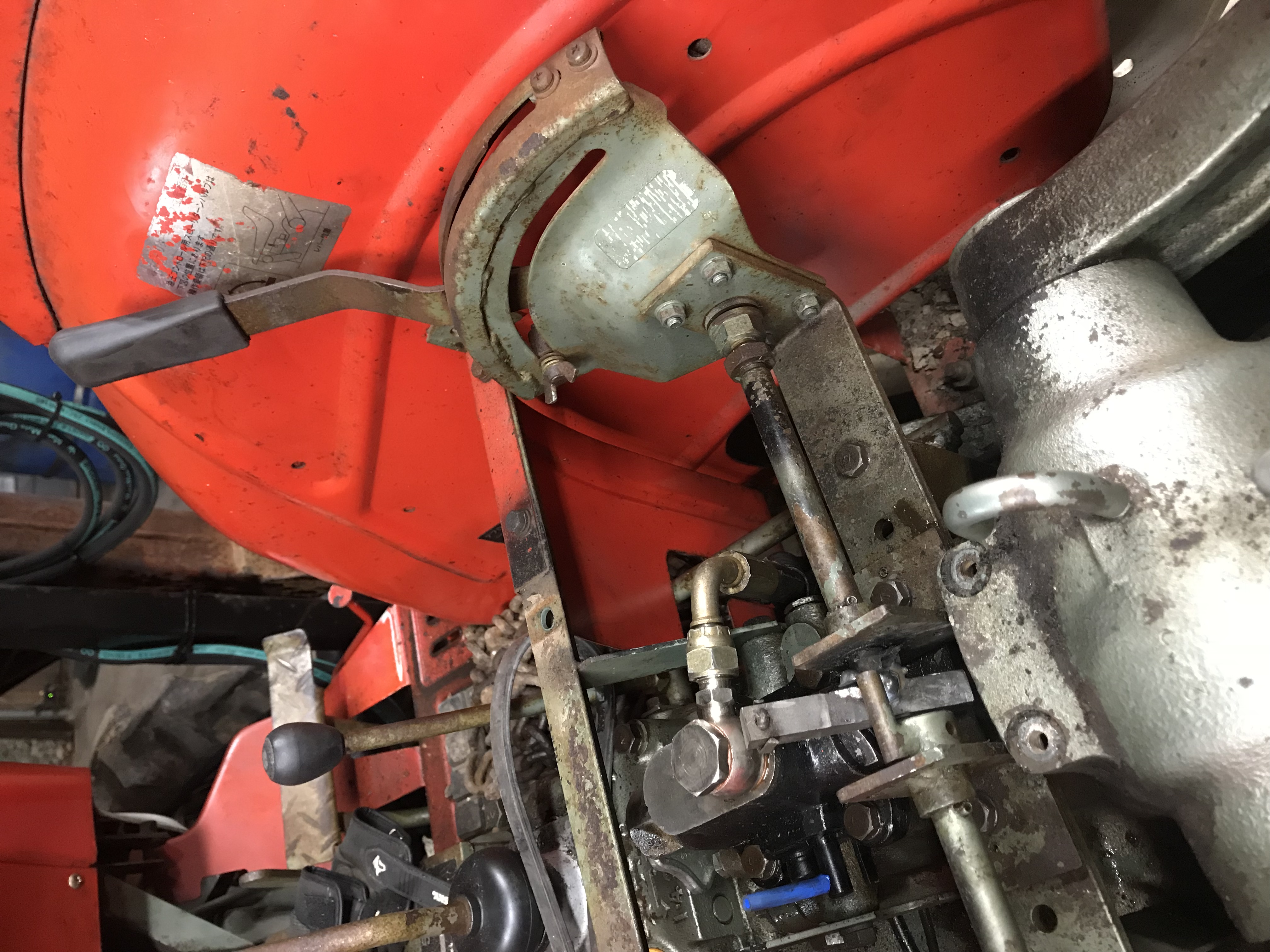

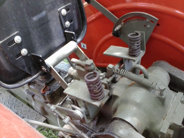

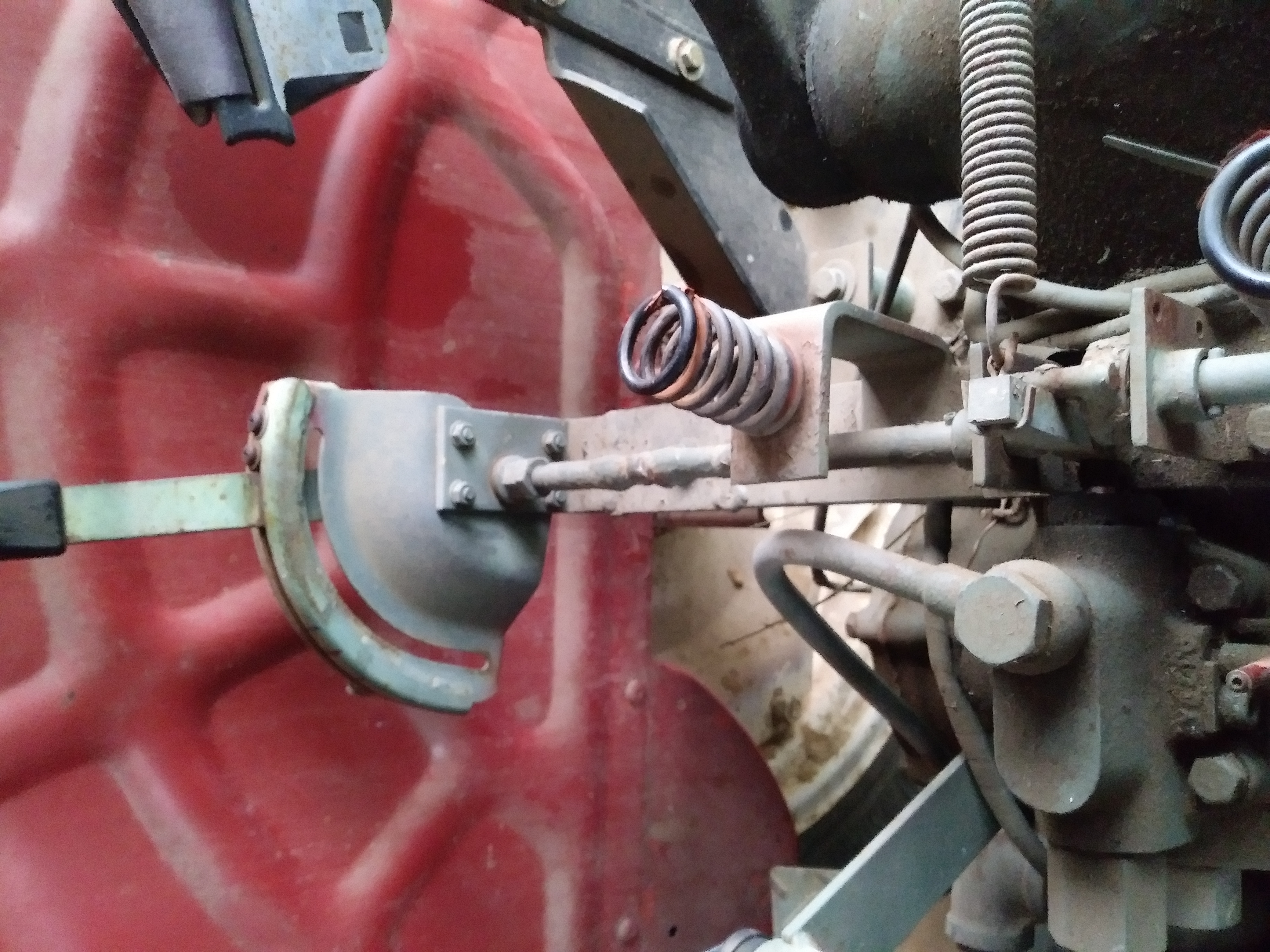

I think I have figured out the problem.
I think the vertical finger that presses on the spool pin is supposed to rotate freely on the pin that it rides on. Since my finger was broken and welded to the control shaft, I think that is causing it to basically be backwards of what it is supposed to be. For instance, in this picture Clemson posted, and Ken’s nearly identical, thier arms are down, the lever is forward, and the finger is back.
On mine, lever is forward, arms are down, but the finger is forward.
Please excuse the welds and cut, I cut the welds earlier to play with it and tack it back in place in different positions. This is when I came to realize it’s kind of moving backwards.
#97
I hope your onto something now. Sounds like it broke and someone just Wende it where they thought it should be.
Now sounds like you need to call aaron and see what kind of "fingers" or feedback rods or whatever has been hacked on your tractor, that he has laying around in the parts bins.
/ Three point valve broken!!! #98
side note if it helps. If I have my lift raised and I remove that spring holding that small vertical block of steel that presses on the valve pin. The lift arms fall.
With your lever all the way back to have the arms raised.The spring must hold that small block against that valve pin (holding it in) for the lift stay raised

/ Three point valve broken!!! #100
with the lever all the way forward ( lift arms down) the bottom of the small steel block that presses on the valve pin, rolls away from the pin, allowing the pin in the valve to come out lowering the arms. It kind of works in a cam action. Hope I'm making sense lol
