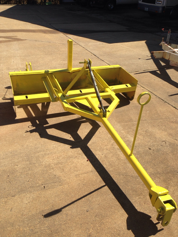

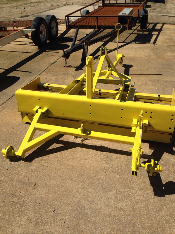

Thank you, it's worked great so far, only thing I'm going to add is a rod on the tilt cylinder so I can set the blade back flat while using it. Thinking of doing a rod with a bent notch like on most loaders.

I thought I replied to the videos but I guess I didn't. Looks like it is working good. It looked like the hydraulics works very fast. I hope it isn't to fast to make those fine adjustments. Great work on your project!

We know all about proper hydraulic speed don't we George. Restrictor fittings can be added if needed.

yeah it can be a bear if they work to fast or too slow either one. I've had a little of both.

I had a 3 point backhoe that used a washer with a small hole in it, to slow down the swing speed. The outside diameter of the washer was slightly smaller than the ID of the coupler that screwed onto the hose for the swing cylinder.
So anyone can make their own flow restrictor . :thumbsup:
